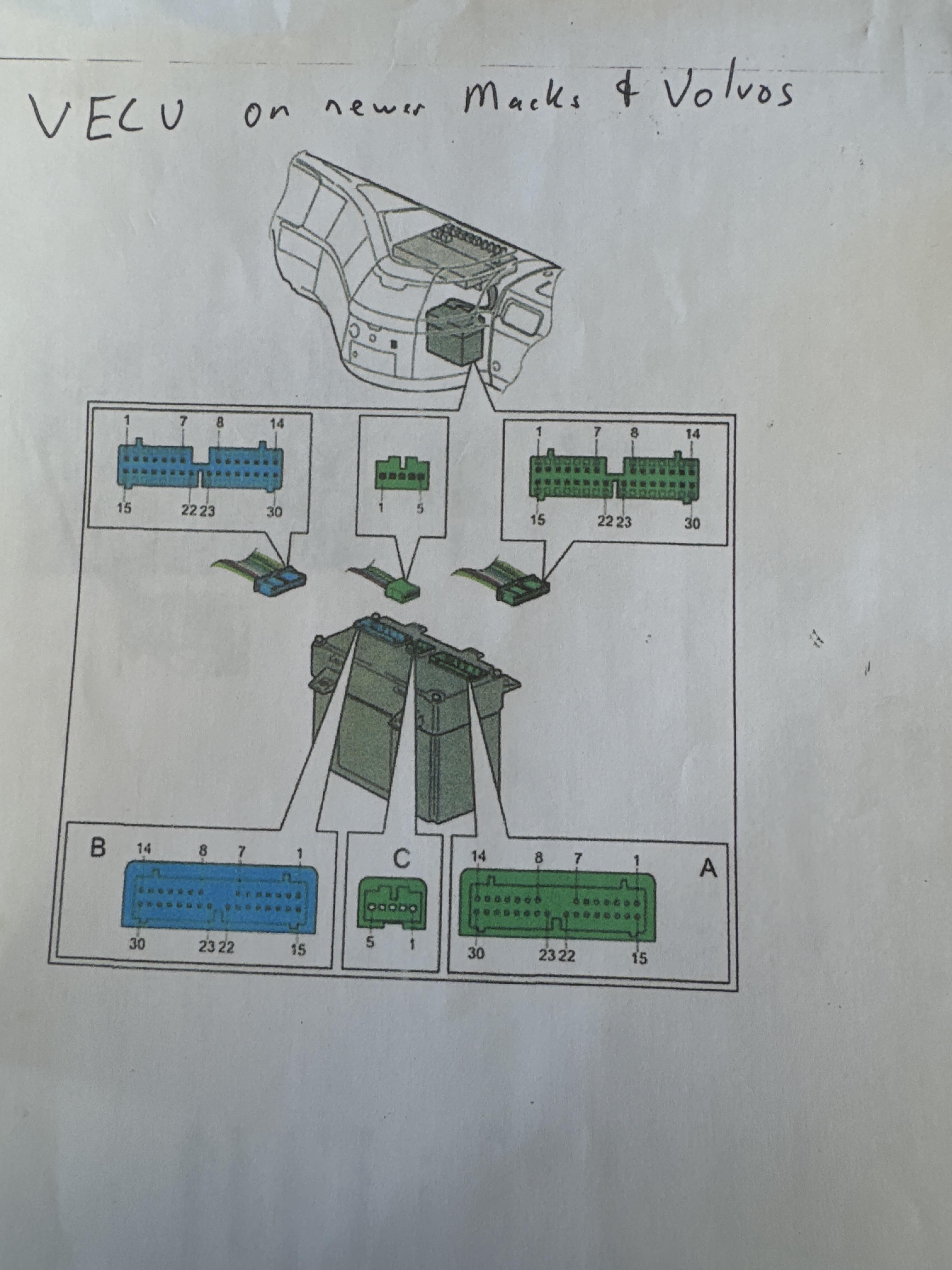

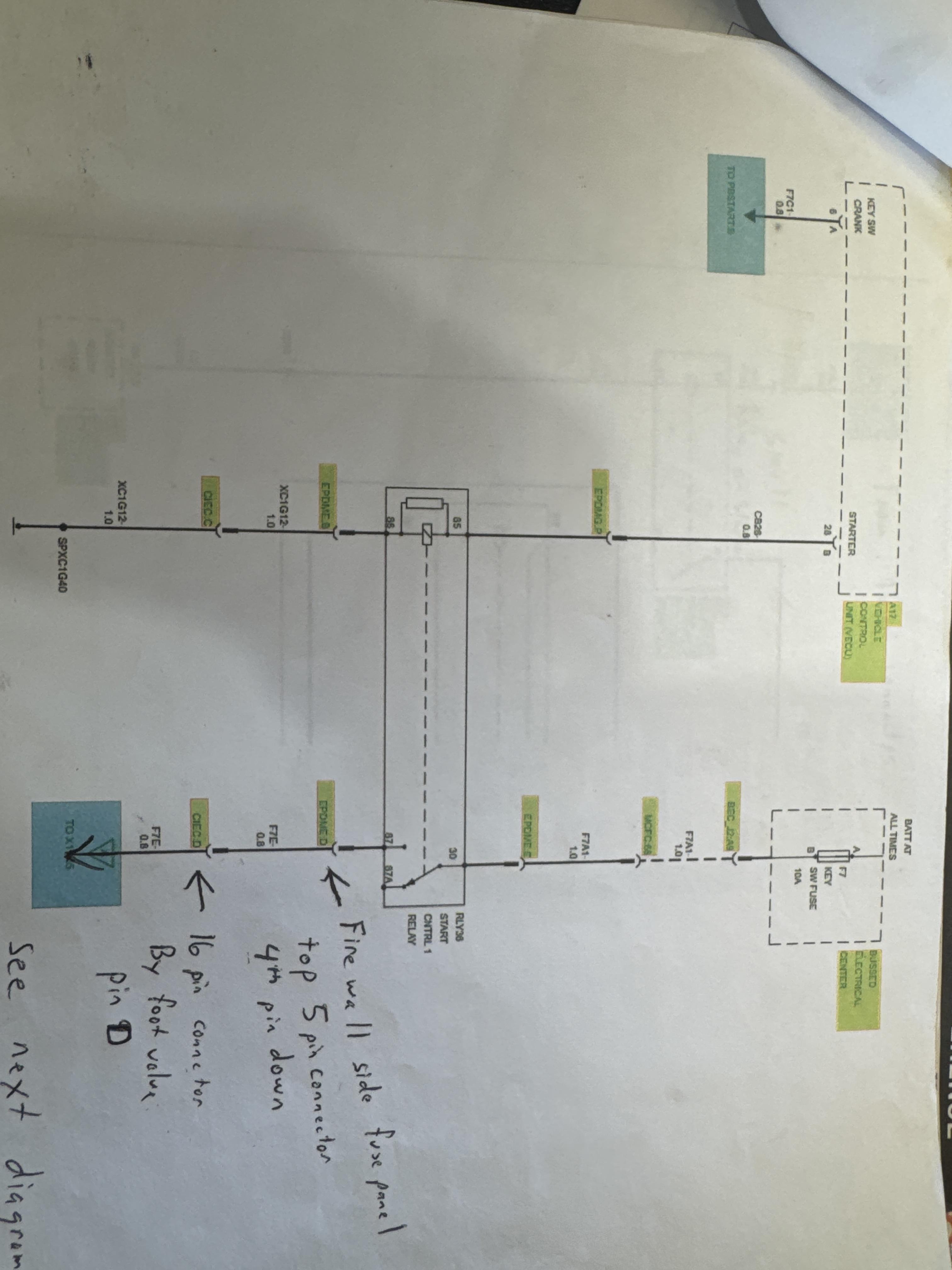

Power to Pin 85 comes from the VECU Vehicle control unit . The key switch in the start position sends 12 volts to pin A6 of the VECU, then if everything looks good to the VECU it sends 12 volts out pin B28 to the start relay pin 85
