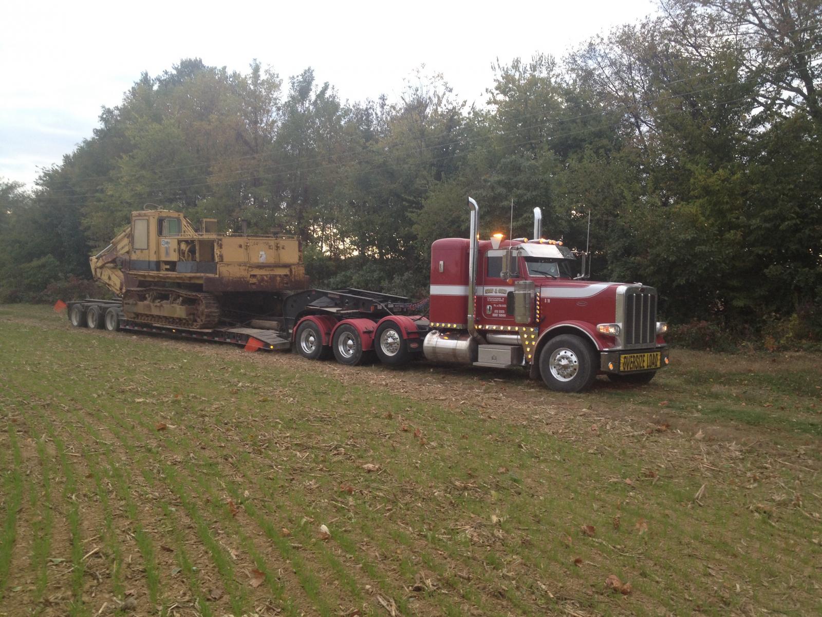

  1. First pic is minimizer. I'll have to take good pic of truck with fleet engineer for you
  2. I have used them on a few tandem trucks and they are good fenders. I don't know what color you want but I ordered red and definetly not happy with the 2 month wait to get red. So I started getting minimizer fenders with fleet engineer brackets
