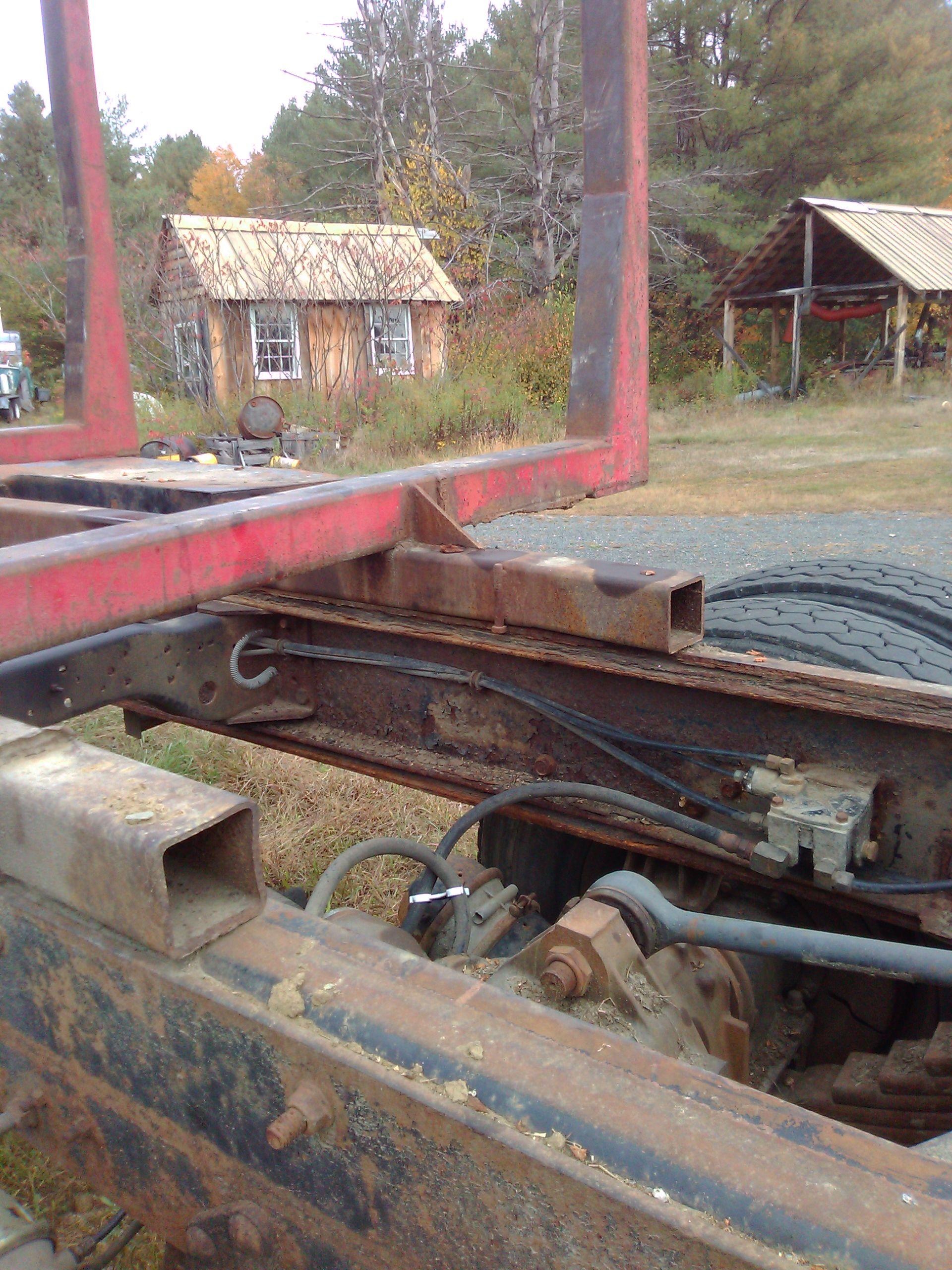

  1. No, right where the nickel is is only a double frame. Before I bought it there was a plate 6-8' long put on the outside of each frame rail that is the bolt heads you see. The end of the trunnion stand can just be seen in the bottom right of the photo.

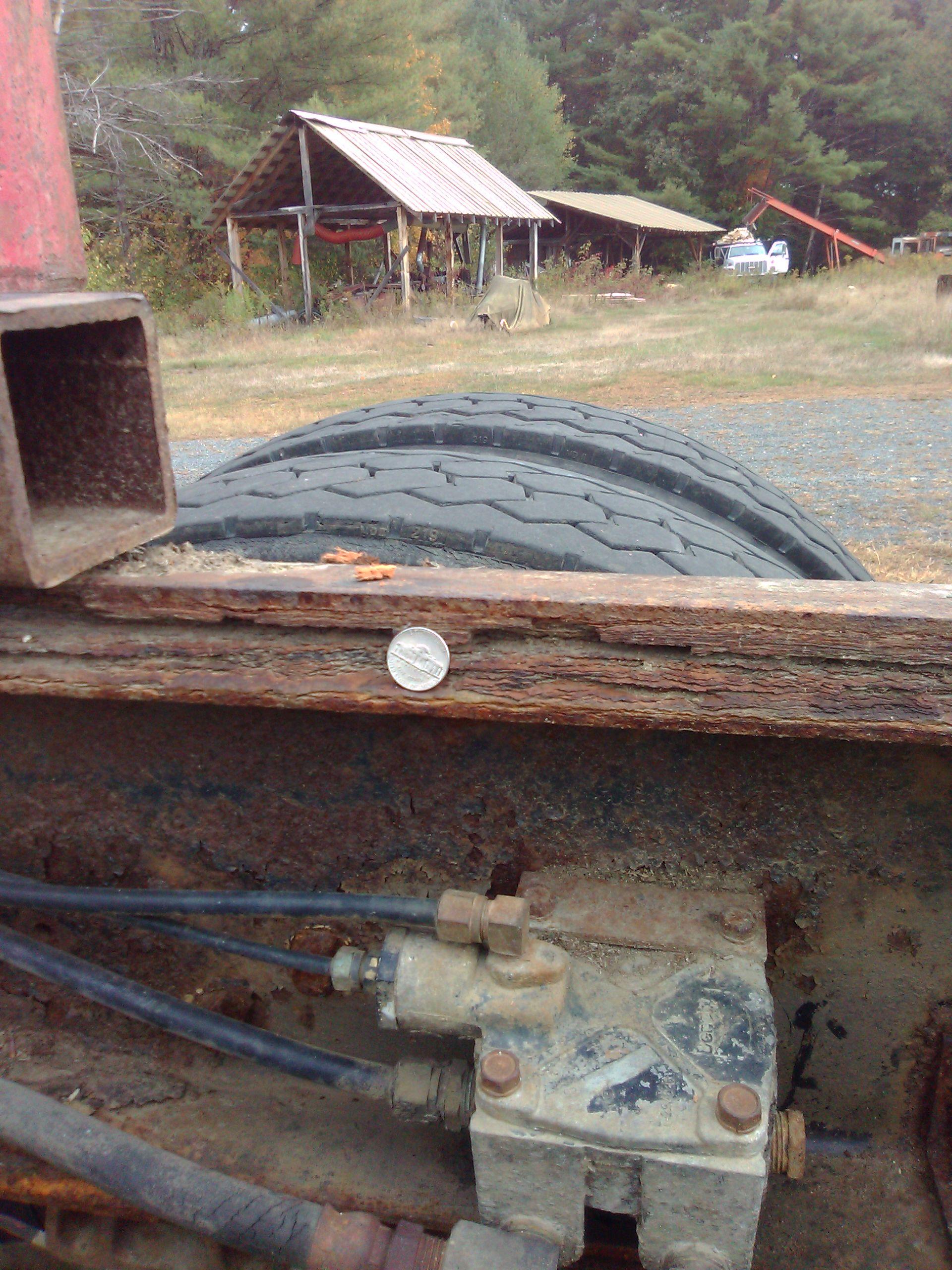

  2. Here's a picture. That's a nickel where the frame has been spread by rust so it's pretty bad.
  3. I can't imagine that the frame would ever break but the inspection station said that the DMV is cracking down on things like frame spread. I'll try to post some pictures tomorrow. I am exploring options at this time.
  4. I was just told that the double frame on my '86 DM688S is rusted too bad to pass inspection. The truck is a log truck so the middle of the frame near the loader has been oiled by leaks from the loader and looks like new but the area from just in front of the axles to behind the axles is spread by rust pretty badly. I'm figuring that my best bet is to look for another truck to put my loader and bunks on however there are plenty of shorter trucks like dump trucks but not many as long as is needed for a log truck. I know that trucks are stretched and shortened all the time so the know how and frame material is out there, but is it practical to either replace the frame from the middle to the rear or graft in the rear half of another truck? The truck is shabby but the drivetrain and suspension etc seems pretty solid. Thanks for any advice.
