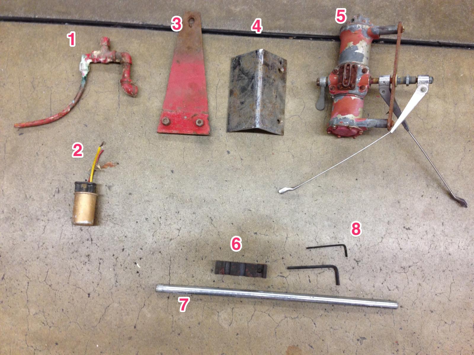

  20. Thanks guys. Flasher sounds right and yes open cab so double sided wipers make sense.

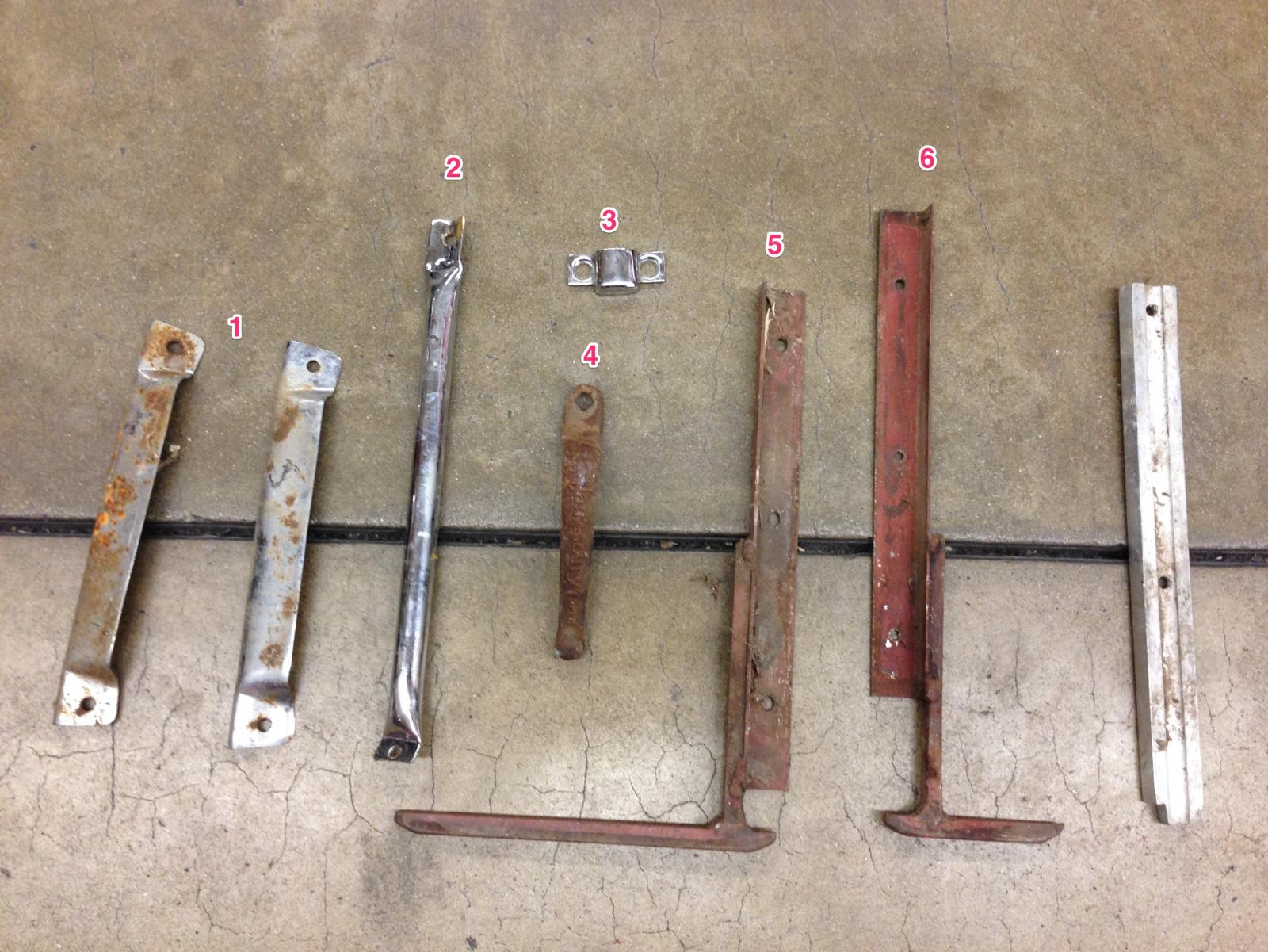

  21. I dug out some items from the compartments of our '52 125LS that I could use some help identifying. I appreciate any assistance. Thanks in advance! Dom Item 1 of picture 1- ??? Item 2 of picture 1- ??? Item 3 of picture 1- is a hood retainer (now installed). Item 4 of picture 1- looks like a valve handle. Item 5 of picture 1- ??? Item 6 of picture 1- ??? Item 7 of picture 1- ??? (sorry no number on the pic) Item 1 of picture 2- ??? Item 2 of picture 2- flasher. Item 3 of picture 2- ??? Item 4 of picture 2- ??? Item 5 of picture 2- double sided windshield wiper motor. Item 6 of picture 2- ??? Item 7 of picture 2- ??? Item 8 of picture 2- are just allen wrenches.
