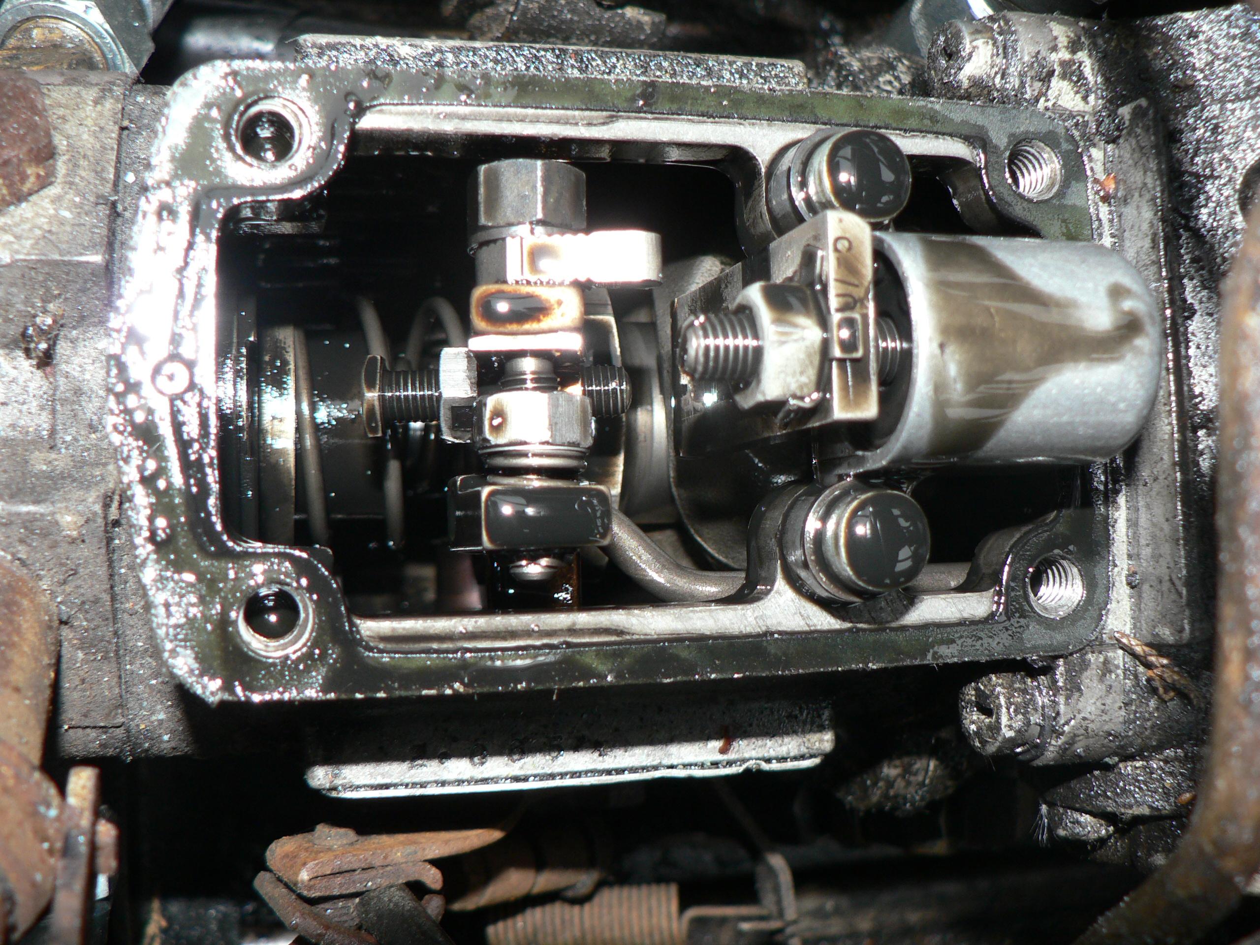

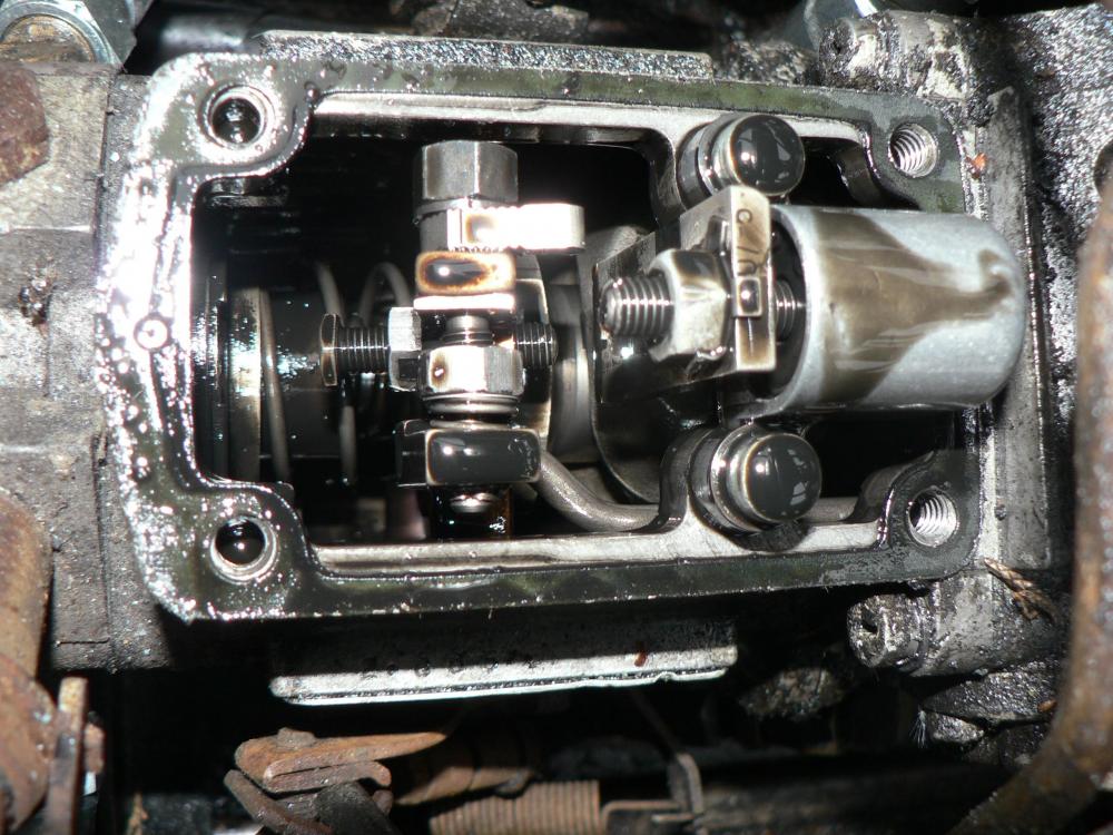

  3. Hello to all, Update on trying to improve on low engine power output on 1970 R719 ENDT864 V8. Thanks for the many replies and suggestions. So far; New filters, fuel lines and fresh diesel. As advised, I've adjusted the pump stud by 1/4 turn clockwise (screwed 'in'), but no change. **Even after reading manual, I'm really not quite sure what this 'stud' adjustment does (see image) - any advice ? ** Fuel pump readings (no load) are from 15psi @ 600rpm to 31psi @ 2000rpm. Might go back to basic checks such as re-torque head nuts (weak point) rechecking cylinder compressions, valve clearances and injector spray. Plus check fuel pressure 'under load'. Other comments welcomed. Thanks Phil
  4. Hello Larry, Thanks for comment. In answer to your suggestion, "No", I do believe the linkage is working just fine. But I will double check tomorrow. Ironically I did have an issue with the linkage in that it was 'catching' on one of the exhaust clamps, but that was easily solved by loosening clamp and swivelling round. I am aware that the external 'arm linkage' (which is connected to the throttle rods) on the side of the pump is kinda 'spring loaded' (looks by design) to avoid overstraining said arm when throttle at full stretch. General consensus seems to be that the engine is running too lean (and that the turbos may be a little 'tired', though the lean fuels seems to be the first place to start. Understand I need to slightly adjust the stud (slacken lock nut first) by winding 'in' 1/4 of a turn... See image enclosed. Thanks Phil

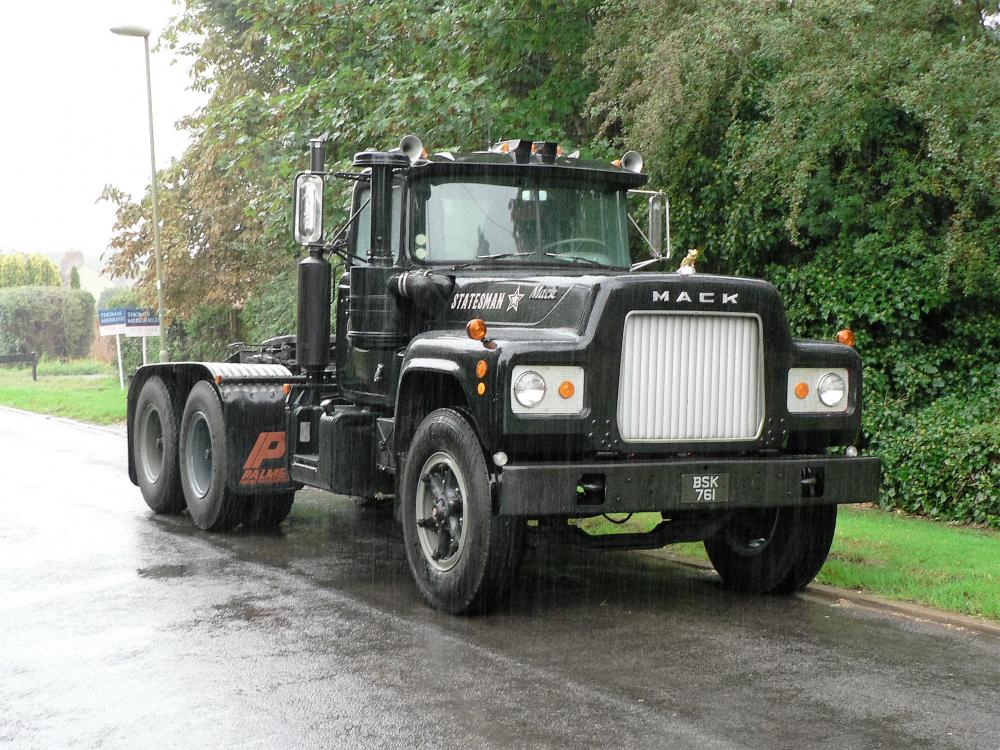

  5. Rob,
    Many thanks for your comments.  All most helpfull along with other replies from BMT posters on this subject.
    Sure seems to be zooming in on a fuel (too lean) issue.  Will be checking that out. Engine does not smoke at all when warmed up - indeed when taking for the annual VOSA test* over here, it passes any emmisions checks no problem.
    *I have to take this 1970 Mack R719 for the same annual 'test' as, say, a 2018 Volvo / Scania / Merc / Daf, which include brake tests with a loaded trailer etc....It generally passes....
    BTW - seems that not many ENDT864 engines built for trucks. And the company who originally bought the truck I have (Campanella Corp of Rhode Island seemed to have had similar problems as those you made mention of. I assume no connection with them as you are too far away (too many miles and to the West of Rhodes Island ?)
    Thanks
    Phil

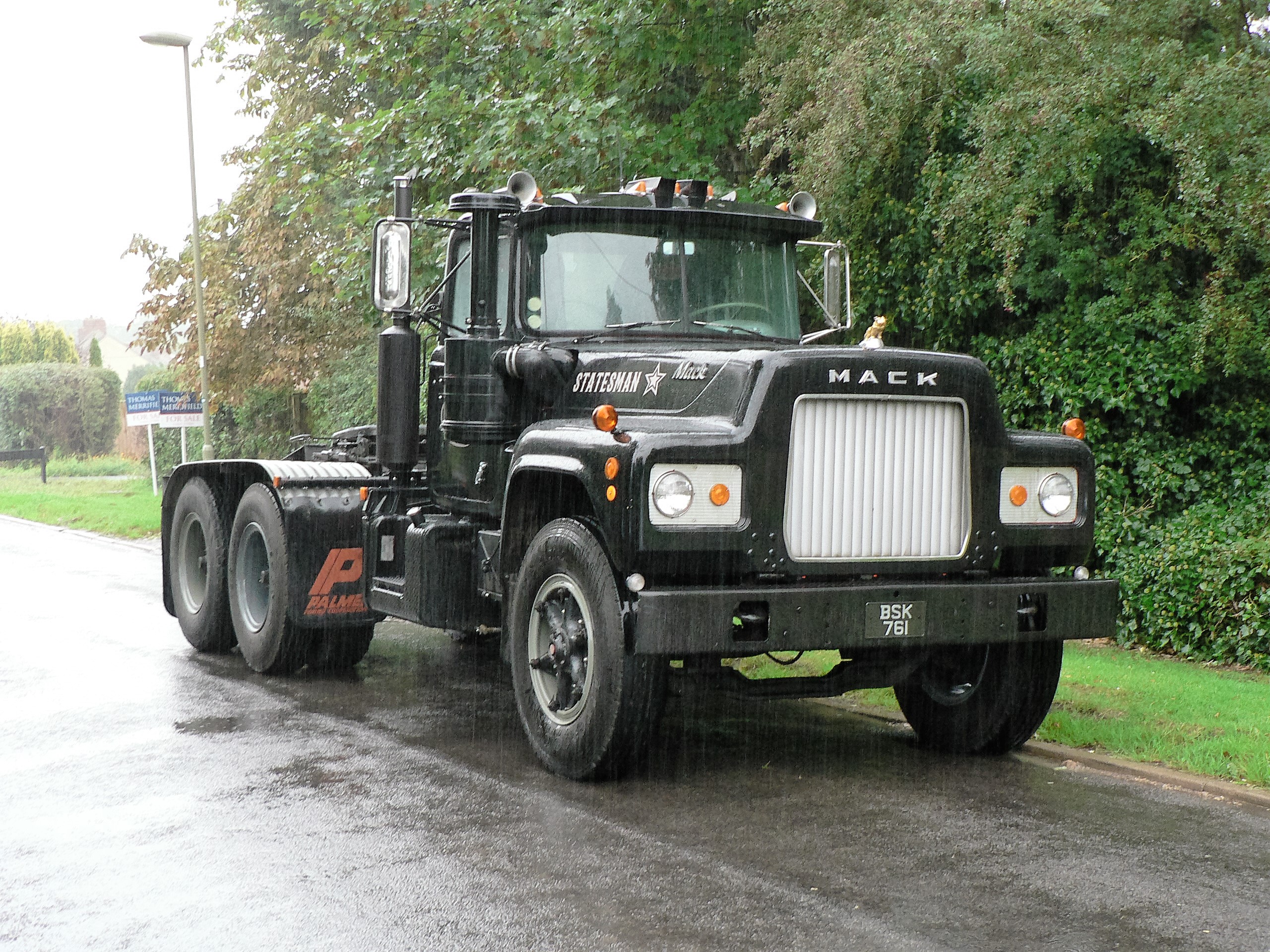

  6. Hello, Wonder if anyone out there can offer any views / comments on my 'problem' ? I have a 1970 R719 with the ENDT864 twin turbo V8 fitted, all pretty original. Understand that engine should deliver around 300hp, but was not Macks finest and had 'issues'... My Problem: Thought not used for everyday haulage (just shows), if I pull a ballasted 20' container (32 tons), I struggle to get much 'get up and go' over 35mph. As if the 300 hp is just not there. On a slight downhill road, it can (and will) do 50 mph. But a slight incline, not really. Compression fine. Injectors fine (clean exhaust), fresh diesel, filters and replaced fuel lines. Fuel pump pressure as per Mack manual. Checking the Turbo boost pressures (no gauges fitted, but have added aftermarket to be able to check) only give (under load pulling 32 ton) Mack Max RPM = 2300 1600rpm – 1800rpm = 2 to 4 psi. Best PSI reading is just about 5psi when accelerating up to 2000rpm. Am I expecting too much in the way of 'performance' from a truck of this age / era / horsepower ? Thanks Phil

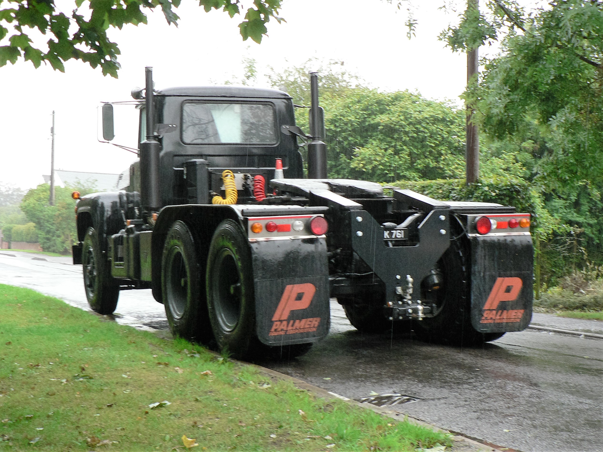

  10. Hello, Phil Bennett here from Oxford, England. R719LS - I have Chassis Number 1260. All working fine. Interested in your comment about still having the turbos (?). If you wished to sell them to a good home so I'd have some 'spares' I'd be interested. Appreciate I'm not quite in the country, but I do have a friend in CA who kindly forward ships items for me. (Images shows Mack in Black 'wrapping' as used in a movie recently - normally it's Orange) Thanks

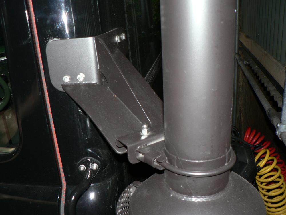

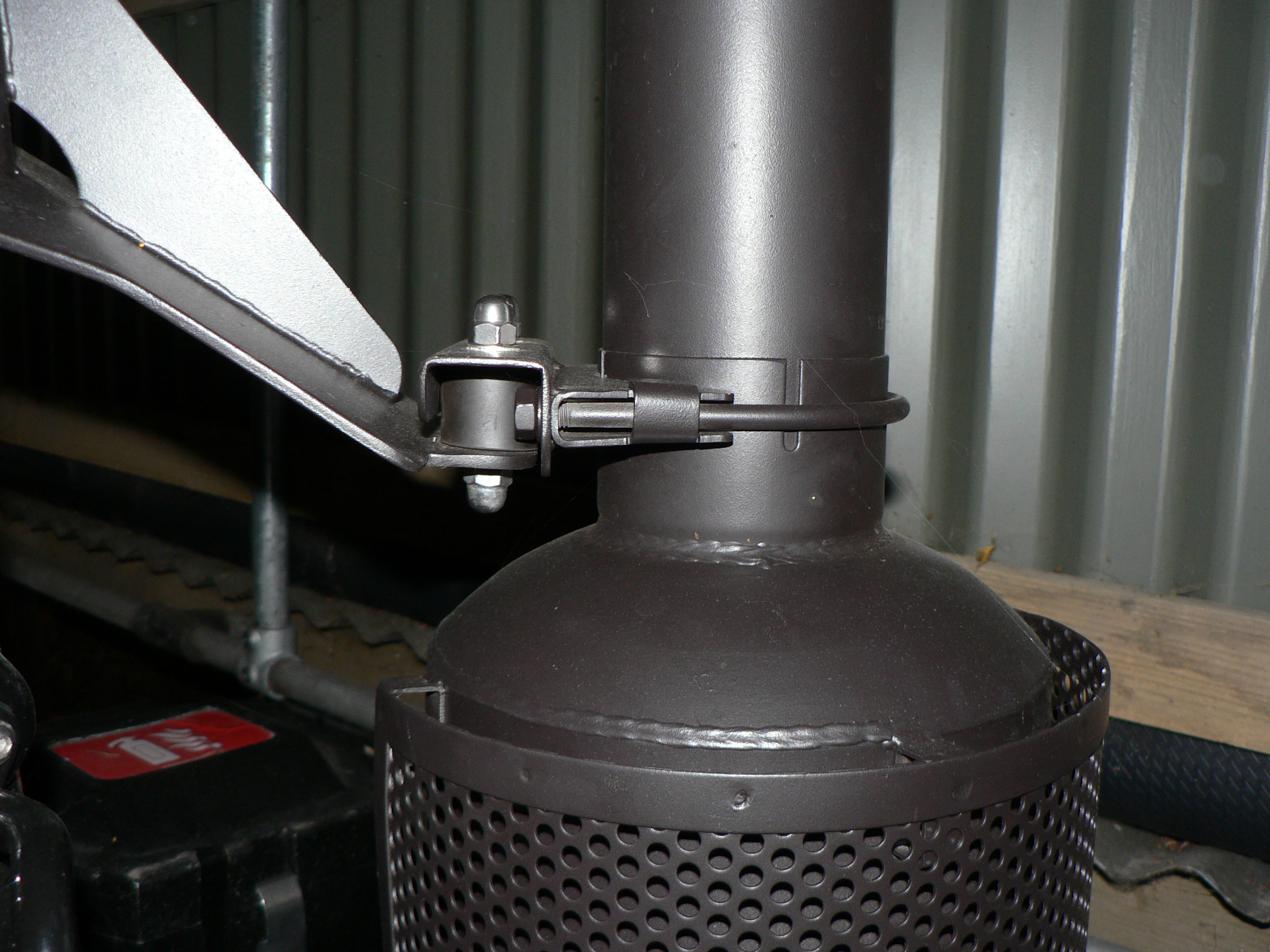

  11. Hello. I've an R719LS with the ENDT864 engine. Those who are familiar with this engine will be aware it is the (not the best, it seems...) Mack V8 with the Twin Turbo set up. When acquired the truck it had (somewhere along the line) been fitted up with a single stack and both turbo outlets run into the one pipe. So, I decided to 'convert' (put back to original ?) the system back to a twin stack setup. 3 1/2" stainless pipe used throughout that I prepared and had welded professionally (Stewart welds pipework for airline refuelling rigs). Also bought some stainless silencers with a heat shield and 'custom made' some stainless brackets to attach top section of silencers to rear of cab using the existing mounting inserts. The whole system was then Powder Coated in a high temperature Axaltacs Matt Black (same stuff as used on flue liners), which has worked out very well. On tick over the engine sounds no different, but once on the move, it does sound quite 'burbbly'... Here are some images for you to see result. Er, well there would be if the 'system' allowed me... Contact me if anyone wants more info / images. Phil
