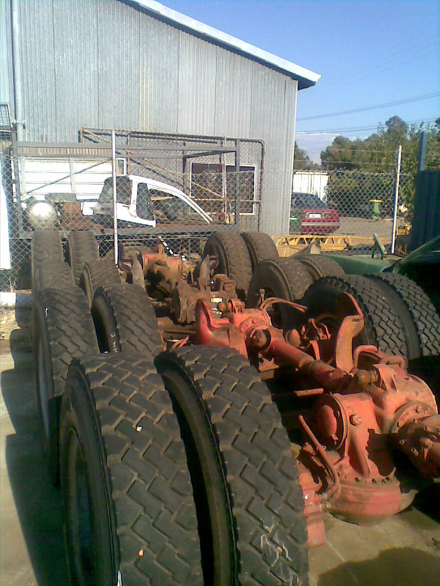

Hi, ive known it as the crows foot mounting, the 69 flintstone has it and the 75 FR700 i wrecked had it, see pic. and the 76 R600 water truck I scrapped had it also.
its beeter than the other system i have been told.
Grant
Grant
Grant,
Is the pic of the ones out of the 75 & 76? Are they for sale?
Vance
Grant,
Vance
Hello, the second set in maybe???, there out of the 69 flintstone and are the same as the front set, ratio is 5.32
the front ones are a 5.13, still wrong ratio for what I need, but they will get it going for now.
Grant
