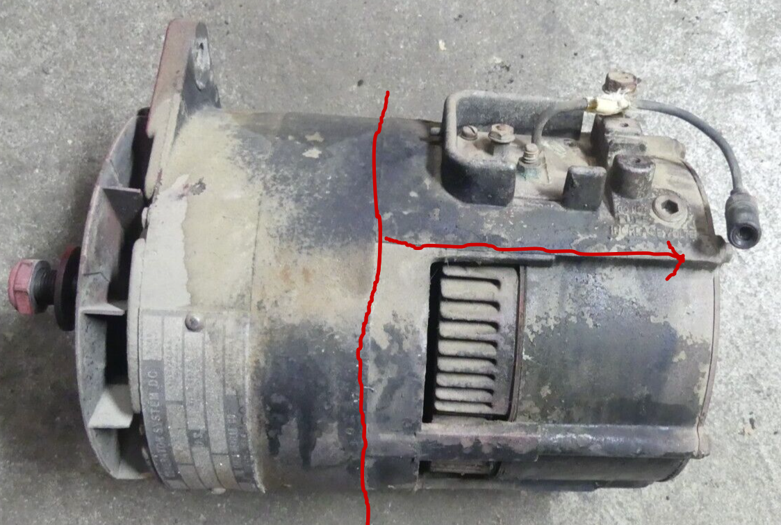

No, that is not where I am going with this. The rear section houses the diodes and I believe would bolt on to these early alternators, providing a pre made update to internal diodes, as well as the ducting required to cool them.
 Both these old alternators and the military units, use the screw in staggered brush holder that are outboard of the rear bearing, like modern Prestolite units are.
It looks like the rear housing could replace the rear housing on these old units.

It was used on many older Military trucks.
If you un bolt and separate at stator (red vertical line) I believe you could remove the rear case on the  Alternator in question, and bolt the rear case containing the diodes (and regulator, but you wouldn't need to use the reg) in place of the original rear case.
I just can find a "dead one" at a reasonable price to try it.
Edited by Geoff Weeks

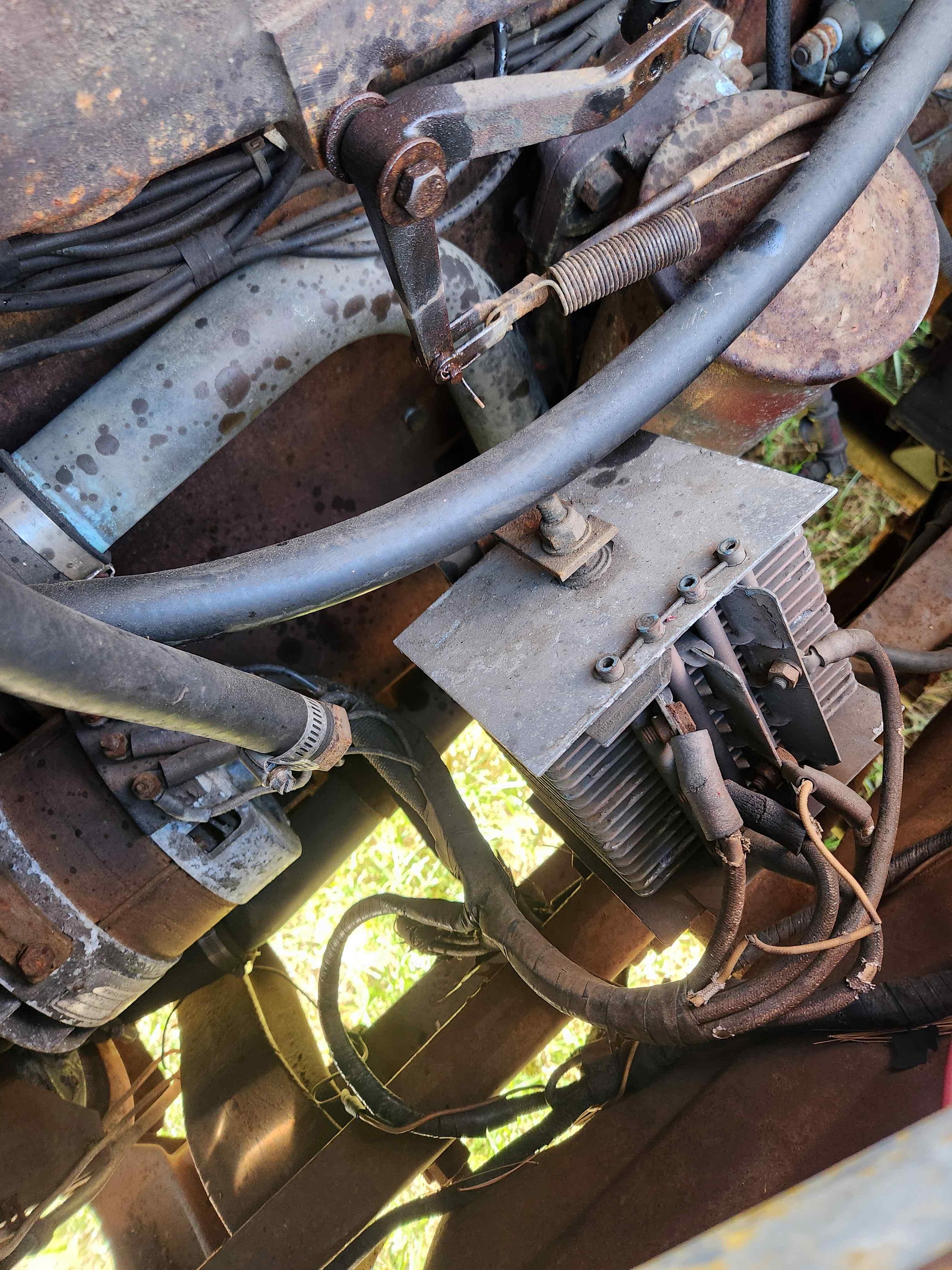

Figured out where the regulator was, thanks to a post in 2023 that Geoff was helping Angelo.  Saw the picture of Angelo's 7v unit and we have a similar Leece Neville 14v box on the inner driver's side firewall.  Yet another thing to trace wires to-from.   And, yes I know we need to get up close and personal to the alternator to figure out the output leads.  If you look at the picture of our system (below),  you can see the smaller wire going to the alternator, so I assume one of them is the field.  You can't see that there is another small one on there too.

Three heavy wires are output three phase A/C. the two light ones are field connections. You can use either an "A" circuit or "B" circuit regulator by either connecting one to ground and regulating the hot side of the field or connecting one to the DC output and regulating the ground side of the field.

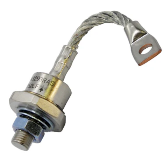

You can probably find the diodes and heat sink you need in an old electric forklift charger. The PIV of the diodes should way more than enough and the amperage should be enough, but I'd check
Or these  https://www.ebay.com/itm/114601767481  (2 for single phase, 3 for 3-phase.)  mounted on a heat sink.  100 amps / 800v
EDIT:  Pin one = inputs,  pin 2 is Neg and if modules are mounted side by side, could use bus-bar to tie them together, and same with POS  pin 3.

37 minutes ago, Joseph Cummings said:
I was thinking forklift charger because they are this type. Easy to mount and rugged
Was looking at those.  Would need regular polarity and reverse polarity diodes ( stud anode and stud cathode). 2 each for single phase (4), and 3 each for 3-phase (6), and would have to isolate the plates the studs are mounted too.
