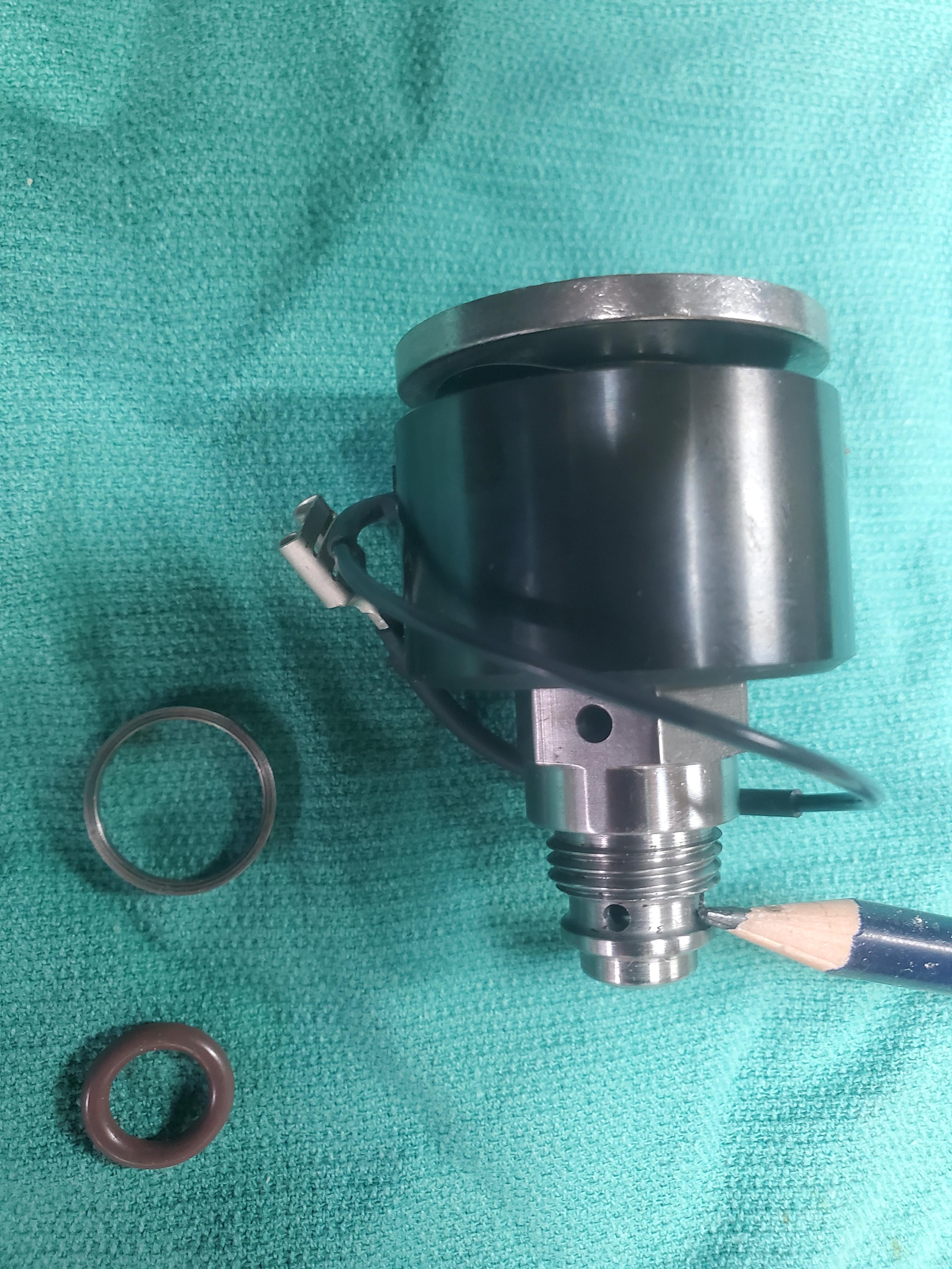

Last year when I had to rebuild a head on my 1979 Mack 675 ENTDB engine I notice that the dynatard solenoid wire was all but broken.  Ordered a new solenoid.  When I removed the old solenoid from the rocker arm I don't remember seeing the steel collar or the "O" ring pictured.  Not saying the weren't there, just don't remember  The small steel collar I believe is a no brainer as to where it goes on the new solenoid.  Question is does the "O" ring just go onto the bottom of the solenoid or the grove that the pencil is pointing to.  My thinking is the bottom of the solenoid.

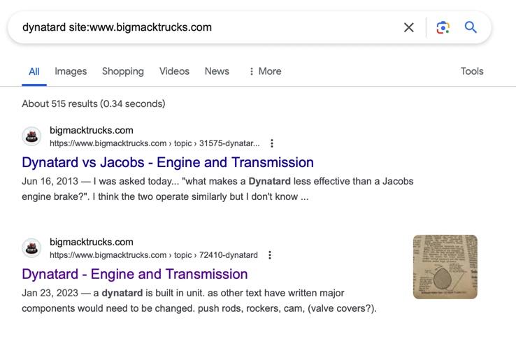

This topic seems to have the best explanation:
WOW  thanks  I will definitely be going thru that.  My search on the site for dynatard engine brake kept coming back "error" try again later.  LOL
I know google has messed up a lot of in-site searches. Its best to search for topics like this:
Someone on here should be able to answer your other two questions

If you haven't got your answer yet" the steel washer goes under solenoid; o-ring I always soaked in oil then set in to rocker and slowly turned solenoid into rocker. electrical source closed solenoid which allowed oil into exhaust ports eliminating valve lash gap holding exhaust valve open. same concept as jake just different housing set up.
That is what I was thinking on the steel washer and "O" ring.  Really disappointed in the "factory" service manual as to alot of things dealing with my truck and engine
