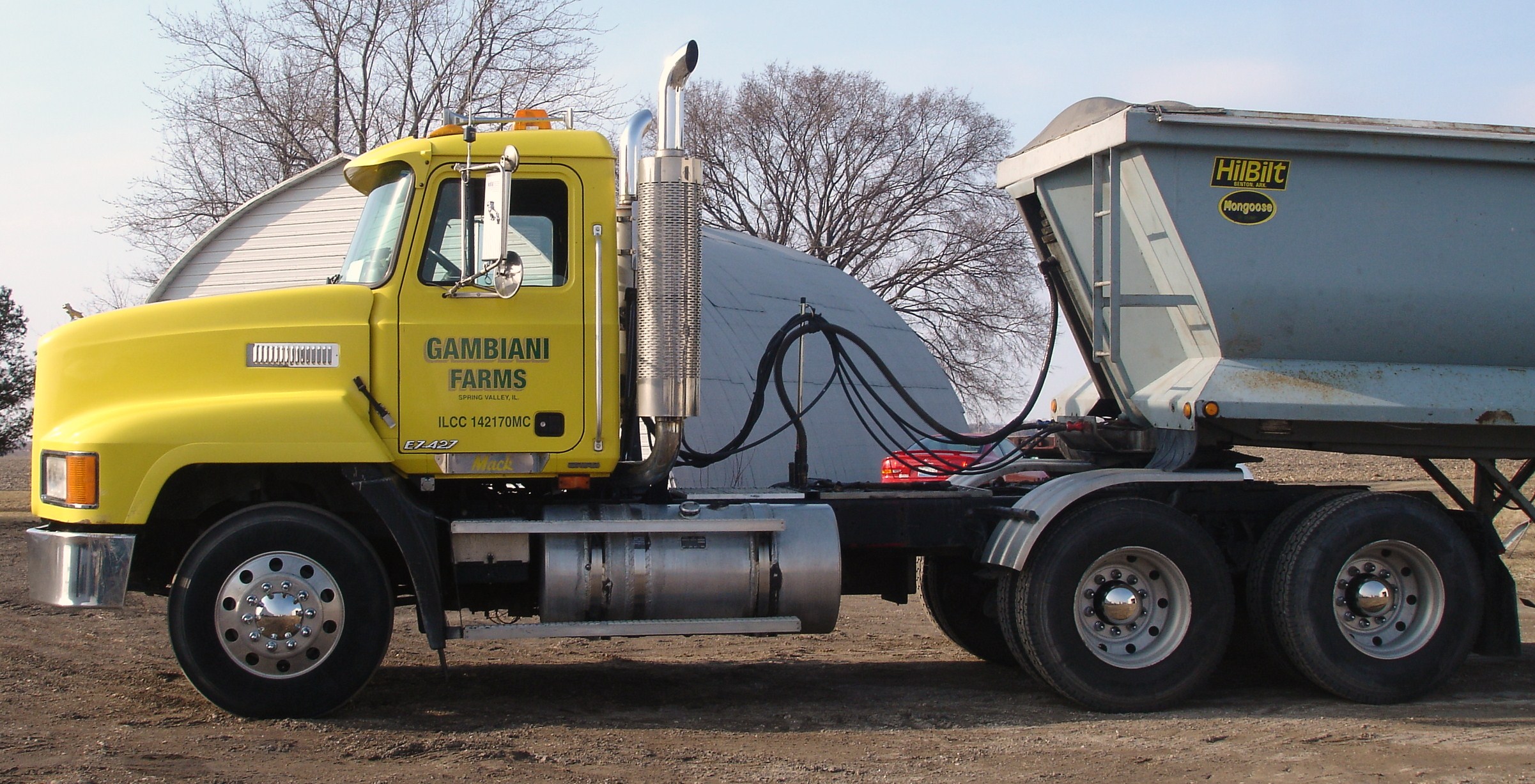

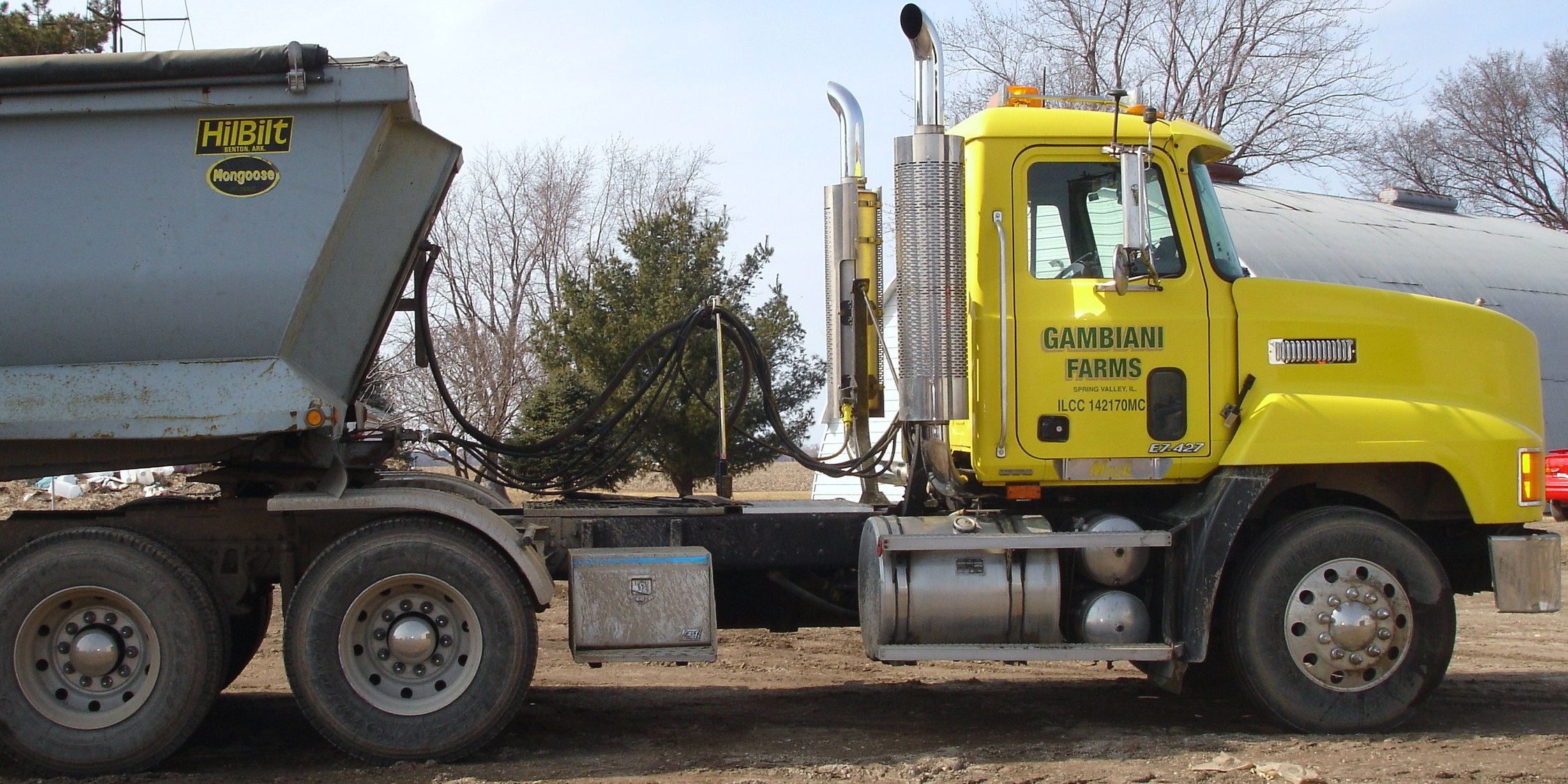

I bought my truck in April '07 for $24,000. It's a 1997 CH 613 and it had 550k miles on it at the time. 427hp, 187" wheelbase, 2 line wet kit, air ride, 18sp, the 'premium' interior, all aluminum wheels, twice pipes and engine brake.
Truck and trailer empty weight, with a full tank of fuel, teeters around 29,000. Gives you a 25 ton load with some room to work with and about a 920 bushel load of corn.
So total investment...truck and frameless trailer was around $50,000. Trailer is a '98, by the way. I'll put a picture of my truck on here if I can figure it out.
