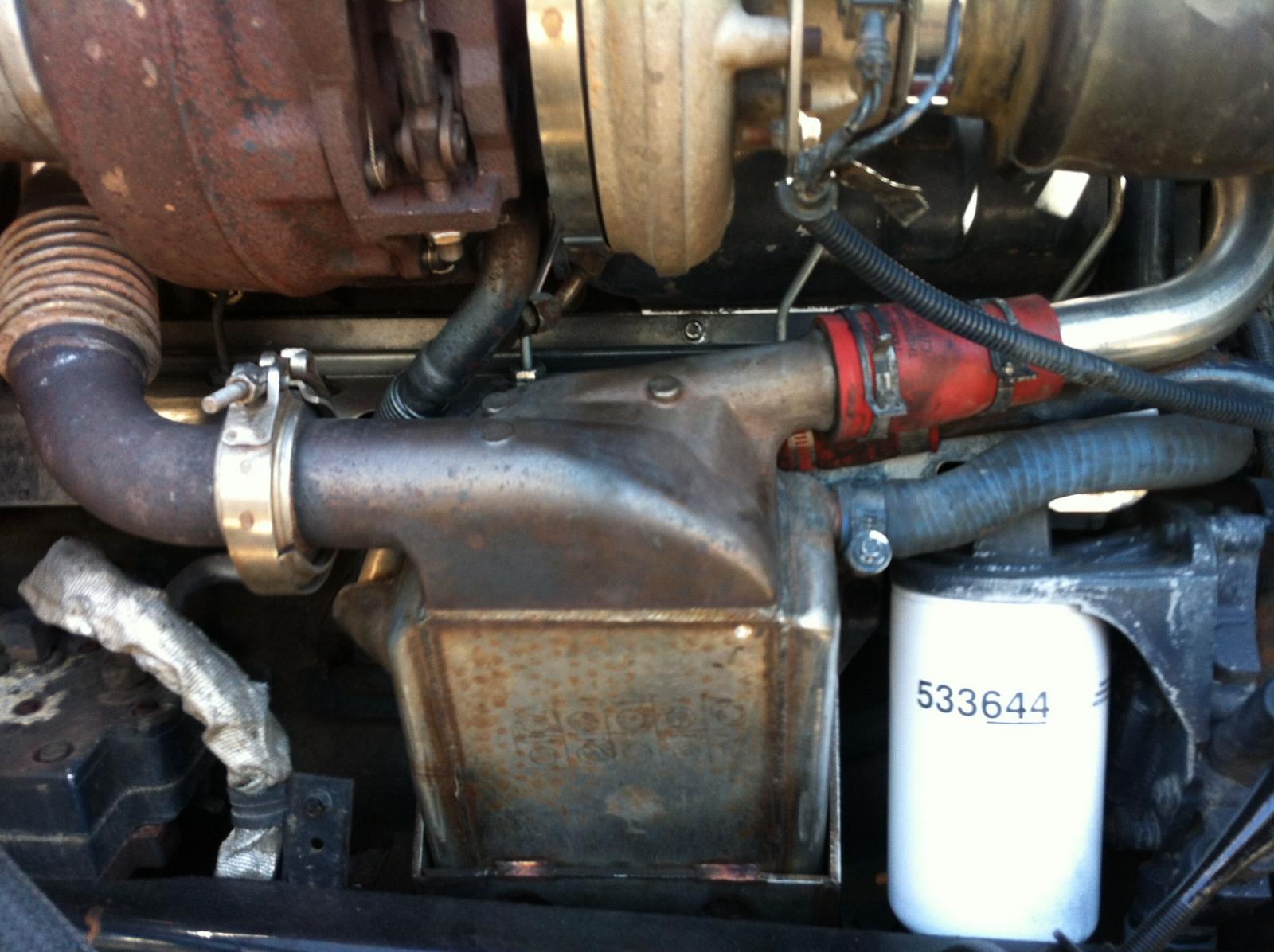

We will try the truck again. The dealer is wanting to start leaning towards the EGR valve. I'm not wanting to keep throwing money at parts replacement guesses, especially when no codes are showing for EGR issues.
EGR valve can be physically checked if removed good or bad if its not bad just reinstall egr will just give you low hp and smoke if not working correctly if egr cooler was leaking coolant into mass flow pipe when egr valve opens it would be blown into intake manifold and cause issues when injector cups leak s coolant on a aset engine it leaks out where the fuel line enters the head not into combustion cylinder . If it was electrical should see some codes like 45 or 95 would do this but no codes so has to be mechnical most likely I did have a altinator on a truck once that had one strand or wire shorting to case giving the ecu a heartattack and it only happened after long hot run with no codes .Thought about speed sensor settings last nite but that info goes to the vehical module that just tell engine ecu to limit power to whatever setting is Still think fuel psi see if dealership will hook up external fuel gauge temperory and let you drive and monitor fuel when this happens .
