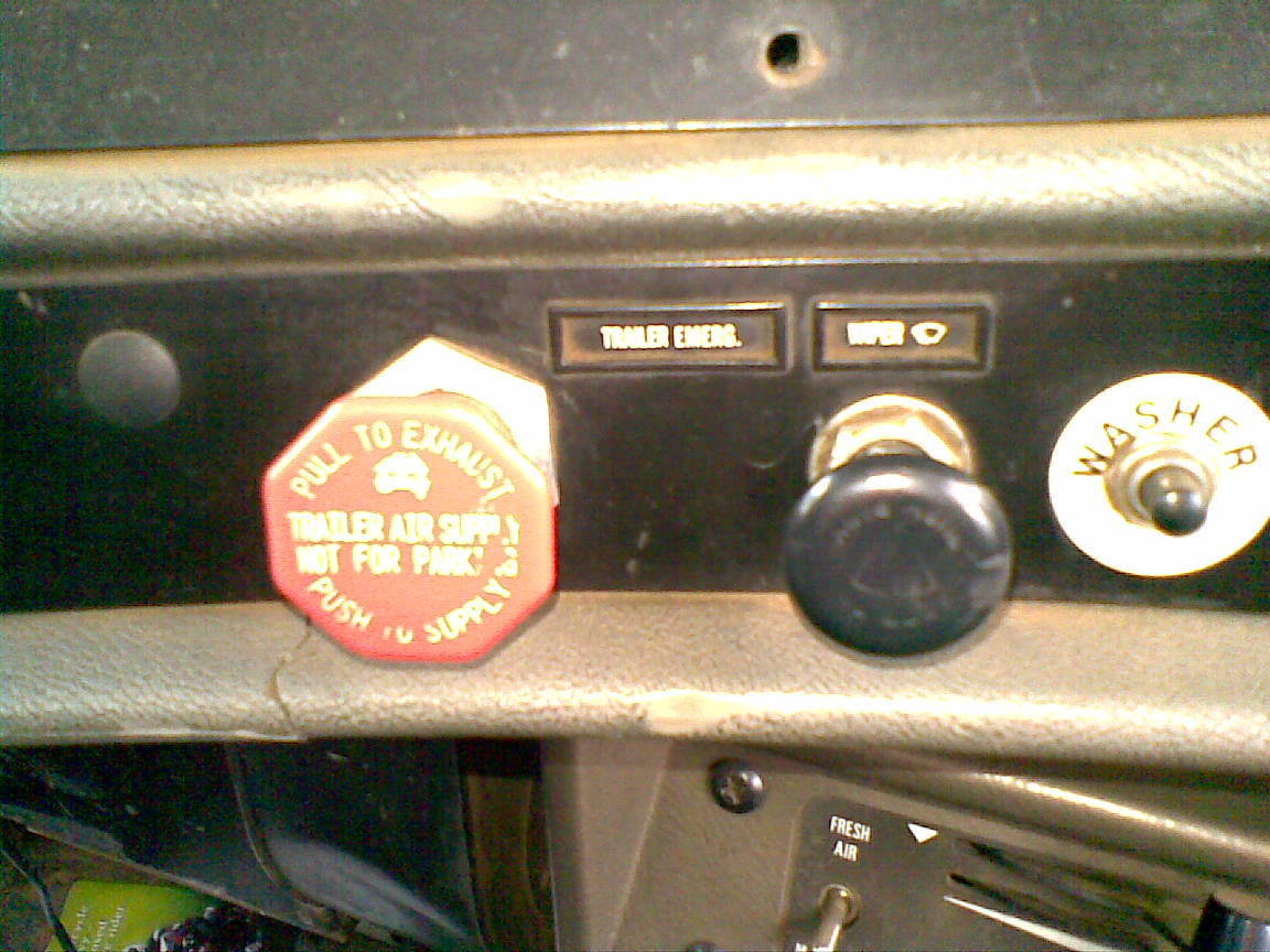

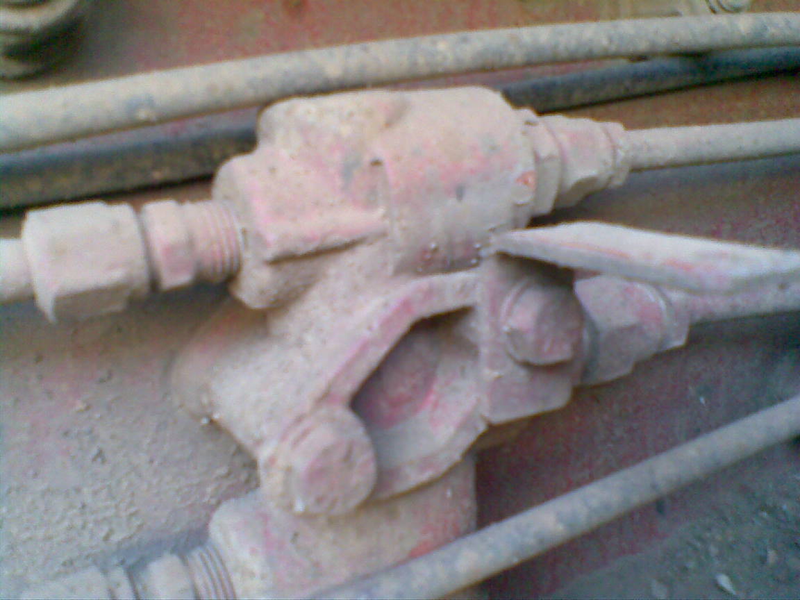

Im guessing you truck is the same as mine so here are some pics of the valve and supply button, i dont know weather all macks are the same but i have to push this in to supply the trailer unlike my old bosses mercedes where there was always air at the duomatic at the rear.post-3922-029875900 1280815043_thumb.jpgpost-3922-099107200 1280815136_thumb.jpg

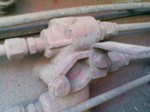

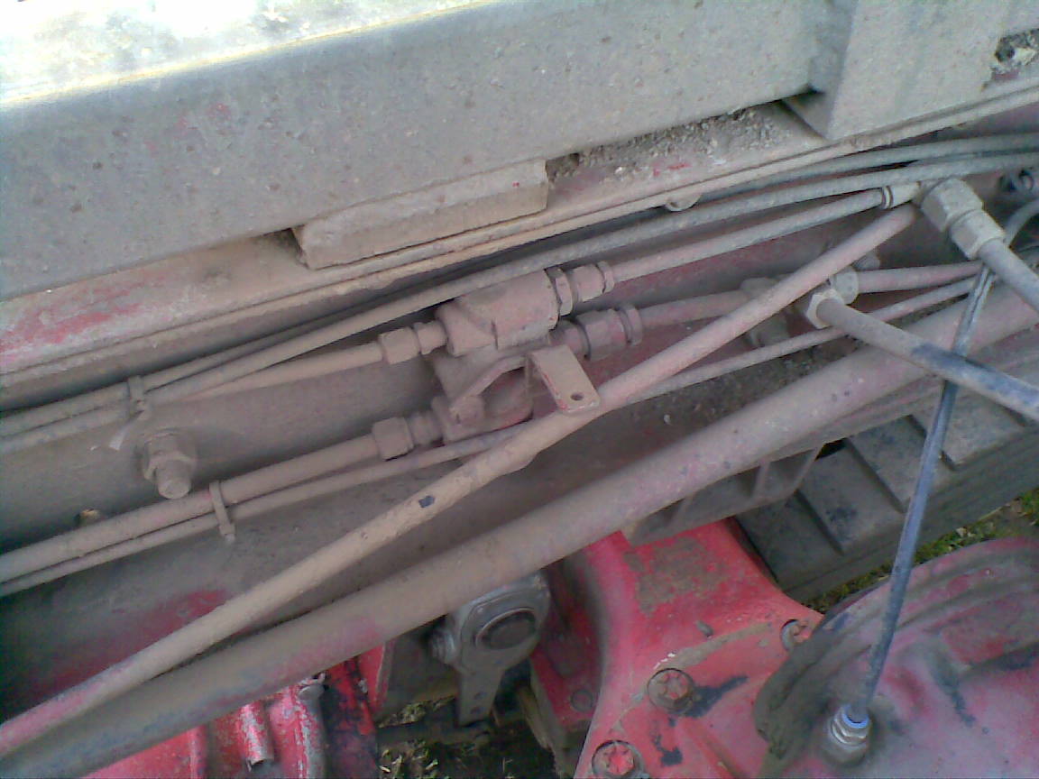

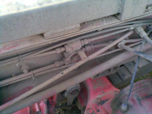

The valve is inside the right hand chassis rail just above the front drive axlepost-3922-051879800 1280864486_thumb.jpg
