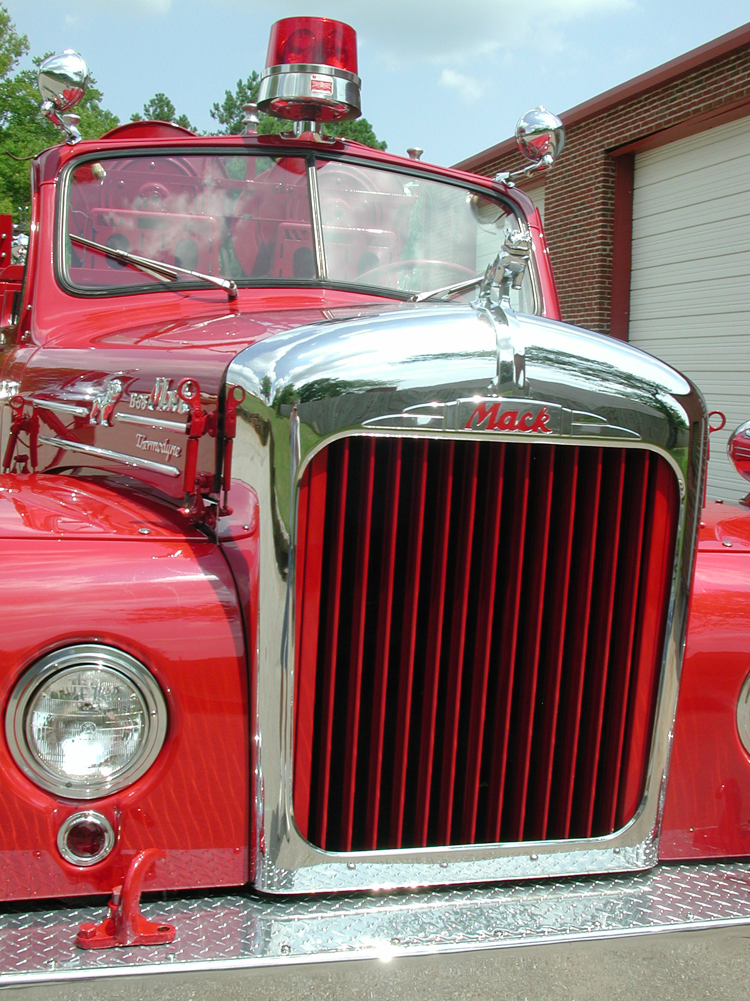

Hi Beachbud,
Very Nice B85 pumper, was it just painted? Where are you located, that would make a nice parade truck or muster truck, it has a lot of options that are unique for 1958, the rear fenders and compartments are different than most of the others from that timeframe, and the hose reels are mounted very high.
Thanks for posting the pictures, it is great to see another good looking B model firetruck!
Firemack
