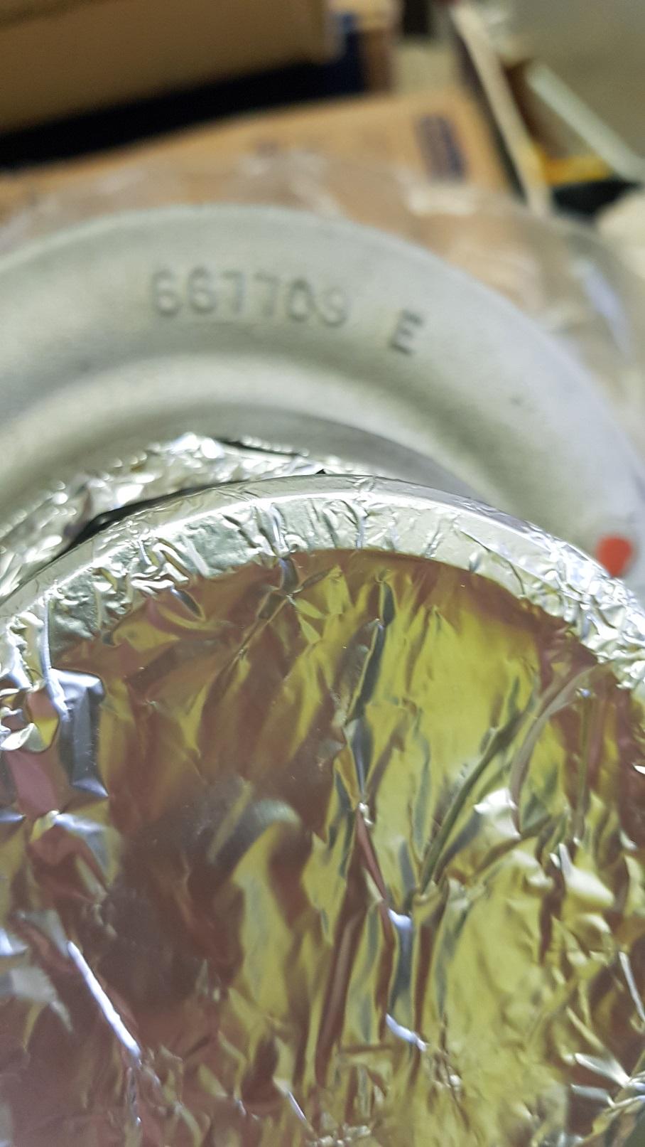

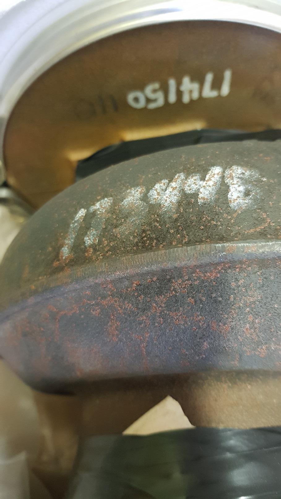

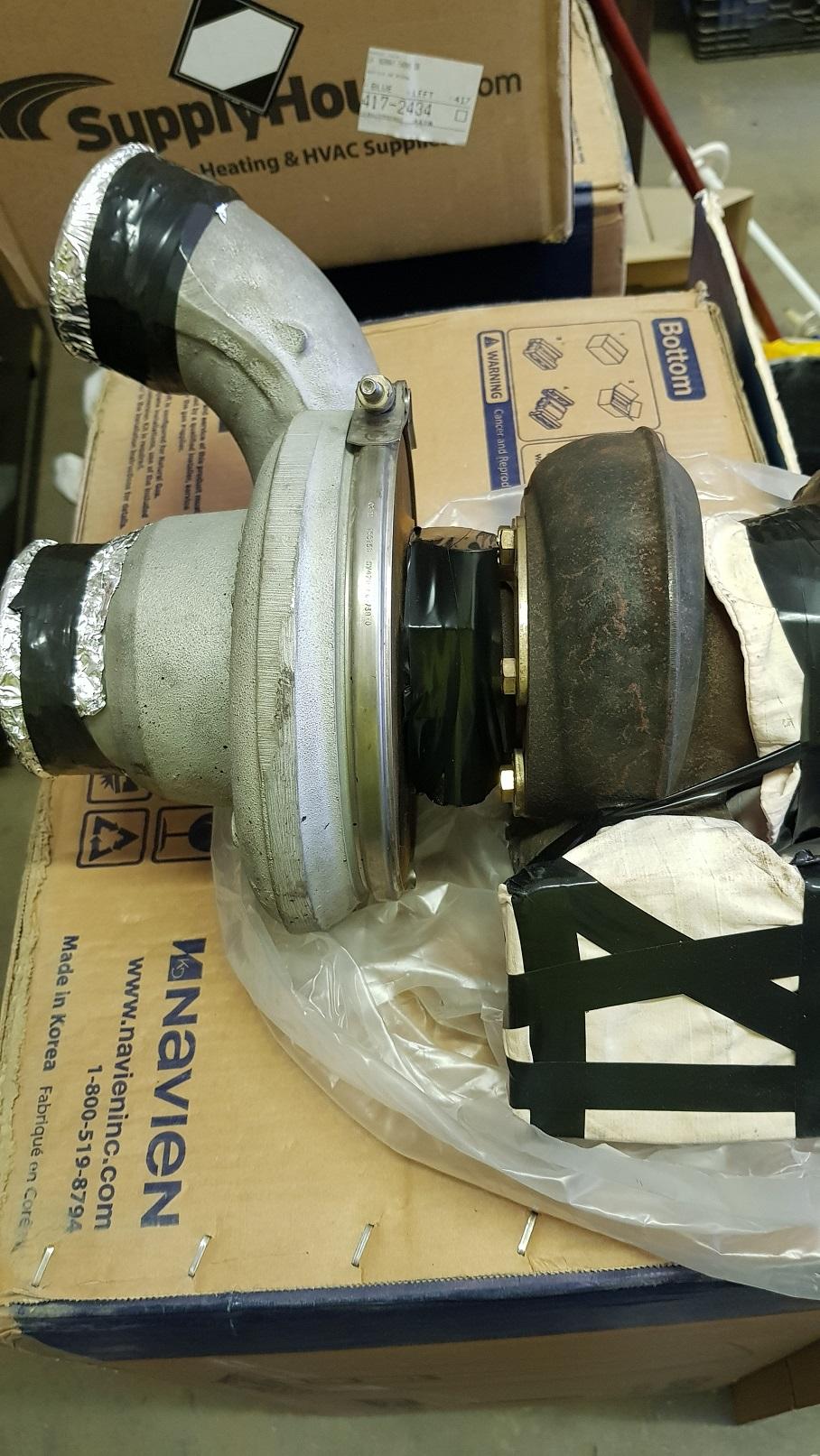

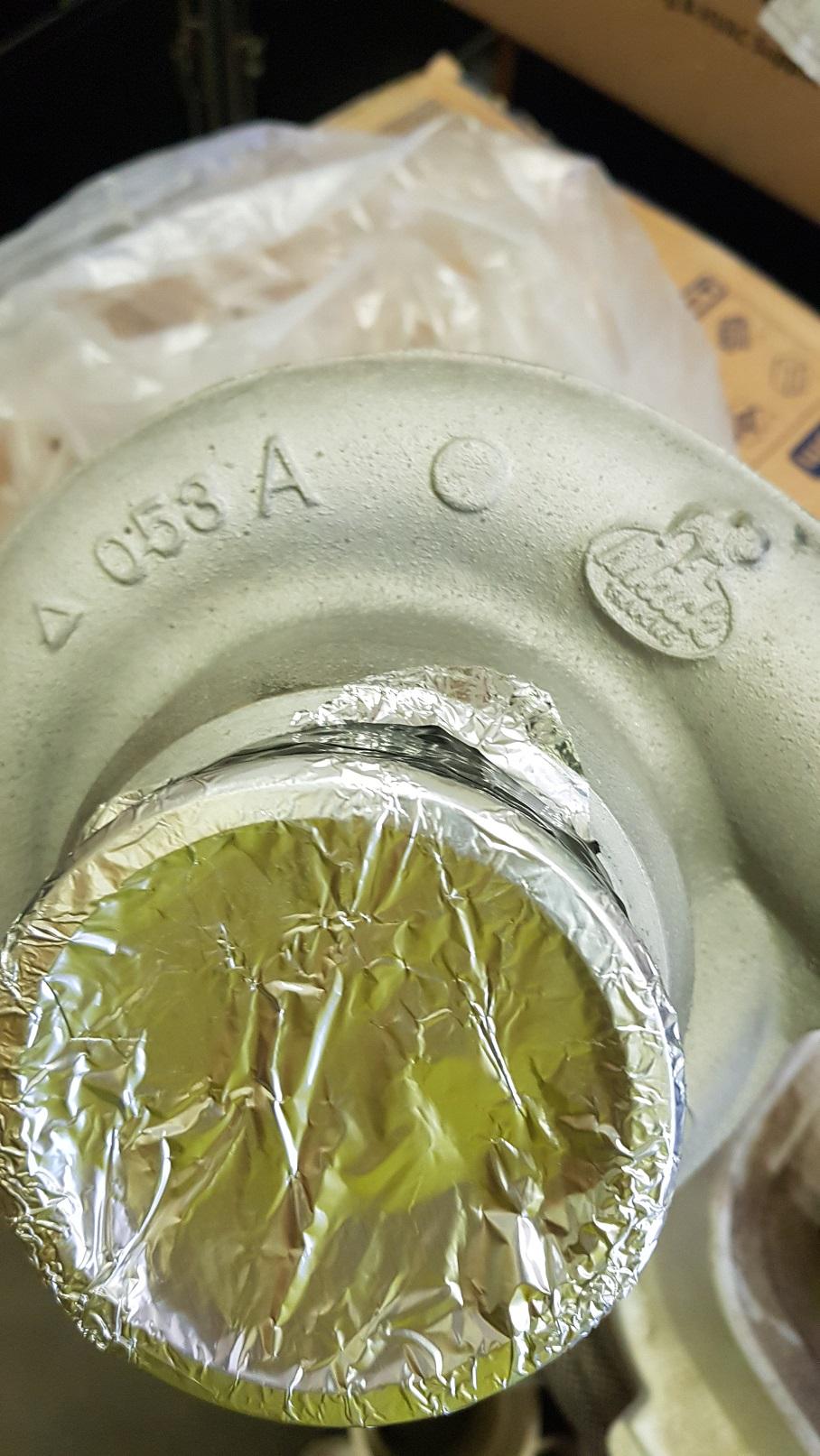

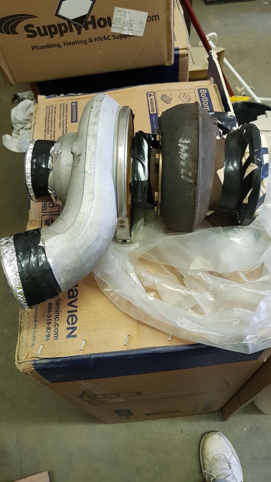

  1. For sale 1 slightly used (two months) turbo for a Granite CV713. The VIN on the truck 1M2AG11C05M026303 $500 OBO. Buyer to pay for shipping. Thanks Rob
