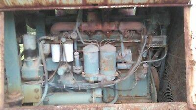

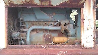

  5. I'm guessing it's an old Cat D343.
  6. Thanks JoeH, it looks more like a Ford Power Products than anything else I've see. I guess I'll have to drive the 325 miles to look at it. I'm hoping someone will buy it before I get there!
  7. I need a little help with the make and model of this engine. It's attached to a Gardner-Denver air compressor. Thanks, Zane
