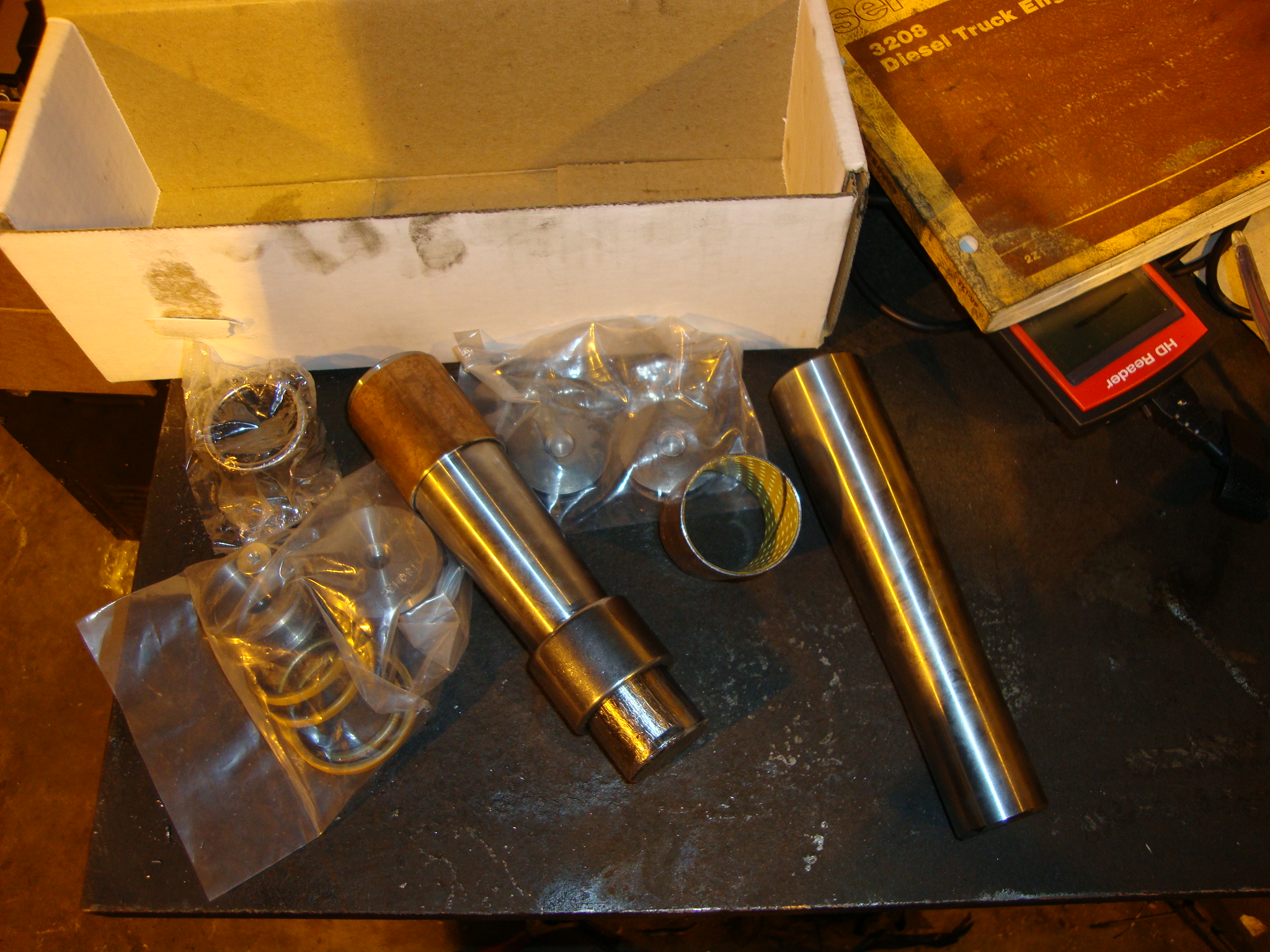

	So the truck I was suppose to be getting was not the truck that needed king pins anyways I have the truck now and the post I did the other day is greatly appreciated but not needed at the moment , anyways here is a picture of the king pin kit and axle just wondering what the spec is for final end play and the torque spec on the bottom nut, Thanks
