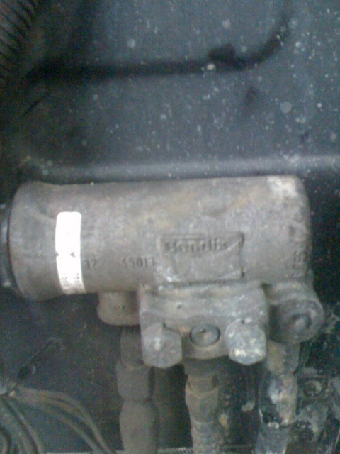

	You were right on the money, Dave. It was the air governer. Replaced it and WALAH!!!!!!!!!!! Fixed! Thanks a million for your help! Jeff
	Ok I just got back in from trying to adjust it. I went as much as 2 full turns which by my calculations was equal to decreasing the pressure by 32 psi. Started truck and still went over 150psi before I shut it down. I guess I will get a new one tomorrow.
	Ok I found it. It is mounted right on the passenger side firewall. Should I attempt to adjust it. I found on Bendix site that after losening the lock nut, 1/4 turn clockwise is equal to lowering the pressure 4psi. I dont want to screw anything up. My guess is that it is probably bad, but I dont know. Sorry if this is an inexperienced question, but if I do attempt to adjust it, does the governer just not let anymore air build up after a certain point or am I suppose to hear the air discharge. And when I do hear most trucks discharge the air every once in a while, is that the valve you were telling me to look for on the reservoir? Just asking because my 94 Ford L9000 use to do that everytime it reached 125psi, but this Mack has not done it at all.
	Ok thanks for the info. Did not see it until I just came in from installing the relief valve which of course from your explanation did no good, which it didnt. I will look for the part that you have pictured, but where would the governer be. I am thinking I might see it under the cab, could that be where it is? If so, I dont know how I am going to get to it. If so, looks like the cab will pivot up, but dont know what I have to go threw to get that up if that is what I have to do. Thanks
