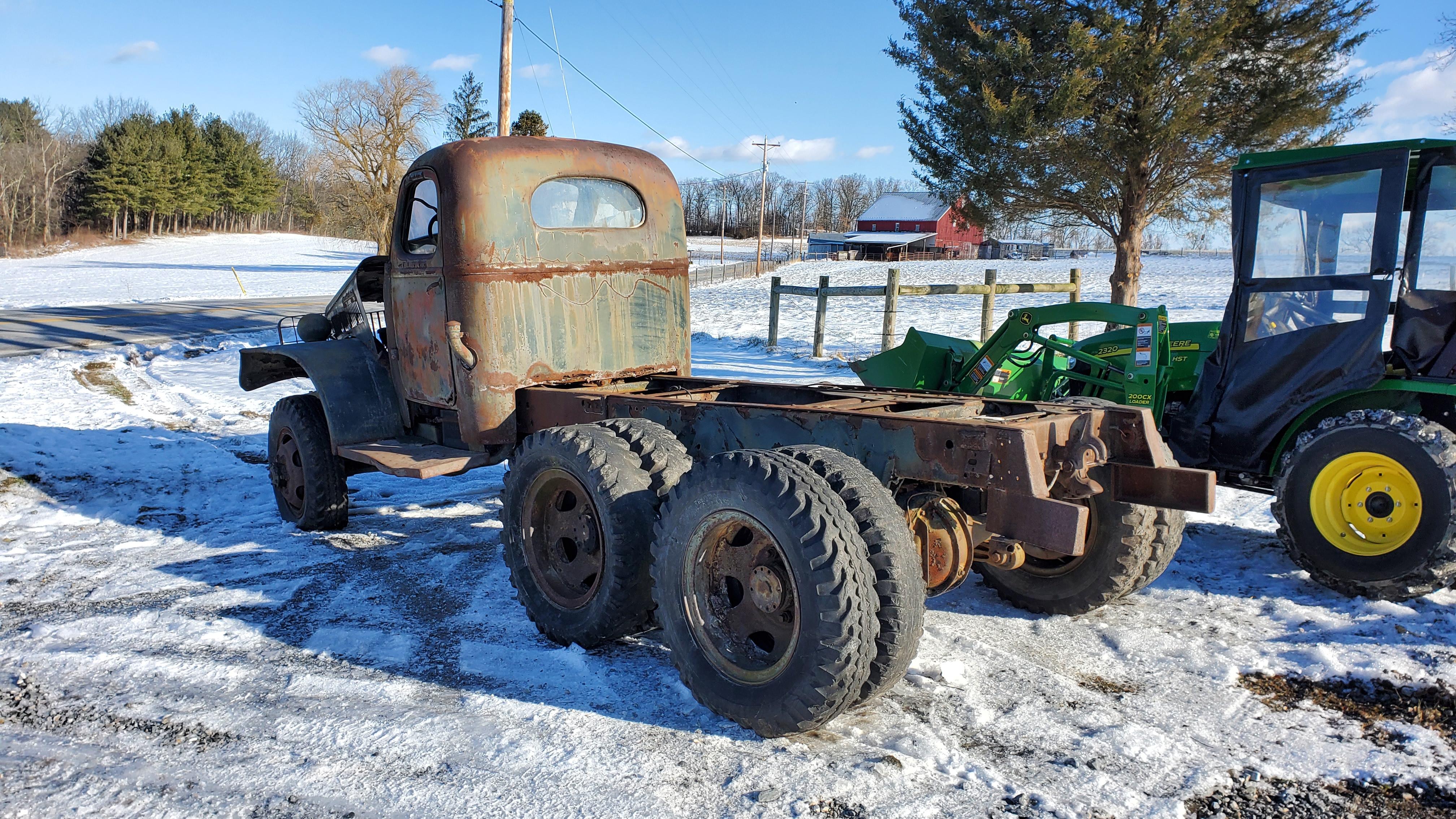

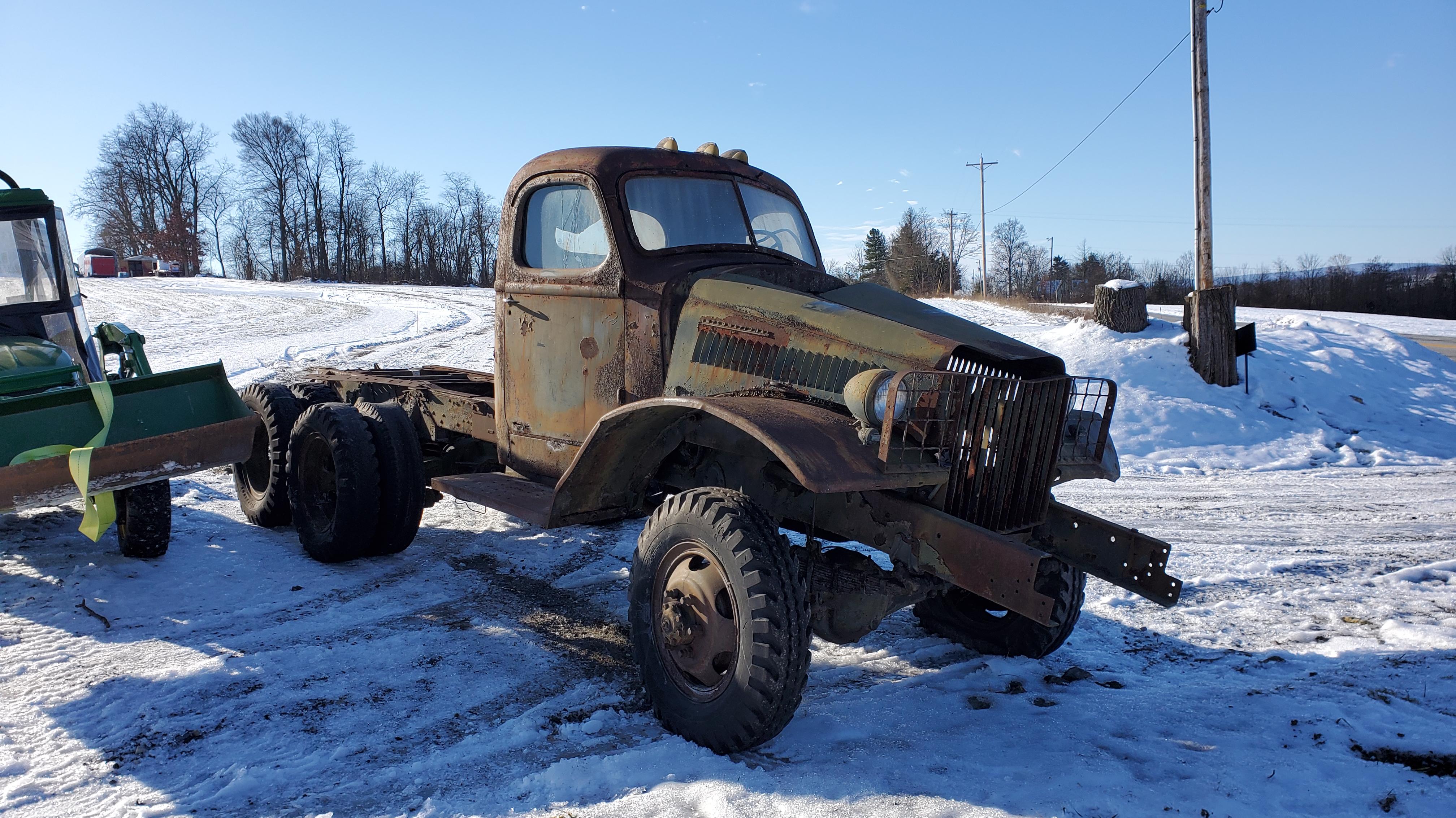

  13. This morning, my next project arrived at my "workshop" (aka my mom's house, where there is much more storage than my house). It's an IH M5H6 deuce and a half, which I acquired from my father-in-law in New Hampshire; they believe it's a 1943. I've had a soft spot for old IH trucks since my teenage years, when my uncle gave me an old K1 pickup; I remember him telling me that he didn't care if I restored it or sold it, just don't let it go for scrap, and that he hoped it would spark my interest in working on old trucks. Well, it certainly did that! I ended up selling that truck to a guy who planned on making a rat rod out of it, as it was too far outside my skills or knowledge at the time; there are days that I wish I had kept it, as I feel like I've learned some things in the intervening years that would make it a doable project for me now. Fast-forward to more recent times; my father-in-law bought a storage unit at an auction, and while cleaning it out he found this truck. They dragged it to his store, where it sat for a few years. My brother-in-law had planned to take the drivetrain out for another project, but then moved on to other things. I mentioned that I might be interested in it, and my father-in-law was more than happy to send it down the road to get it off his property πŸ˜„ She's a little rough, but still savable I think. There are some missing parts, most notably the radiator, but I should be able to find most of them as it has a Red Diamond engine, and the cab is the same as the K/KB models. I'm pretty sure the cab was replaced at some point, as it has chrome handles and chrome trim on the dash; also there are none of the military ID plates on the inside, and no holes where they would be. My plan is to start getting into this and my dad's old MB after I finish up my C85 this spring. A big shout-out to Tim Jones (Cosgrove's Cartage, a retired DC fireman) for hauling it safely to PA and dealing with adverse conditions both at pickup and dropoff! The truck that started it all:
