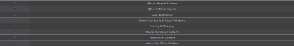

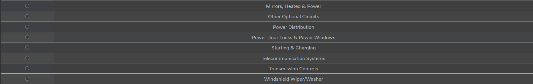

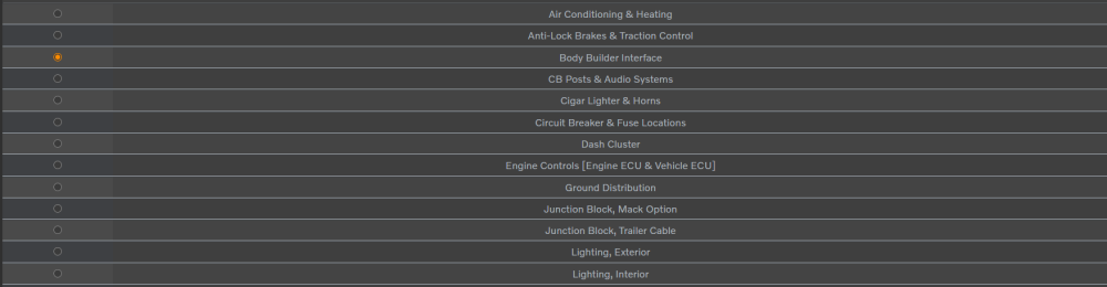

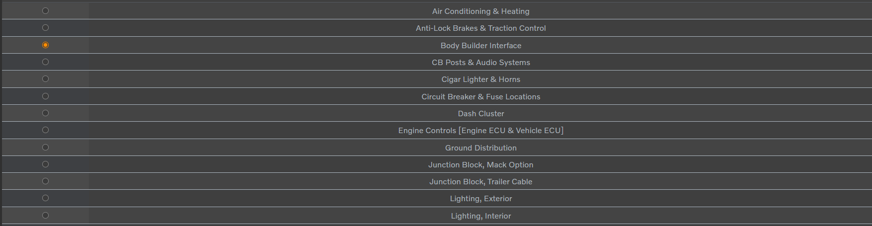

Wiring
in Mack Truck Q & A
Posted
I've never delved too deep into the ESV, so this might be a struggle...
What section are you looking at? These are my options per a 2004 VIN I have saved:
