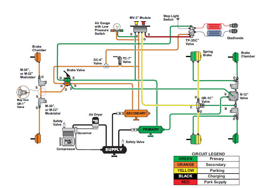

Not sure if your unit has a single system or a dual system. Older ones had a single air system. Air went from the wet tank to the dry tank and then to a single point on the treadle valve. Newer stuff had a dual system. Air was split into 2 separate systems so that, if one system failed, the other would still operate. I think those used a different treadle valve setup. I think those were split front/rear. Those dual systems were a little after most of what I had experience with.
There shouldn't be a difference in air pressure between the wet and dry tanks.
Here is a Bendix chart showing a typical dual system. I can hook you up with their troubleshooting guide (see link).
