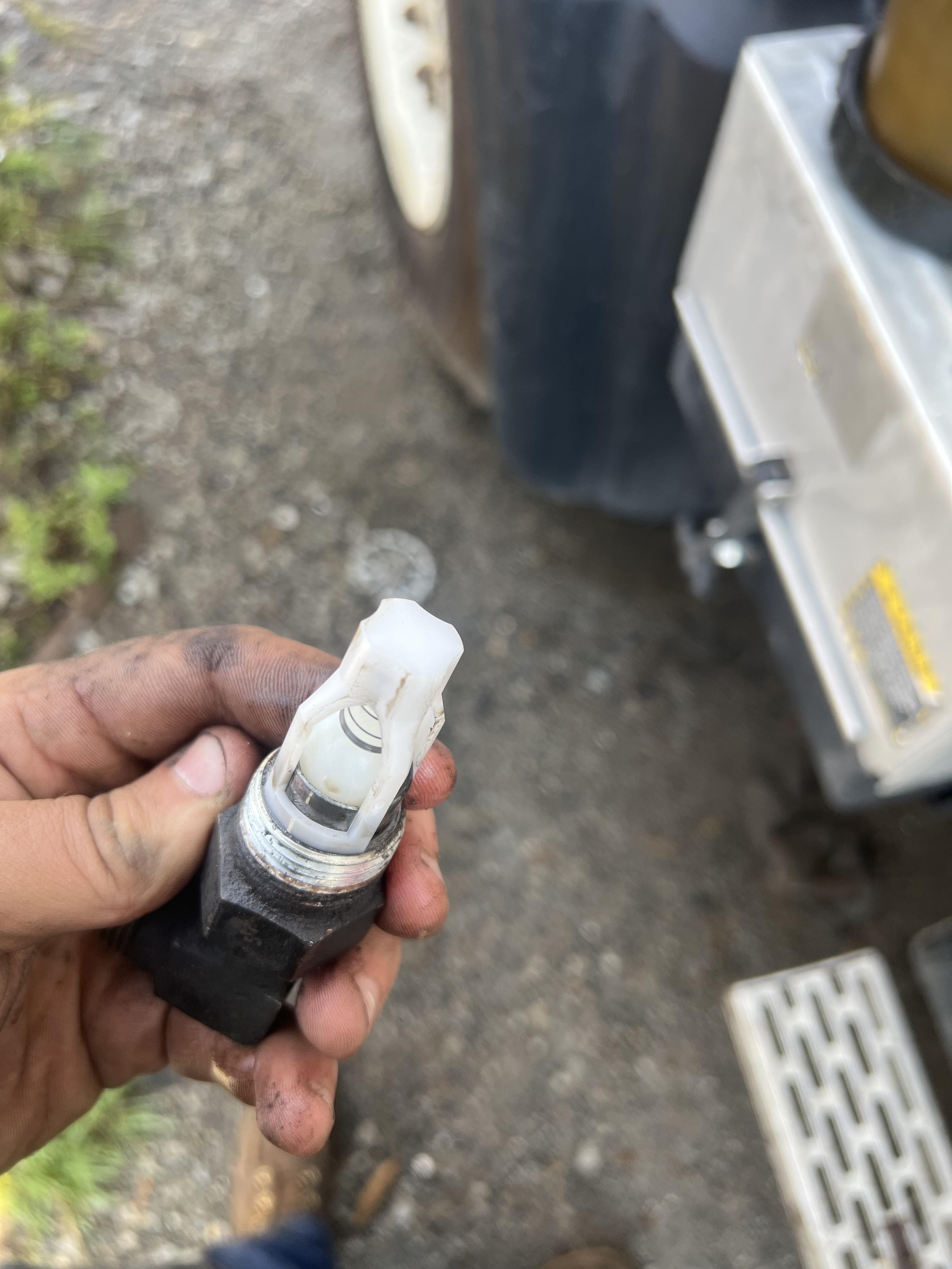

	Not yet I’m going to do get under the valve cover this morning have you ever seen oil get up through a wiring harness like that I can’t think of any other way the oil would have gotten there. Id like to find a pin diagram of that plug to try and narrow down the possible culprit. Thank you again in advance you’re always a huge help! -Chris

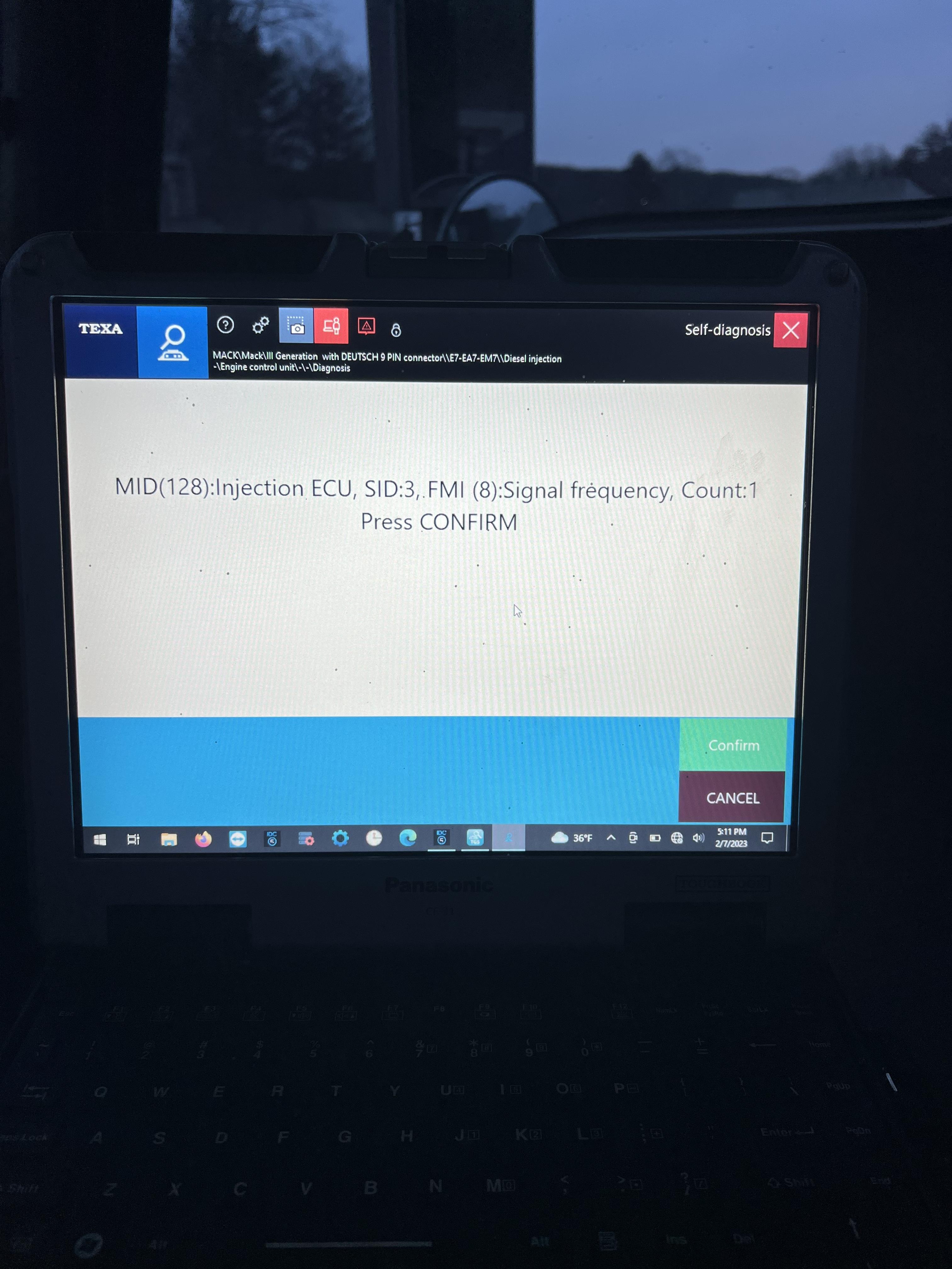

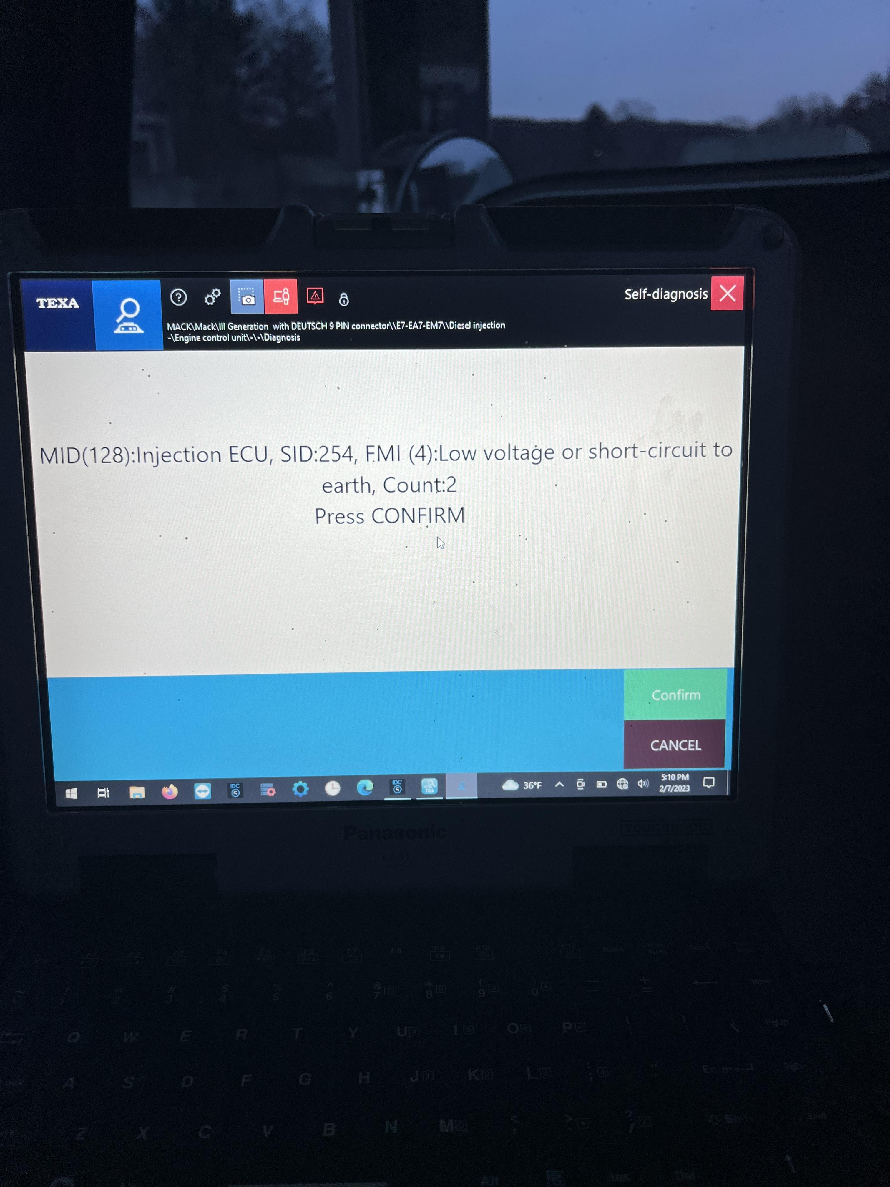

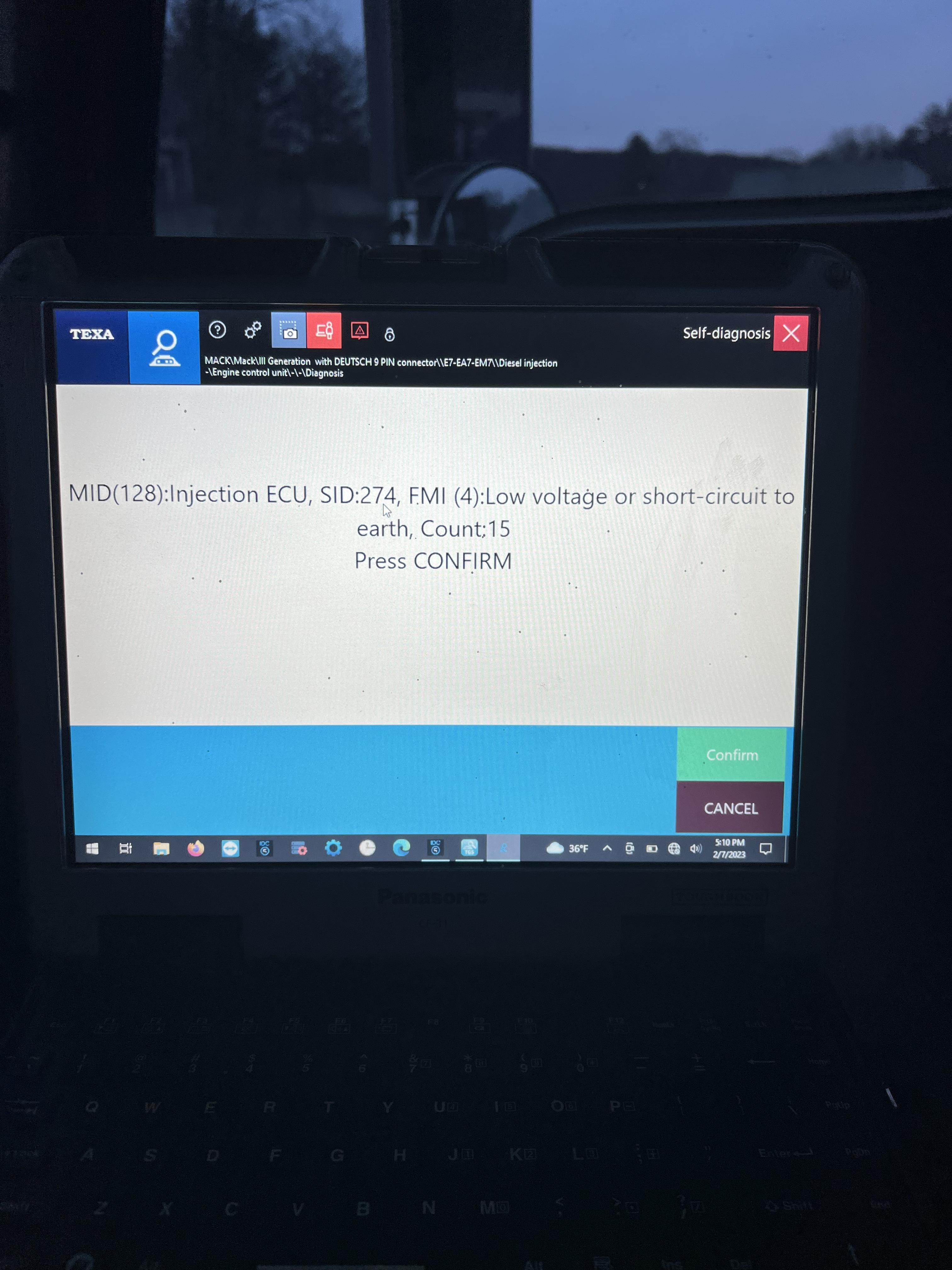

	Alright gentlemen here’s the story with this one, The truck was run out of fuel, they started it with a ton of ether, it ran away for a short period of time (under 30 seconds) it’s got a miss now, I’ll type the codes I pulled below there all memory codes at the moment. I pulled the cam sensor and found metal on the end of it possibly from a failing throw out bearing which could obviously cause a rough idle, I disconnected the main plug harness going into the injection module and found engine oil inside the plug, on the module. Is it possible the oil pressure sensor failed and oil got pushed through the wire and up to the module? I have no idea how else I’ll could get up there which seams to be where the oil filter housing meets the block injector cyl 1: MID (128 ):Injection ECU, SID:1, FMI (8):Signal frequency, Count:15 33038: MID(128):Injection ECU, SID:270, FMI (5): Low current or open circuit 33037: MID(128):Injection ECU, SID:269, FMI (7):Wrong answer from mechanical system, Count:15 Injector cyl 2: MID (128):Injection ECU, SID:2, FMI (8):Signal frequency, Count:15 camshaft sensor: MID(128):Injection ECU, SID:21, FMI (2): Wrong or intermittent data,Count: 15. turbocharger 1 speed:MID(128):Injection ECU, PID:103, FMI (1):Value under standard, Count:1 engine speed:MID (128):Injection ECU, PID: 190, FMI (2): Wrong or intermittent data ,Count: 1 SAE J1708/1587 data bus:MID (128):Injection ECU, SID: 250, FMI (8):Signal frequency, Count:1

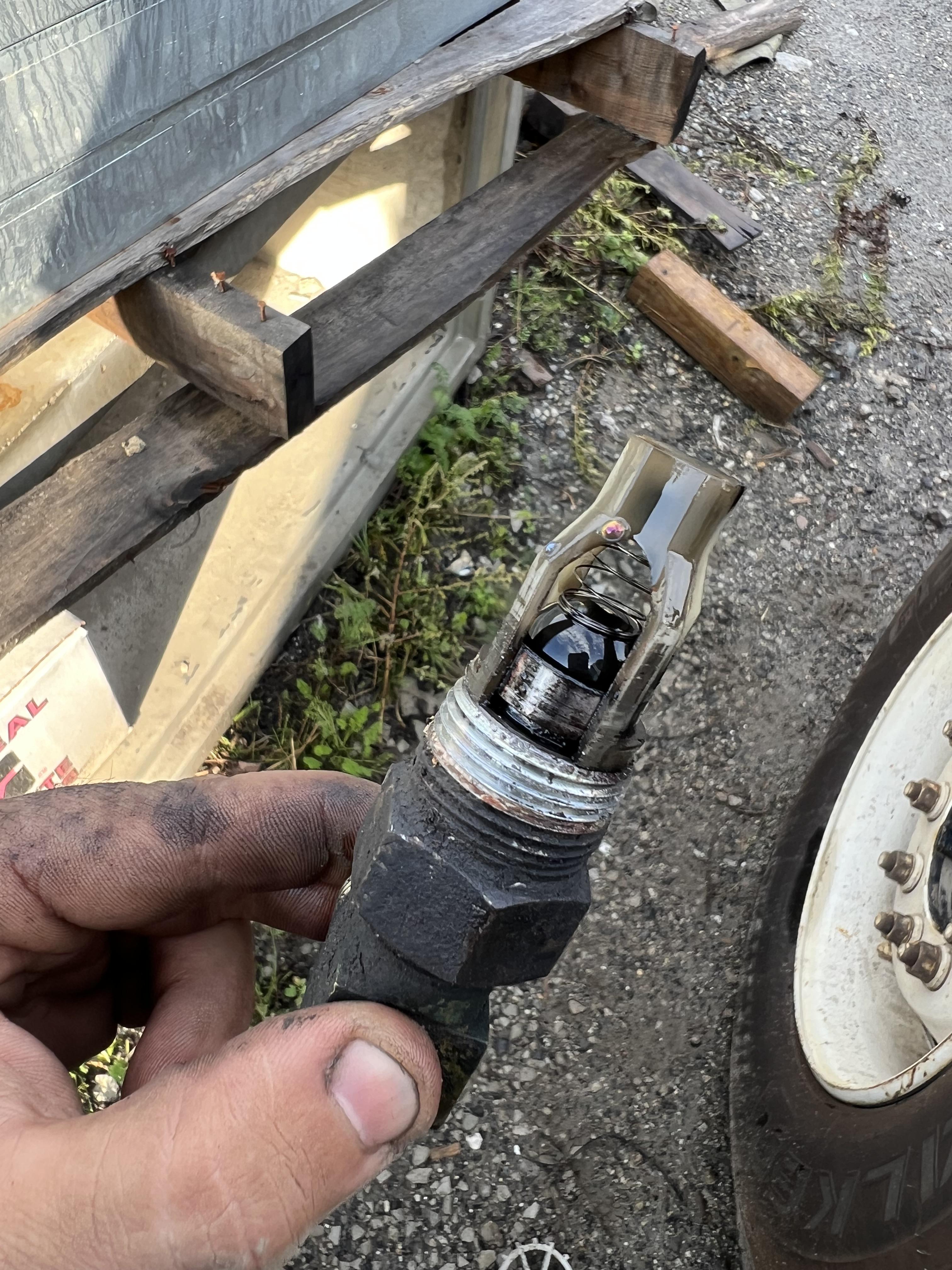

	Seals and check valve looked ok they didn’t have a double gasket stuck under the filter I gave it a new filter and o-rings and changed the check valve the fuel looks clean I did notice a black film on the inside of the metal portion of the filter housing I’ll add few pictures here. Dumping some fuel in now and trying to fire it..also when I got to the truck today the housing was draind down to about an inch below the inlet port in the housing
	IMG_0020.MOV Good evening all, Working on 2007 Mack CV713 they’ve been running the truck it looses power, upon filter change the truck runs better but eventually bogs down again, its a very hard prime and once running you can see bubbles in the clear fuel filter housing and the bubbles do continue after the truck is shut down what is the best way to test the fuel system to pin point the area causing the issue. Tanks do not appear to be dirty, bubbles in the drivers side tank i be leave is from the return line spraying into the tank and aerating from the stream not necessarily from air in the fuel, and there’s no visible leak around the primer pump, have not yet checked any check valves. Any help or advice on how to best proceed is greatly appreciated hope you are all well. Thank you- Chris
