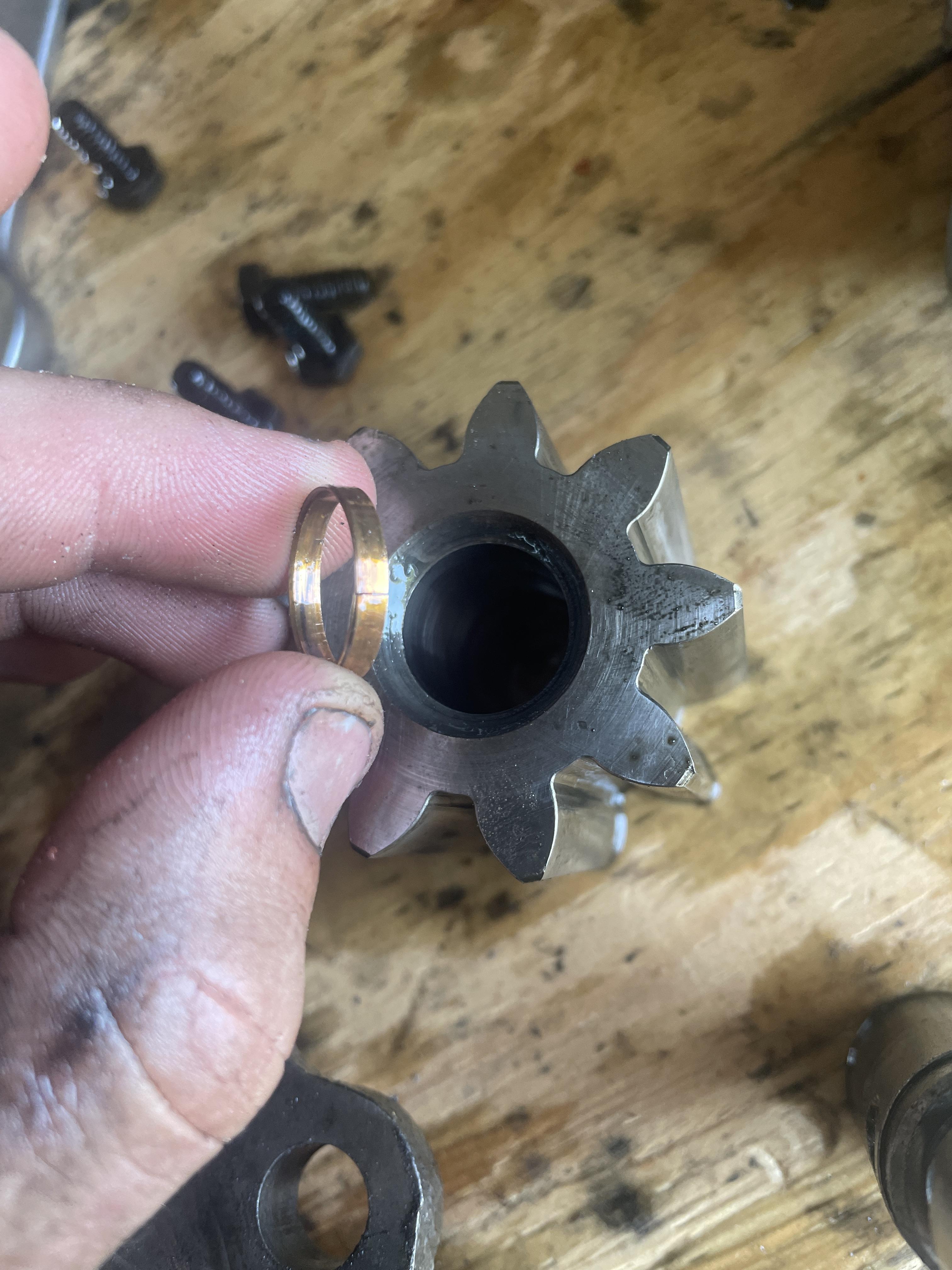

And what about this brass bushing inside this gear? Is it supposed to be one long piece? I’ve got one small piece and one big piece -

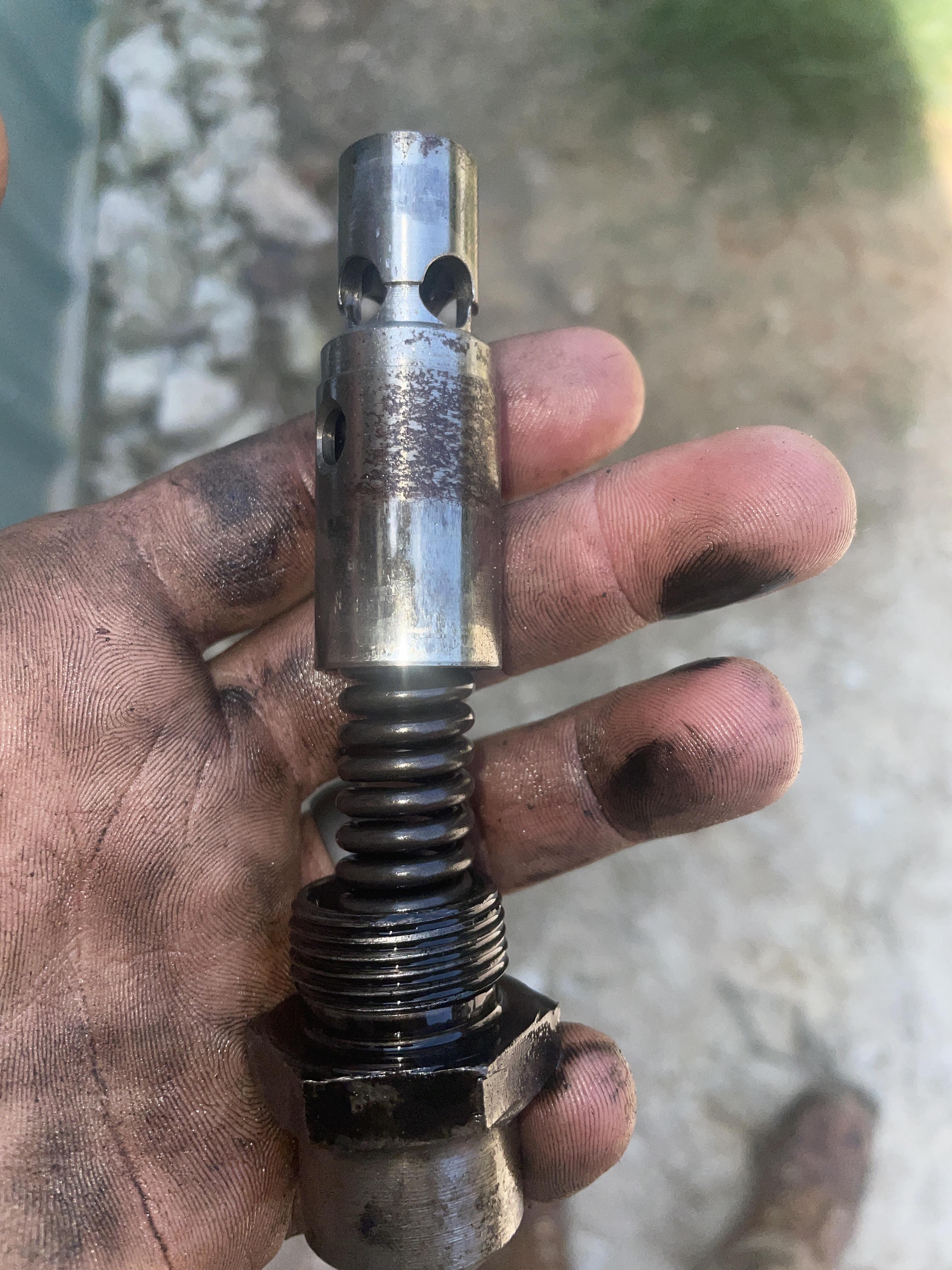

Would the surface rust on this pressure valve on the oil pump itself be a problem? I also pulled some bearing particles out of those small holes. I’m not super confident in my knowledge of how this oil pump works and what this pressure valve thing is for -

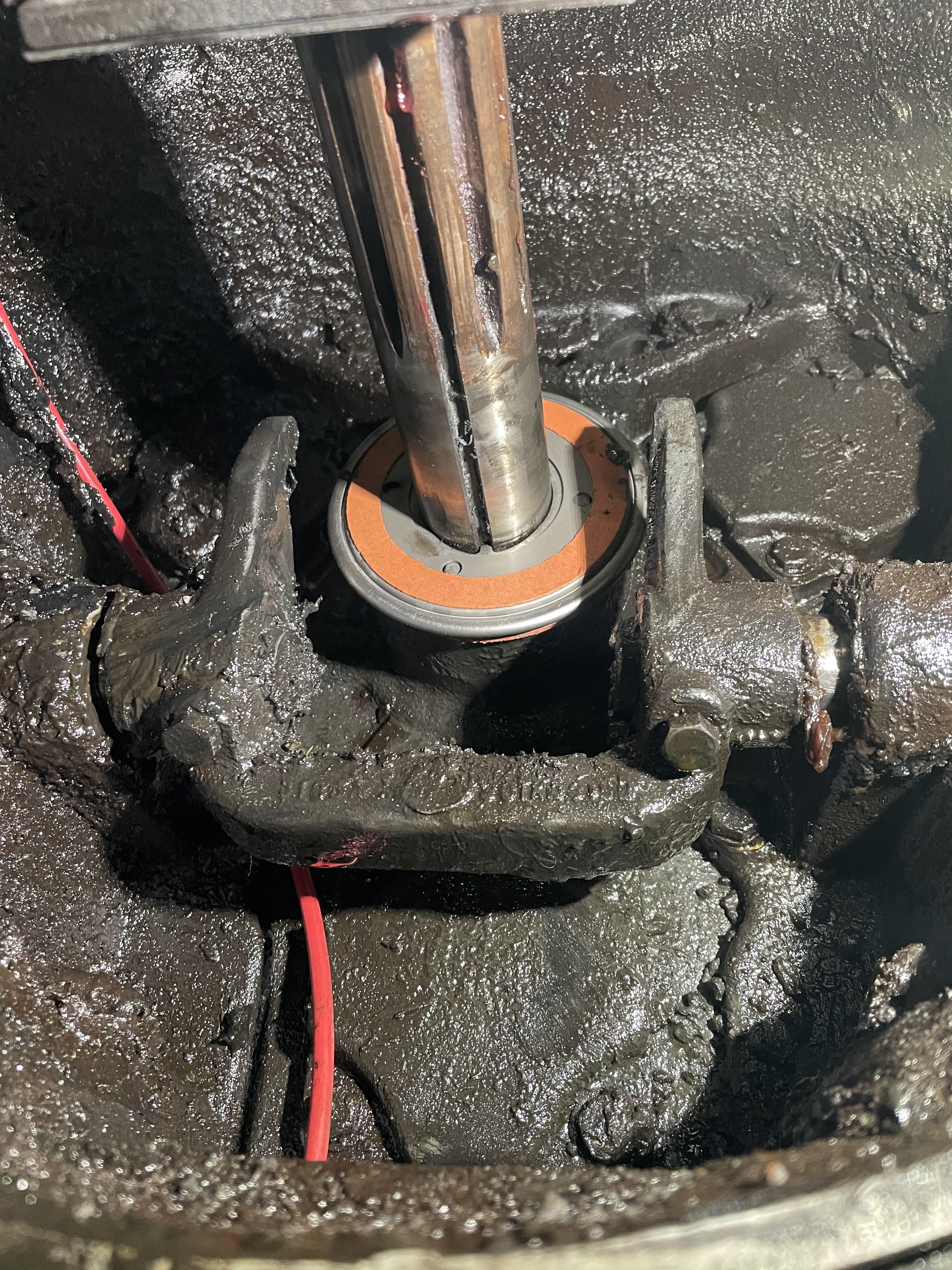

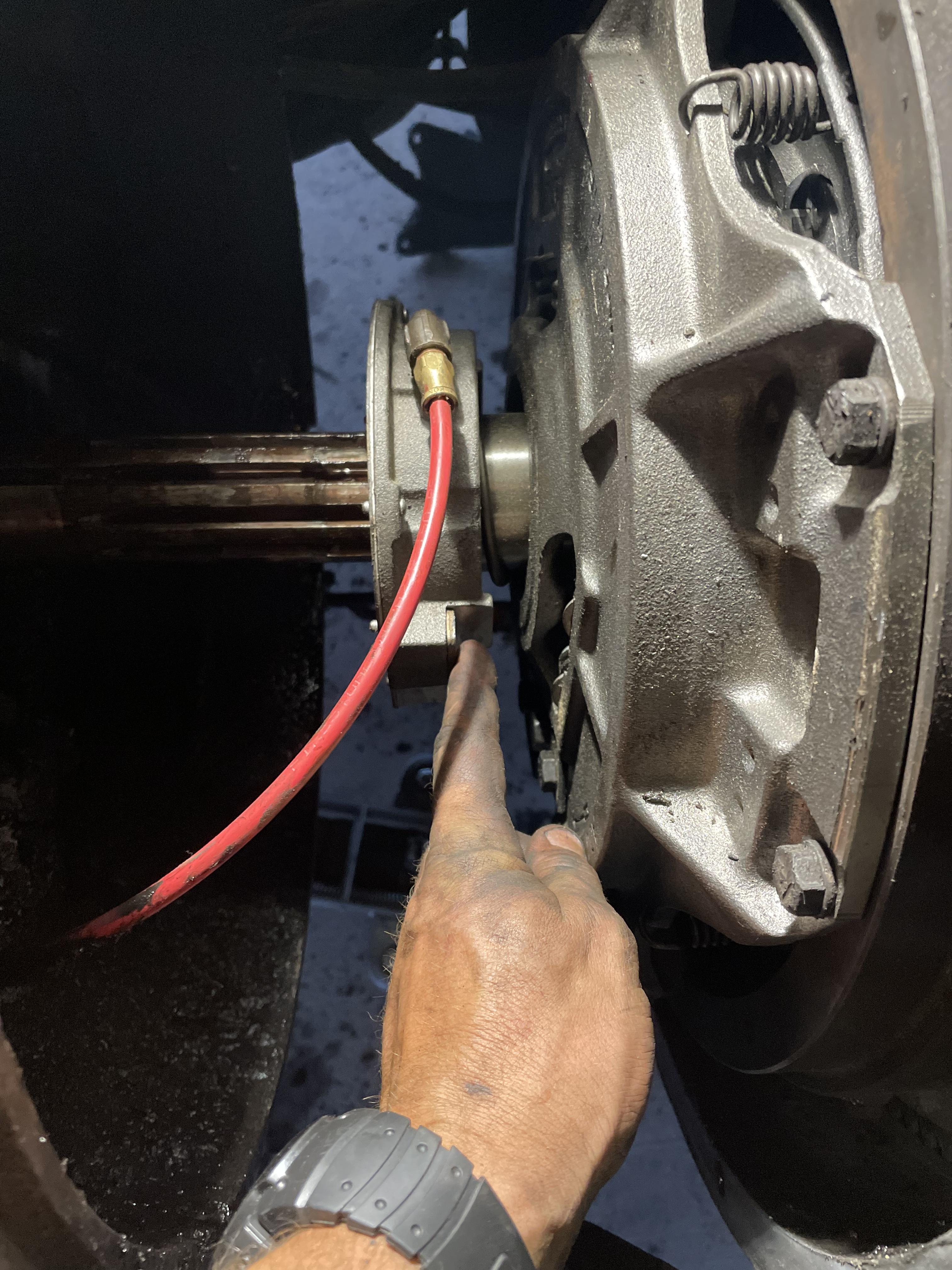

I’m a little confused fellas. Been a long time since I done a clutch in a six speed. The truck is an RS686. I’m looking at this release fork and the way the cable works it seems completely backwards. If I push this back together with the fork on the transmission side of the throwout bearing then when I push the pedal it will actually pull the fork away from the bearing. So how would it engage it? First picture showing the fork. The paperwork is reading like the fork goes between the throwout bearing and the clutch pack, but if that’s the case then the fork would pull the bearing towards the transmission, how would that ever work? Second picture showing the bearing and my finger is pointing to a pad that the paperwork says to put the fork on.
