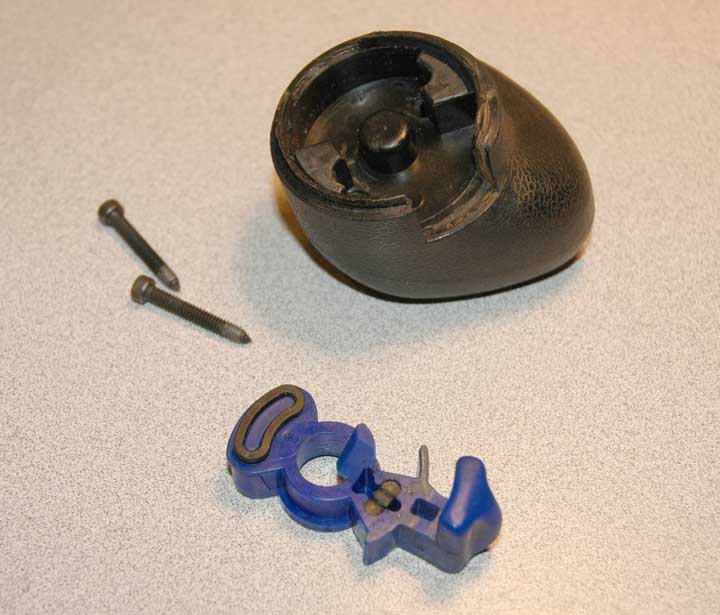

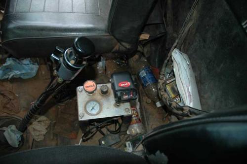

	Fulton Shifter ProblemIdleUp replied to IdleUp's topic in Antique and Classic Mack Trucks General Discussion I was just curious how you get the rubber seal in that grove when you assemble the whole thing - it takes some pretty good pressure to hold all that together. Thanks
	I was shifting gears today and all of a sudden I started losing air from the area of the shifter handle. I found one of the two screws had loosened up. Anyhow I removed the other screw the Low / low shifter parts flew out which consist of two springs and plastic piece and a rubber seal. Is there any trick with regard to re-assembling the shifter.

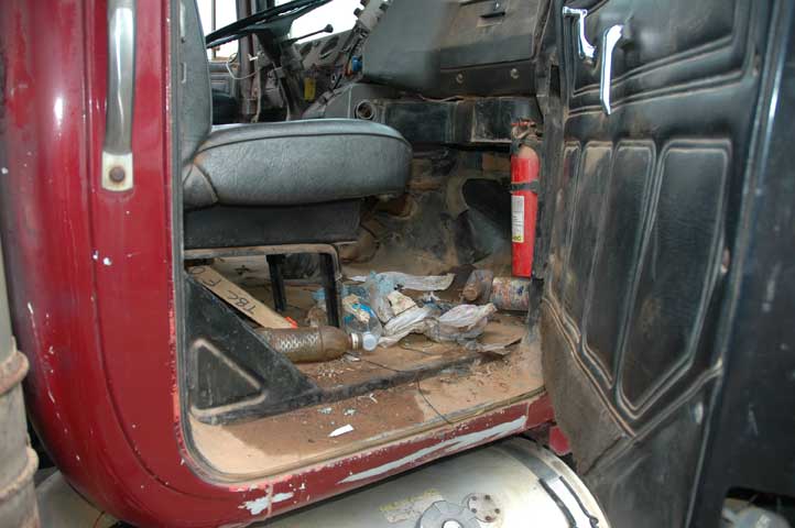

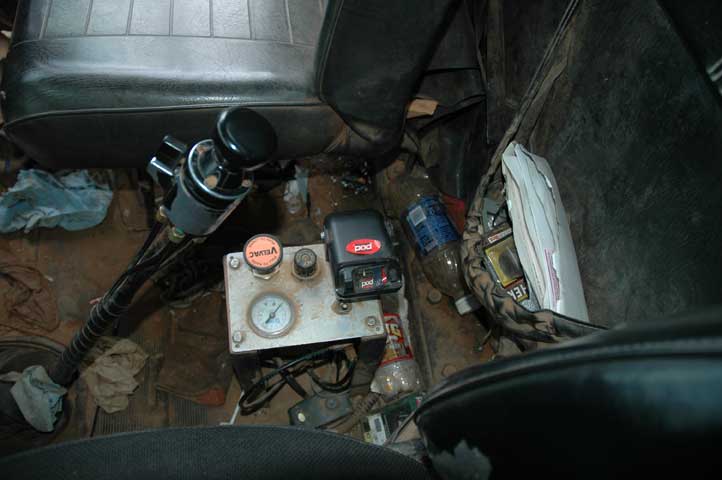

	It's unbelievable that someone can treat a vehicle that is paying their bills so bad. If the inside looks this bad, I can only imagine just how good he serviced the truck. It was almost painful to drag all the trash out of this truck! Believe it or not - I used my pressure cleaner right in the cab to get the grim out!

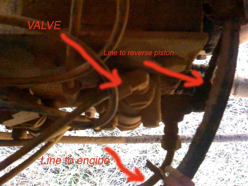

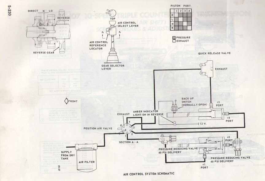

	OK, here's a few images of the lines running off the reverse air piston. Two lines are T'ed off with one running to the shifter and the other to this valve - from the valve (like you guys said) it runs to the engine as shown. Can't figure out what this valve does. I didn't get a change to cap the line today, but i will next time I get out there to see if it makes any difference. Thanks
	It's so dirty under there it's hard to tell but it looks like it goes up to the cluster at the shifter boot - then the other line goes to some sort of valve mounted on the drivers side frame. I'll trace the line today! The arrow on the this images is almost exactly where the T is located. This is the correct shifter correct?
	Ok, you guys have to be getting sick of me with this shifter problem - But I noticed today there is two lines on the end of the aft end of reverse cylinder instead of one. Looks like one goes up to the shifter and the other goes to the frame and hooks into some sort of valve with other lines going to it. Is this a quick release valve or is it something else? Thanks

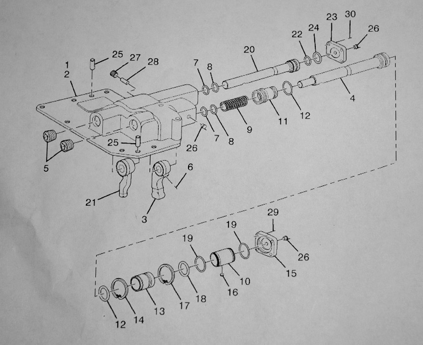

	I picked up the O-ring kit and a cover gasket today - I included a part layout below the guy gave me. I'm going to check the airlines as suggested. Is the reverse piston the one on the right #4? The guy at the dealer said it could be the shifter control!!! Thanks

	Thanks so much for all the info - I'm going down tomorrow to pick up the rebuilding kit. Rob did you find that image of the shifter plate, I'm curious what it looks like. I finally figured out why it goes into reverse. If the air pressure is below 60 lbs then I can generally get it in reverse as many times as I like, however as soon as the buzzer goes back off, it won't go in reverse any longer. I thought someone told me it might be a quick release valve. I'm wondering if that's the problem. Thanks By the way, my email is: mail@rotory.com

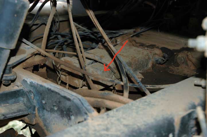

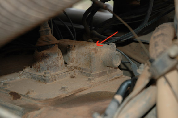

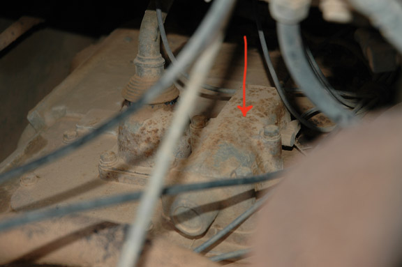

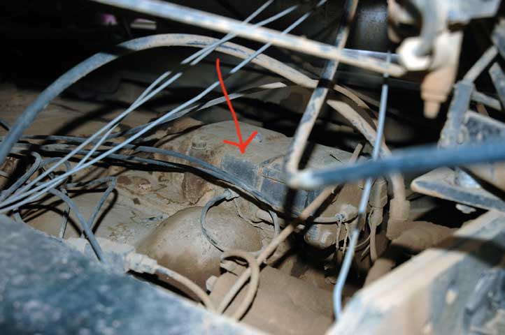

	Ok - I just shot these images of the rear shifter module from both sides - looks like it might be the one from the right side of the truck, ( upper image) I would imagine the wire goes to the backup beeper and dash light. Do I just remove the 4 bolts on the end of the unit to access the shifter O rings?

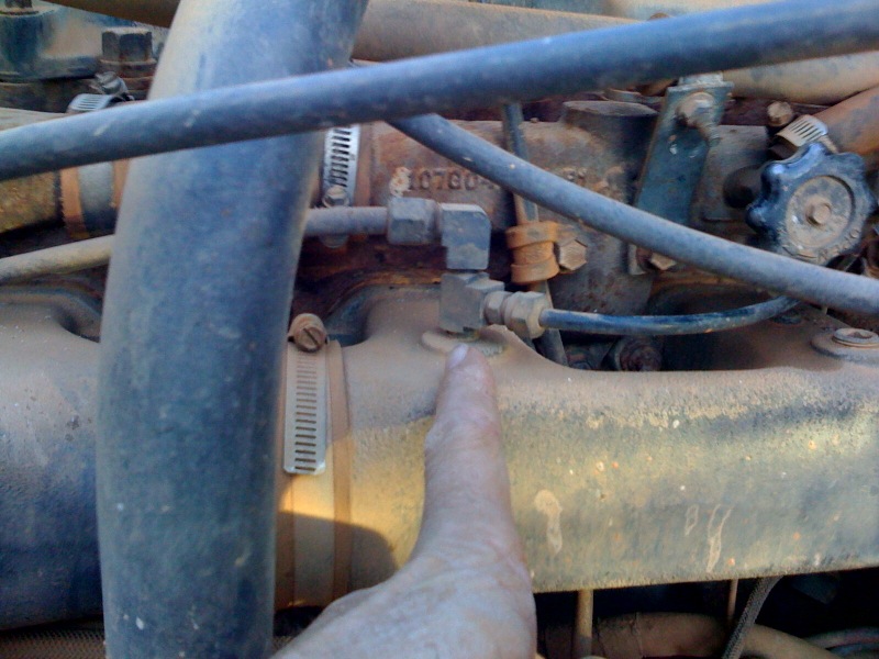

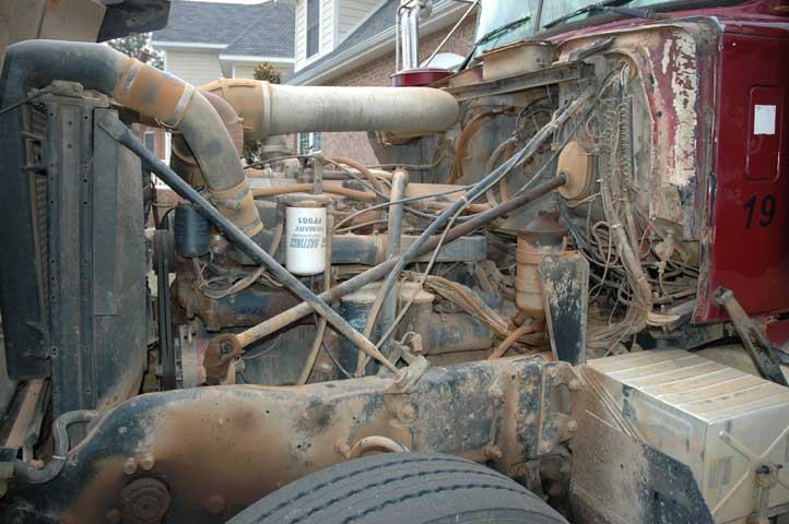

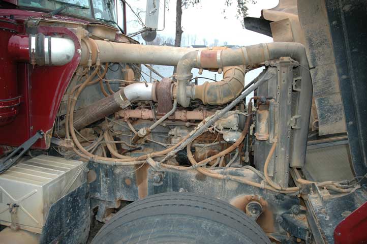

	Thought i would post a few images of the engine of my 1990 Superliner - I see a few leaks here and there. The ID plate says it's a 400 hp. As you can see, the guy who owned it did absolutely nothing to the truck other than drive it.

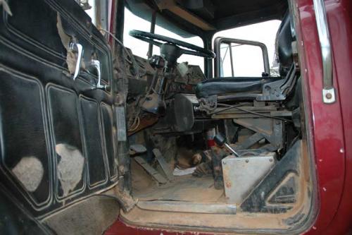

	I finally brought my (new) truck home tonight. The guy who had it trashed the poor truck beyond reason. I would like to fix her up a bit. Is there a location that sells the interior parts ( door - rear panels - dash parts etc.) mine looks pretty darn bad. She's a 2000 Superliner. Here's a few images.
	Rob, I finally got the rag started and drove it home I removed th batteries and charged them up - I snapped a few images of the reverse module just to confirm this is the right unit. I assume I just remove the four bolts right? I also posted a thread on the interior forum looking for some interior parts.
