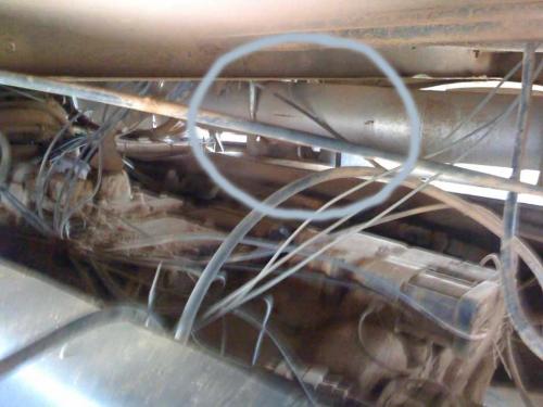

  1. By the way, I was right that line up against the exhaust is burnt half in two, but it's not leaking air and it runs aft (somewhere).

  4. I just noticed but it looks like this line is right up against the exhaust pipe _ I wounder if it's burnt and leaking air?
