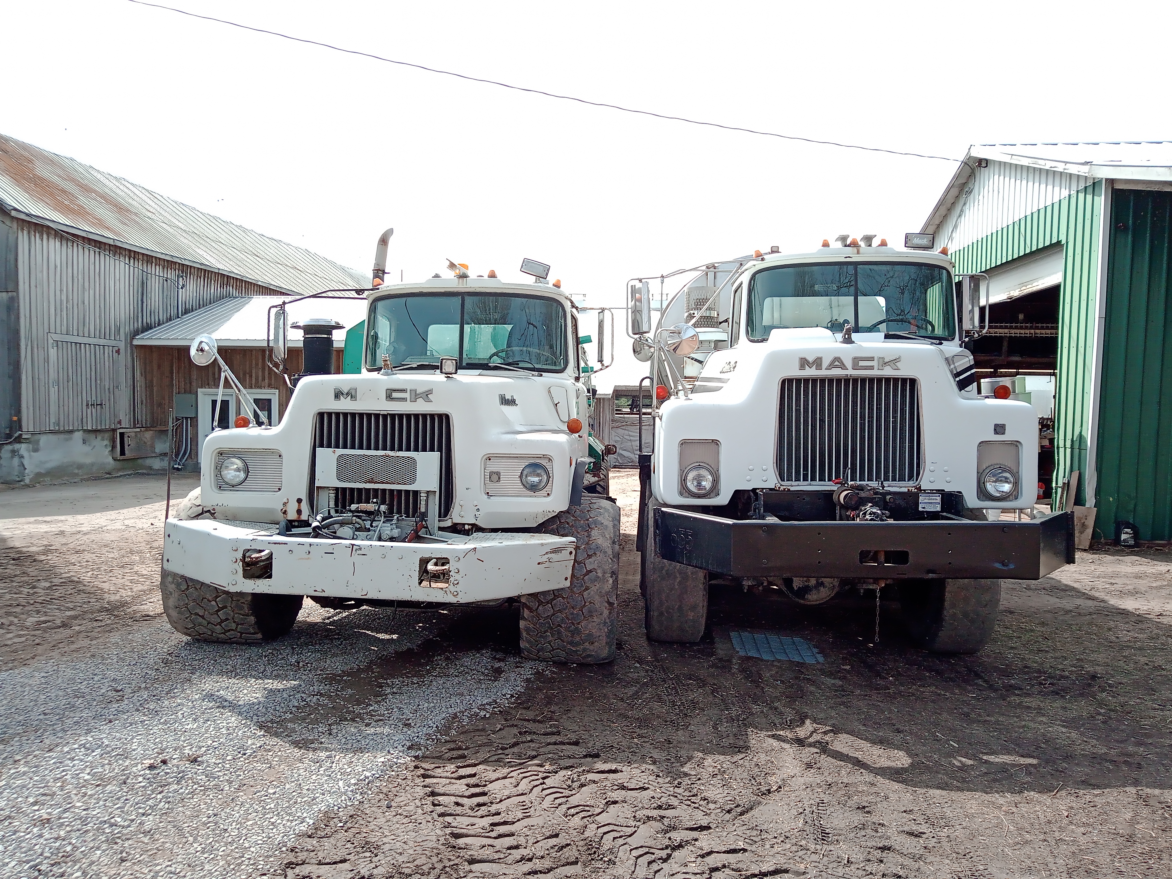

  8. Hi everyone, I posted here in 2019 about the DMM we acquired. I'm just now a few weeks away from having it fully operational. BUT in order for it to drive through the fields in the conditions we sometimes get into, it needs a bit more rubber. As you should be able to see from the picture, the 680 on the left has 650/75r22.5 on the front. On the back it has 710/65r22.5 which are of course even wider. Ideally I'd have 710's on the back of the DMM too, although they are very expensive tires, and burn up really fast on the road. Also, they are bigger than the 11r22.5's that are currently on. Because the DMM is 6 wheel drive, I'm concerned about damaging my transfer case if I run bigger tires on the back than it was designed to operate with? Does anyone know the standard ratio of the mack transfer case? I'm assuming there is a differential in there, because it says full time 6WD with manual locking. So the differential would allow for the rears to turn slightly slower, but it would mean more power moving through the spiders than it was meant to do. Unless they're just built so heavy it doesn't matter? Second, I have Dayton hubs on the back, does anyone know how to run DUAL 425/65r25 on Dayton hubs I think if it's possible, that could be an affordable solution to put as much rubber on the road as single 710's I know a guy who used to run triple 11r22.5's, but I'm not sure how he did that either. He says he welded the outside rims to the middle rim. But I don't know how he ever got the tires mounted or unmounted after that. Thanks for your wisdom. Andrew. More pictures on request 🙂

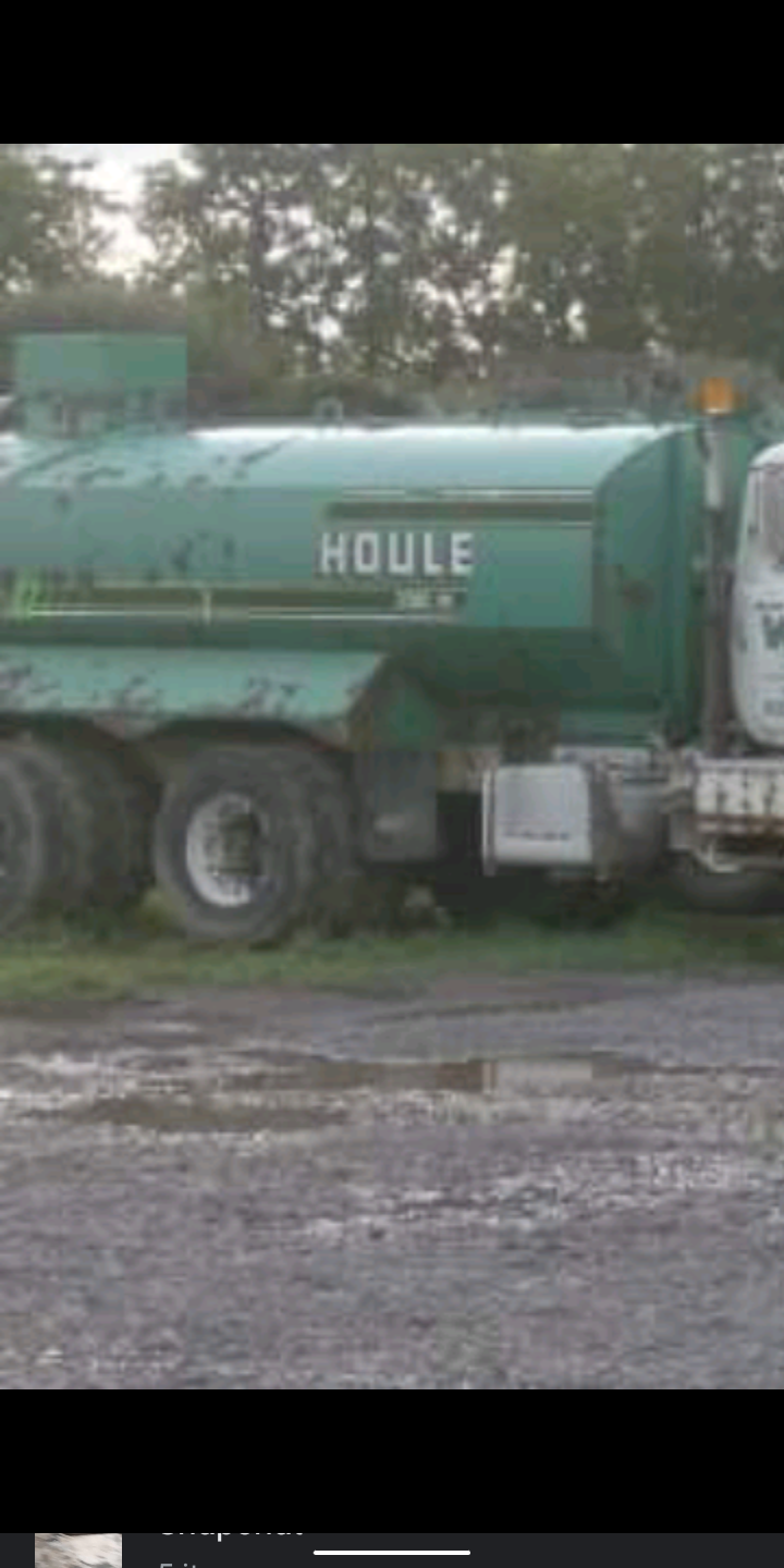

  10. Yes the DMM is replacing the one with the green tank on it. They were both previously cement mixers. The older one is pretty much worn out. The feed truck is also done for. The cab is an absolute state. Pulling the cab off, engine and transmission out and turning it into a dump trailer. Unfortunately/fortunately, and what I bet is pretty common, the engine in the feed truck still runs fine. Bit of a shame to turn a running truck into a not running truck but the cab is just not worth repair. I have been pondering the idea of swapping the 350 into the DMM, it has a 275/285 currently. Don't remember which. Unless it would be easier to move the intercooler and turbo? And turn up the pump on the DMM? what do you guys think?
