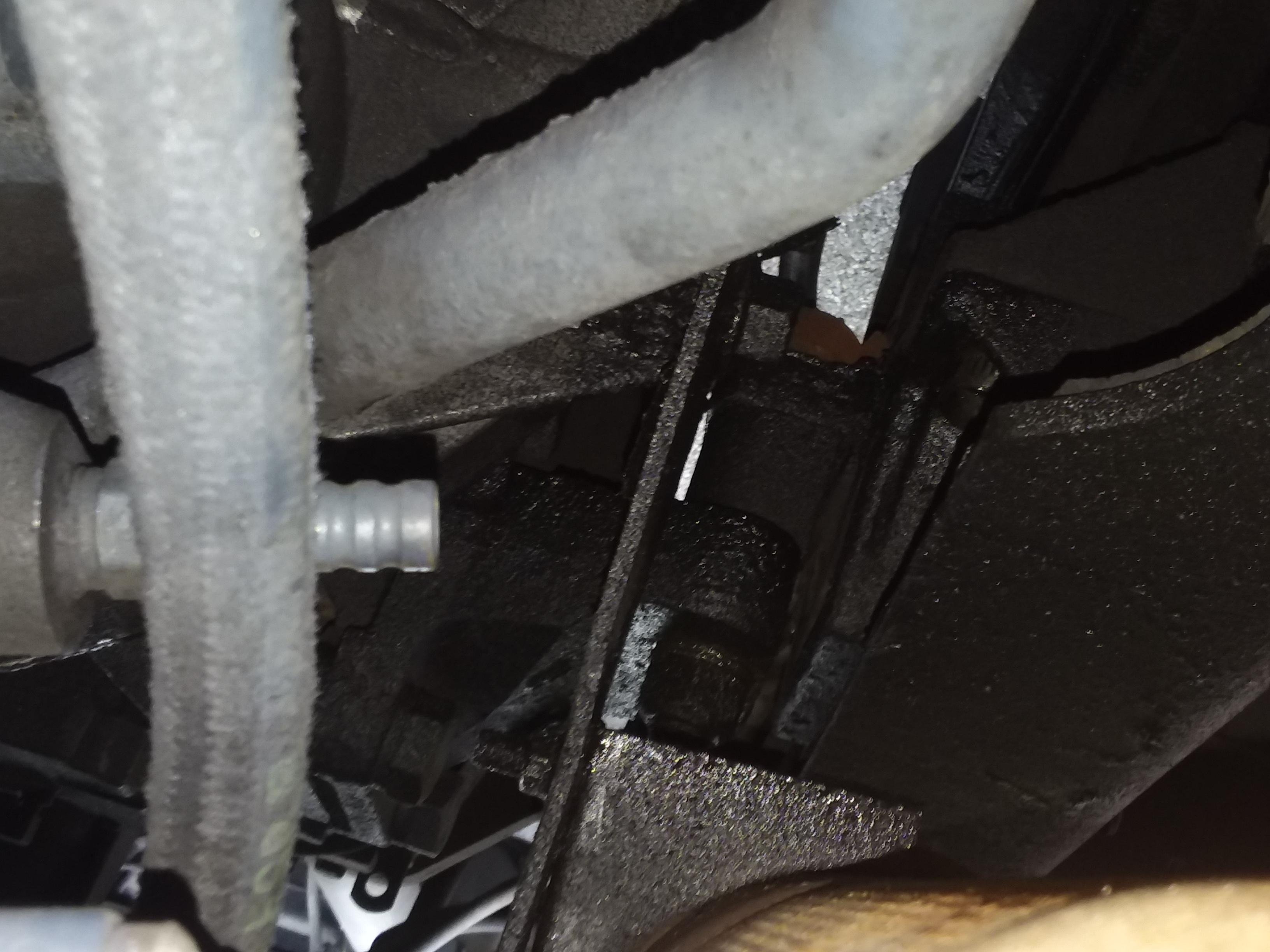

  7. Trying to figure out what this port is for? Coolant comes out of it sometimes. Looks like it is screwed right into the block. It makes a mess on the right side under the cab. Runs down the transmission. I'm pretty sure its coolant. Would think it would stink of fuel if that was it, and the oil really doesn't go down at all. The picture is up side down. Its on the right side of the block.
  8. It's been rebuilt. Runs better, still no pulling power. Now it has a mystery coolant leak. If it sits for more than 24 hours it loses prime.
