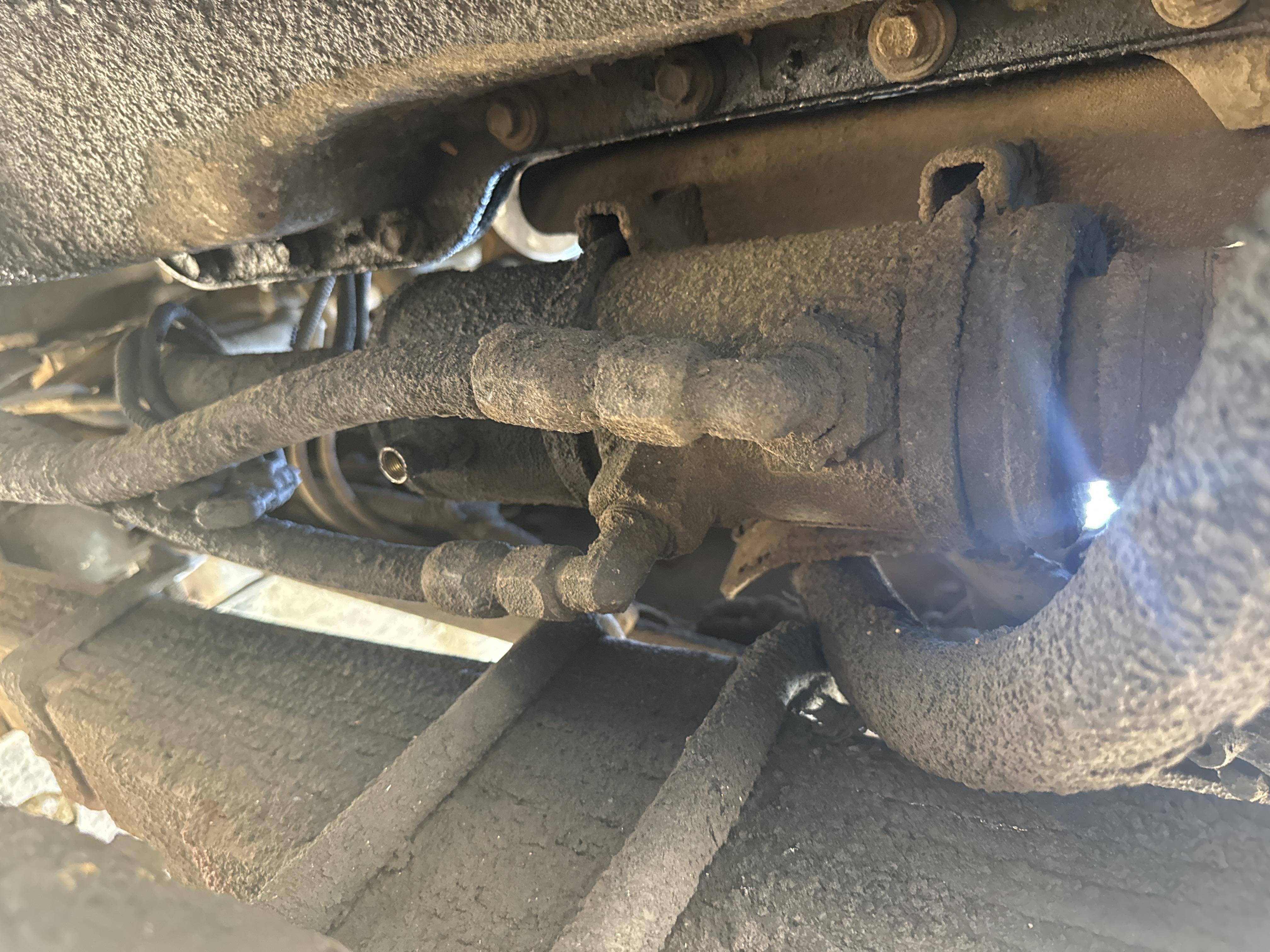

  1. With the water I think it all came from when compressor went out haven’t seen any since but haven’t drove it a lot cause don’t want to mess it up any worst
  2. Please post pic if you don’t mind I haven’t had time to check it out much just pull the blow by filter it was full of slug not there before but oil is fine no water thanks
  3. Still no sign of water in the oil even after driving it with 22tons on its back but blowed about 1.5 gal oil out Blow by filter was full of slug wasn’t there before when I changed the oil few months ago plan to pull pan and check like Joey had mentioned thanks guys
