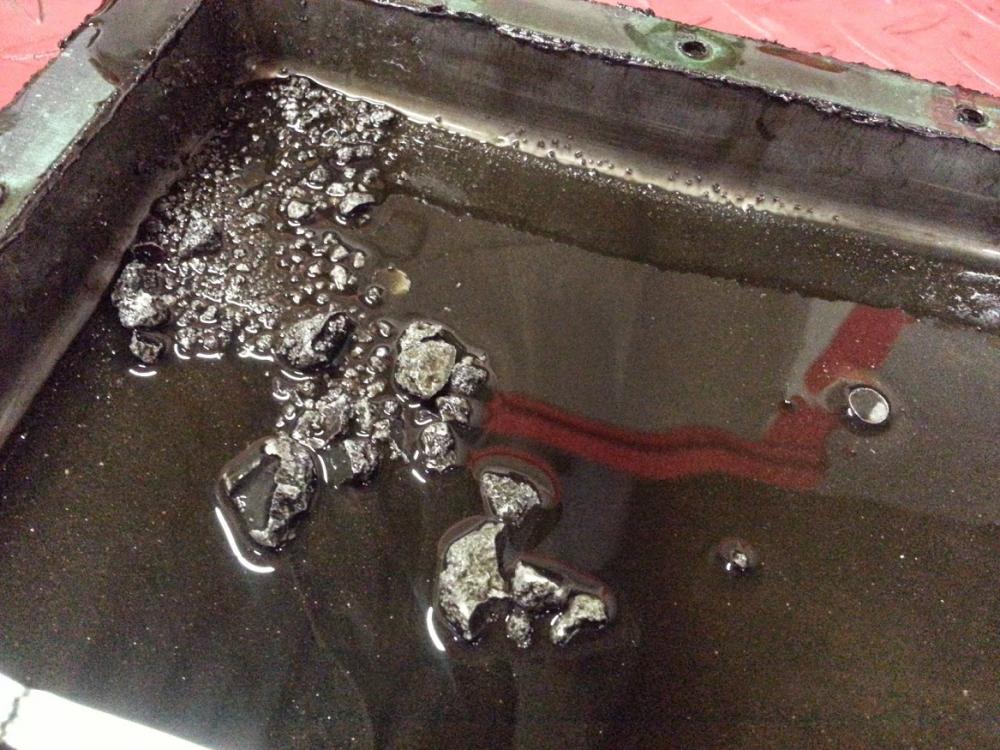

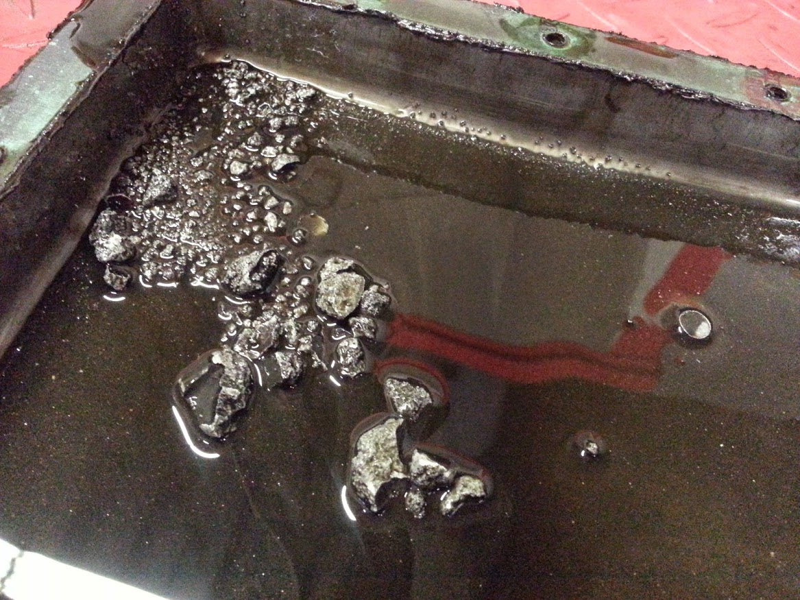

	  Coming out of retirement????dave41855 replied to dave41855's topic in Antique and Classic Mack Trucks General Discussion Oh well AZB755V8, it was a thought!! Anyway, will stick to what the original is. Meanwhile, back in the oilpan, here's what greeted us after we dropped it!! Nice little mess isn't it! Once we get the pistons out of it and get it fully stripped, we'll be able to tell if the cylinder walls are scored or not and then we'll know just how bad this really is!
	  Coming out of retirement????dave41855 replied to dave41855's topic in Antique and Classic Mack Trucks General Discussion Well kids, we pulled the old girl into the shop and started the tear-down. Took off the hood and removed a lot of the small stuff off the motor and stopped there. Yesterday he drained the oil and dropped the pan. Inside the pan was quite a few little chunks of metal. Upon closer inspection, he found the #5 piston itself has begun to break apart and also the connecting rod bearings are toast. Haven't seen the chunks- yet but will today and get some photos. Glad I didn't just dive in whole hog. After we got the hood off and sat back enjoying a good hot cup of coffee, we both started to chuckle. He says "I know where there is a good ENDT866 that would fit in there real sweet like..:-) Would an 866 be capable to push 525hp out of it???

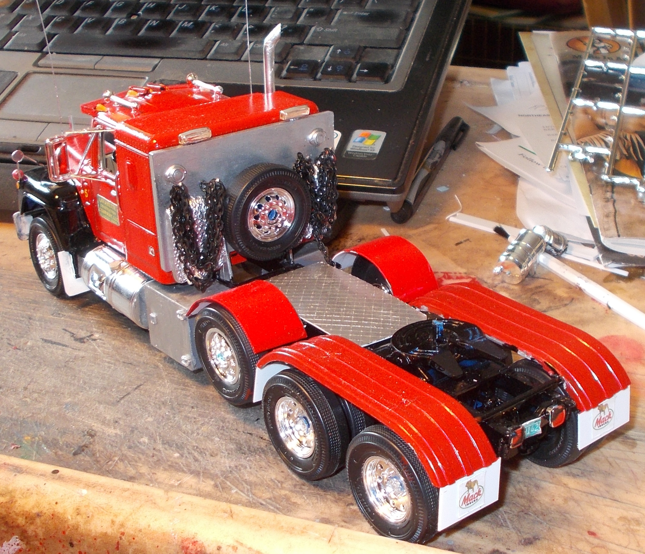

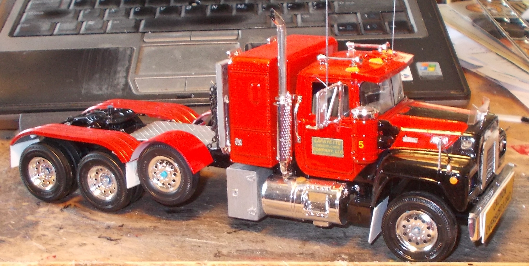

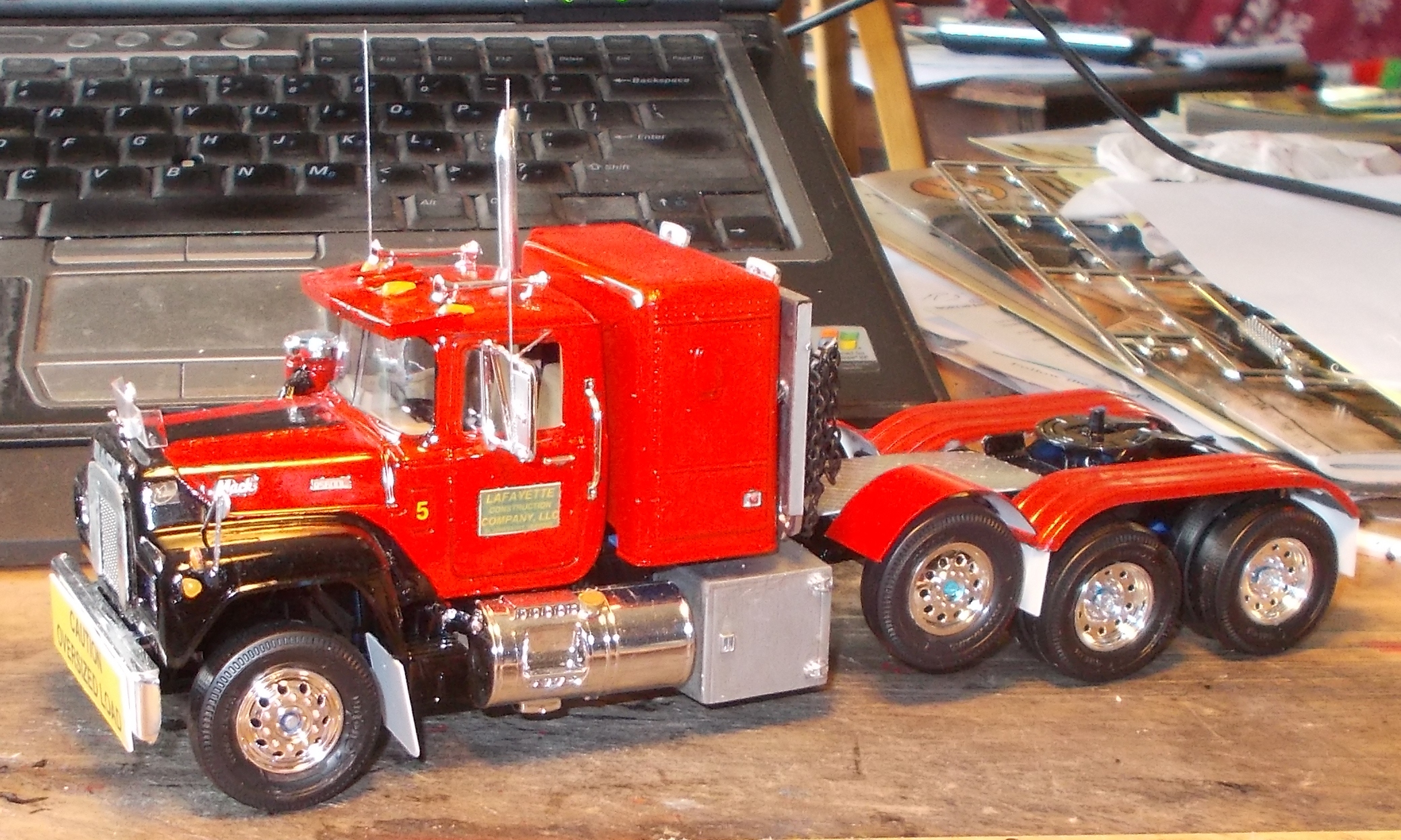

	  Mack RS600 Valuelinersdave41855 replied to dave41855's topic in Antique and Classic Mack Trucks General Discussion Thanks kscarbel2, I had come to think of the same thing. I've been doing a little research on them and there IS a considerable difference between them. That "E8" is what I had been mistakenly calling the 866 V8 motor. What started this all is that I had to build a model of a Valueliner for a customer. Here's a couple of photos of the model.

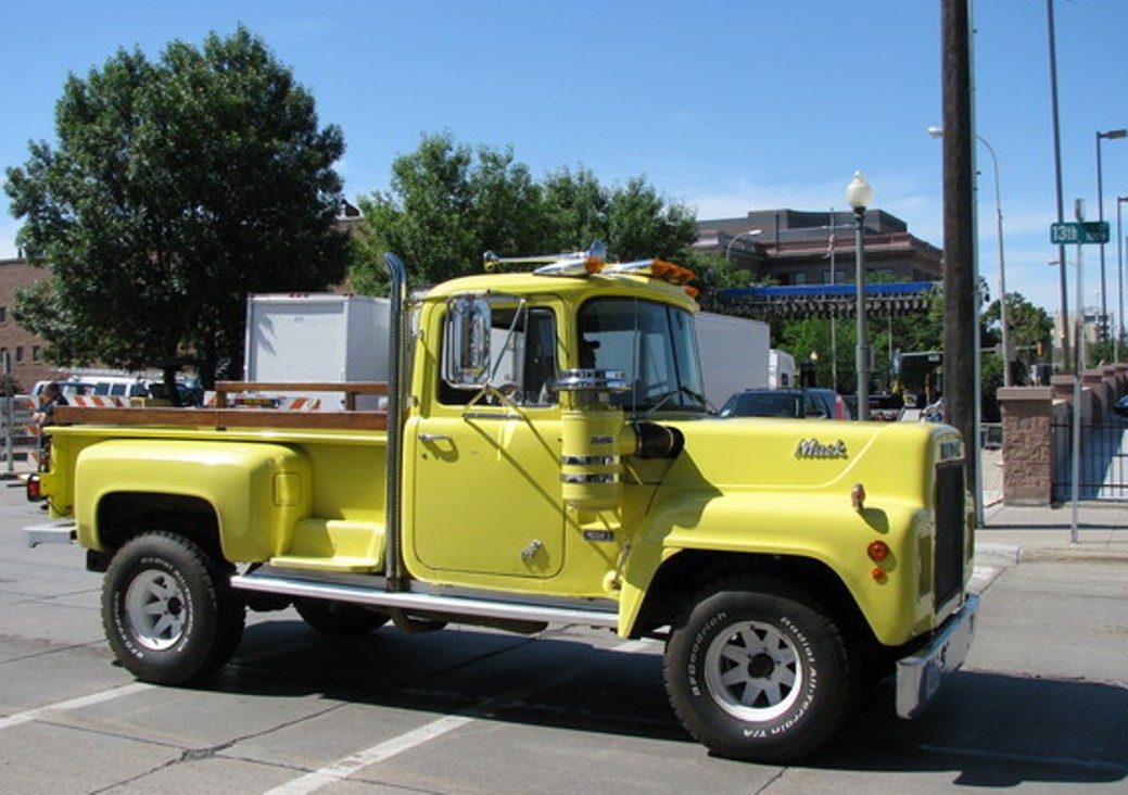

	Daddy, will you buy me this for Christmas?? Huh?? Please??? Pretty please?? I promise I'll be good all next year............ Would something like this be just a blast to run around in?? Old Mack cab on an old Chevy/GMC pick-up chassis. Even has a diesel under the hood too! Wouldn't that look sweet to pull my 5th wheel camper with......

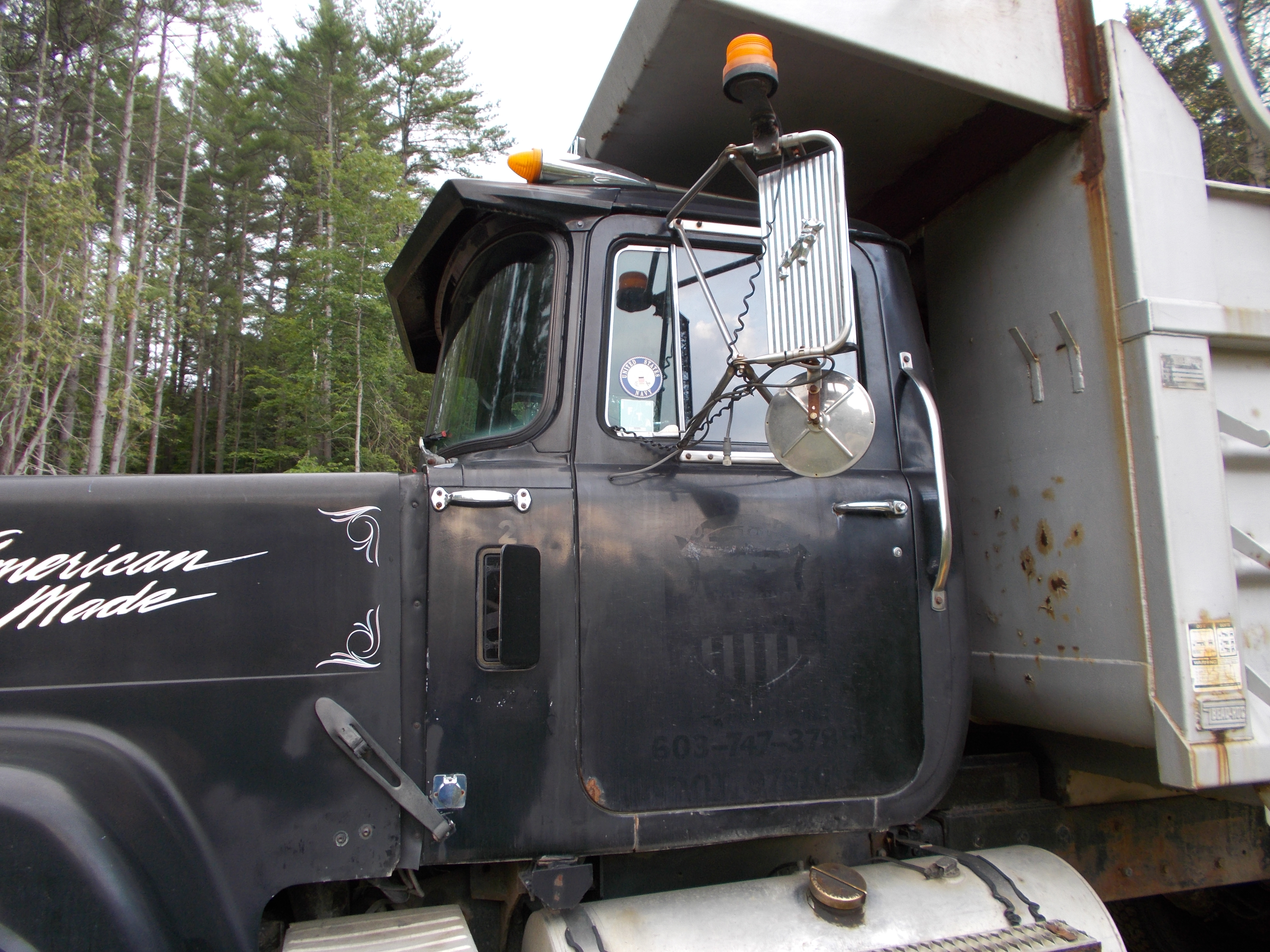

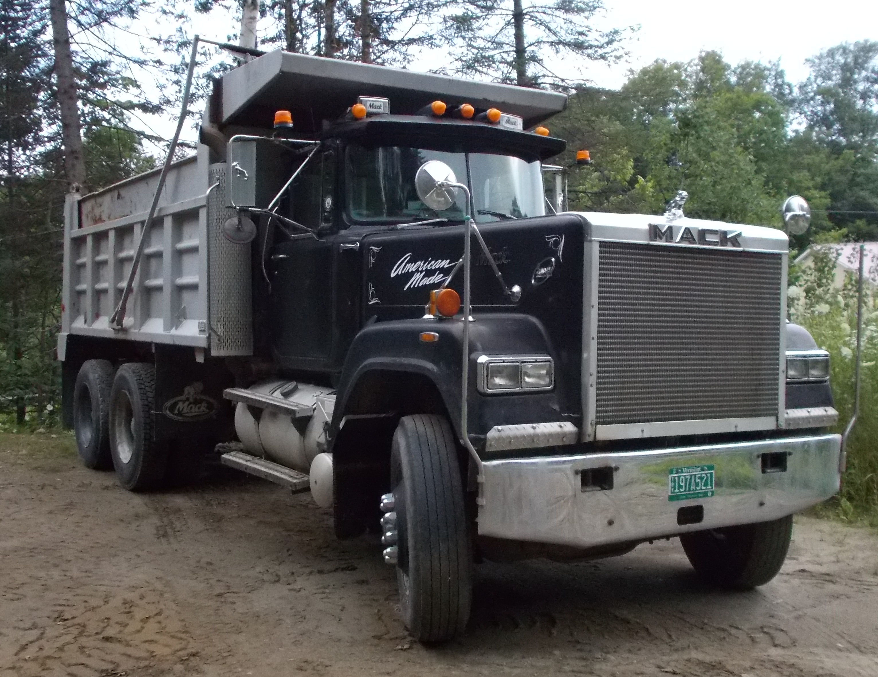

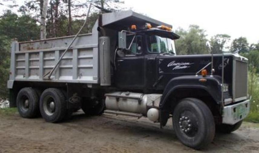

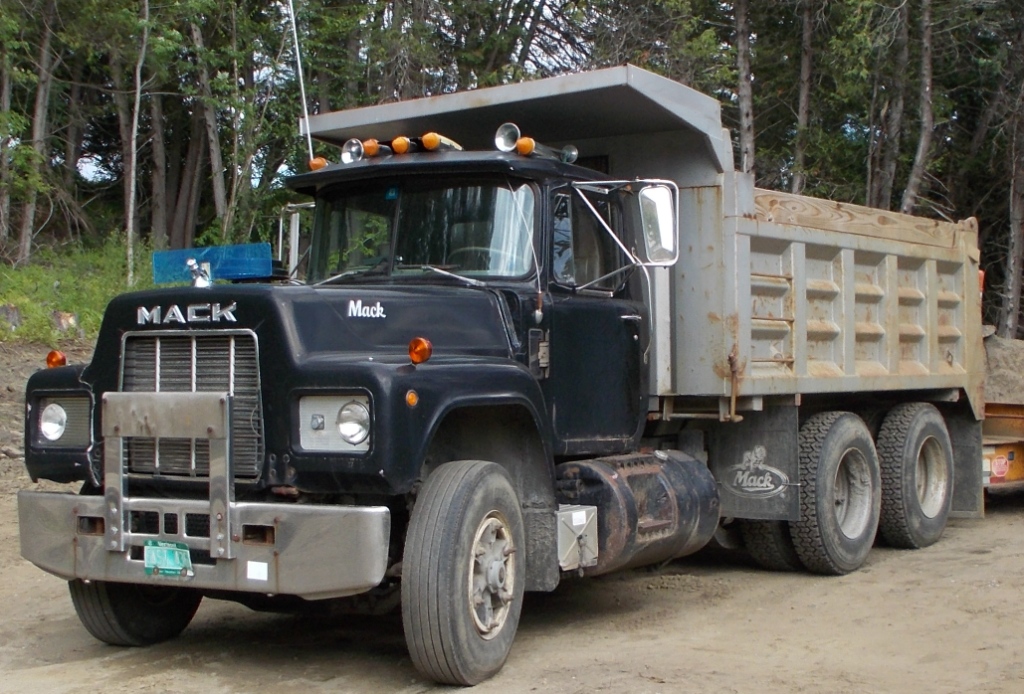

	Not sure if it will happen, but, there is the possibility that I just might come out of retirement. The man who now owns my old Mack wants to sell his Superliner dump. It needs work. Cab mounts are shot, cab air bags need replacing, turbo is getting tired. The cab itself is quite solid as is the hood. Basic chassis is also in good shape. Dump body is rather sad shape, but that's ok by me as if I do buy it I'll put a 5th wheel on it anyway. I figure $5000 as she sits right now ain't bad, and, I'm thinking about $5000 more and it could be all rebuilt. What do you guys think?? Dave
