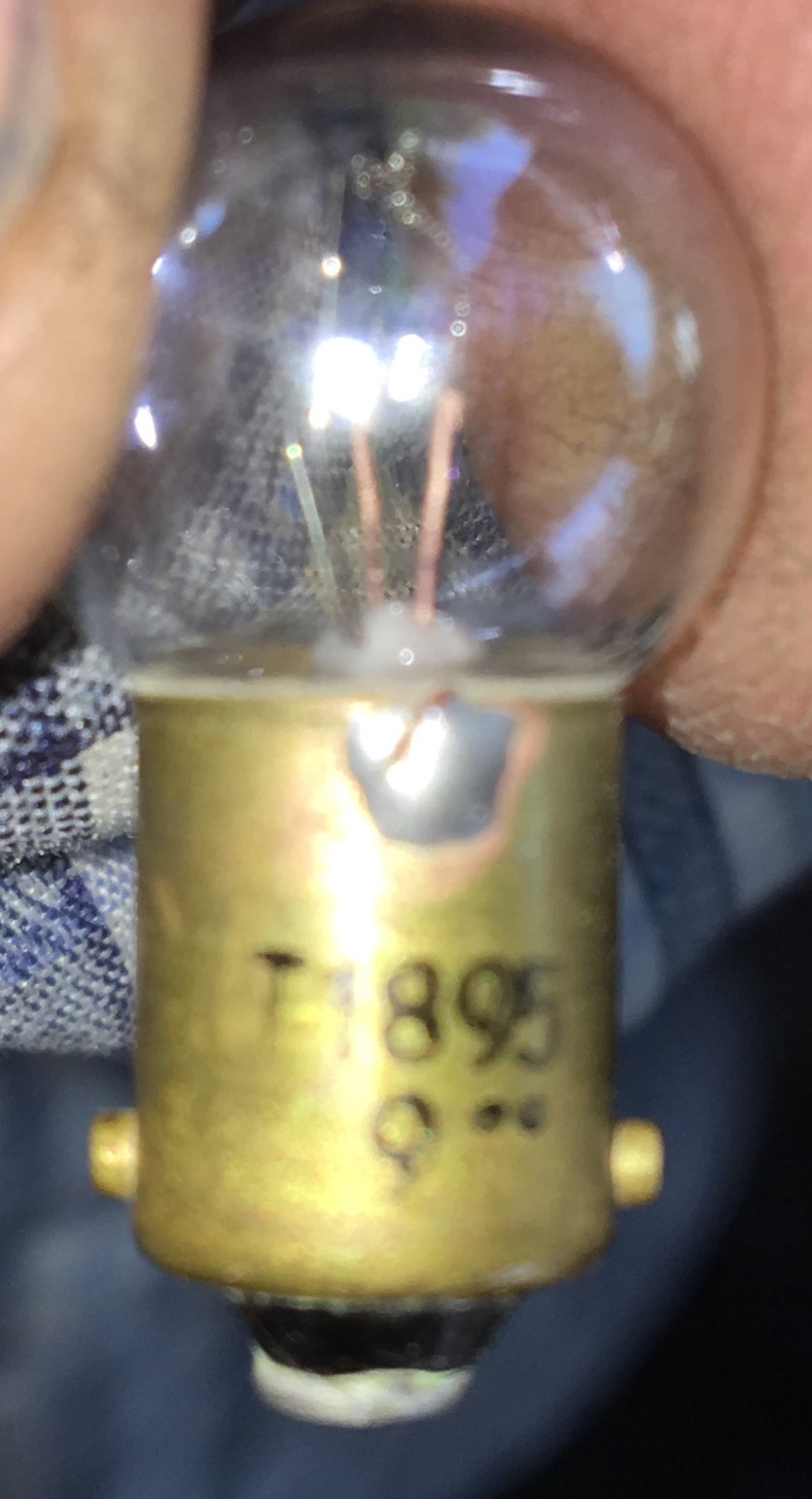

  2. I don't know if this will help, however the bulb that is installed to light up my tachometer is a T1895.
