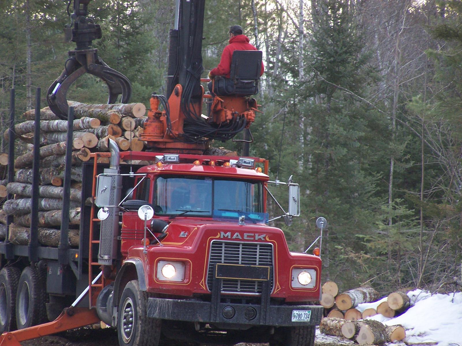

  14. Early 70's r model i believe had a double frame and wasn't a converted tractor. Haul 80,000 for 40 years and bones are bound to break. I got info second hand.
  15. Think this old R model might need some frame work.
