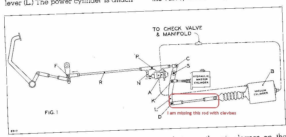

  13. I have a recently aquired 1942 Mack LS type 80 with vacuum assisted brakes. While investigating why this rig was so hard to stop I have found that I am missing the linkage that runs from the vacuum assist cylinder near the rear of my truck to the “power lever” near the master cylinder. Do you have – or do you know where I might find this linkage ? Also - Does anyone have or rebuild the vacuum components if i find they are unusable ? Finding the linkage is Job 1. I have attached a diagram showing what I need.
