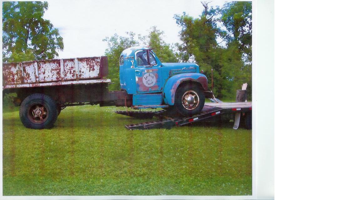

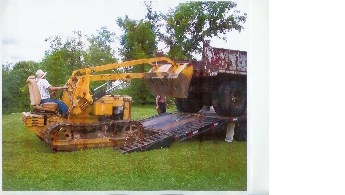

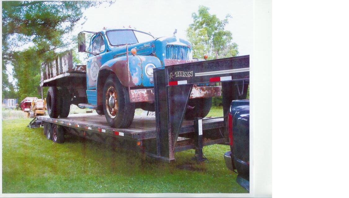

  8. I got the B-30 home last week. Here are a couple of pics my neighbour snapped while offloading. We are about 30 feet short of home in the pics as we had to bring the truck in across my neighbour's lot because the 66' x 132' lots in my neighbourhood leave a bit to be desired when maneuvering a truck and trailer rig of this size. Because the B-30 has absolutely no brakes, I used my 1957 JD 420C loader with close couple chain from bucket to pintle hitch to unload the truck and pull it over into my lot. The truck came straight off the trailer and onto my lot with no one in the cab. Looks like the rear cab mounts need replacement/rebuilding. The tractor is what inspired me to get my butt in gear and find an old truck to haul him. The crawler loader just did not look right sitting on the float in the pic being hauled by my '05 RAM 2500.

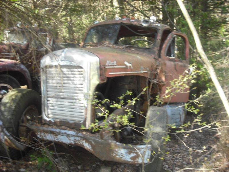

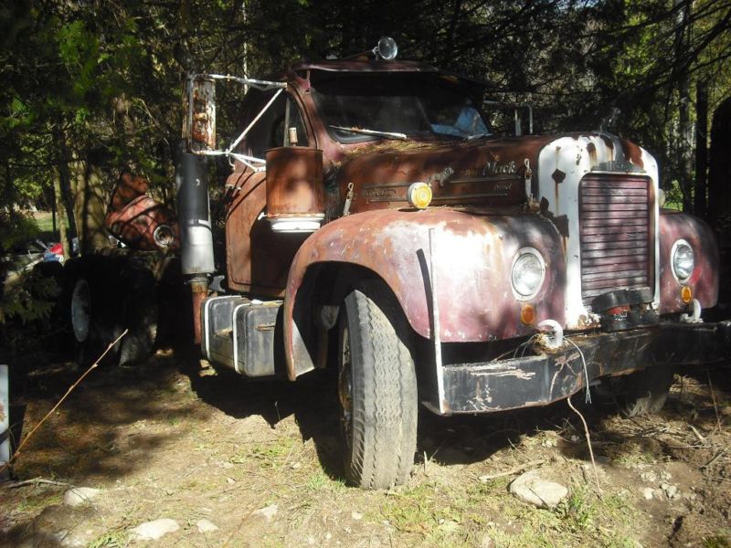

  13. I am not a particularly religious fellow but I think somebody is testing me again. Old Macks are popping out of the bushes. Today's fare is two 1966 B-61s w/673 Thermodynes. One has a 5-speed triplex and the other has a "14 speed" - not sure what that is. One has been pretty well stripped the other seems quite complete and in reasonable condition. Both look like single axle tractors but pics are not clear enough. $4000 CAD for the pair. I am thinking half that might be more realistic. A B-61 is not in my plans but thought I would let you guys know. I am picking up a crawler in the vicinity of those trucks and could collect info if someone is interested.
