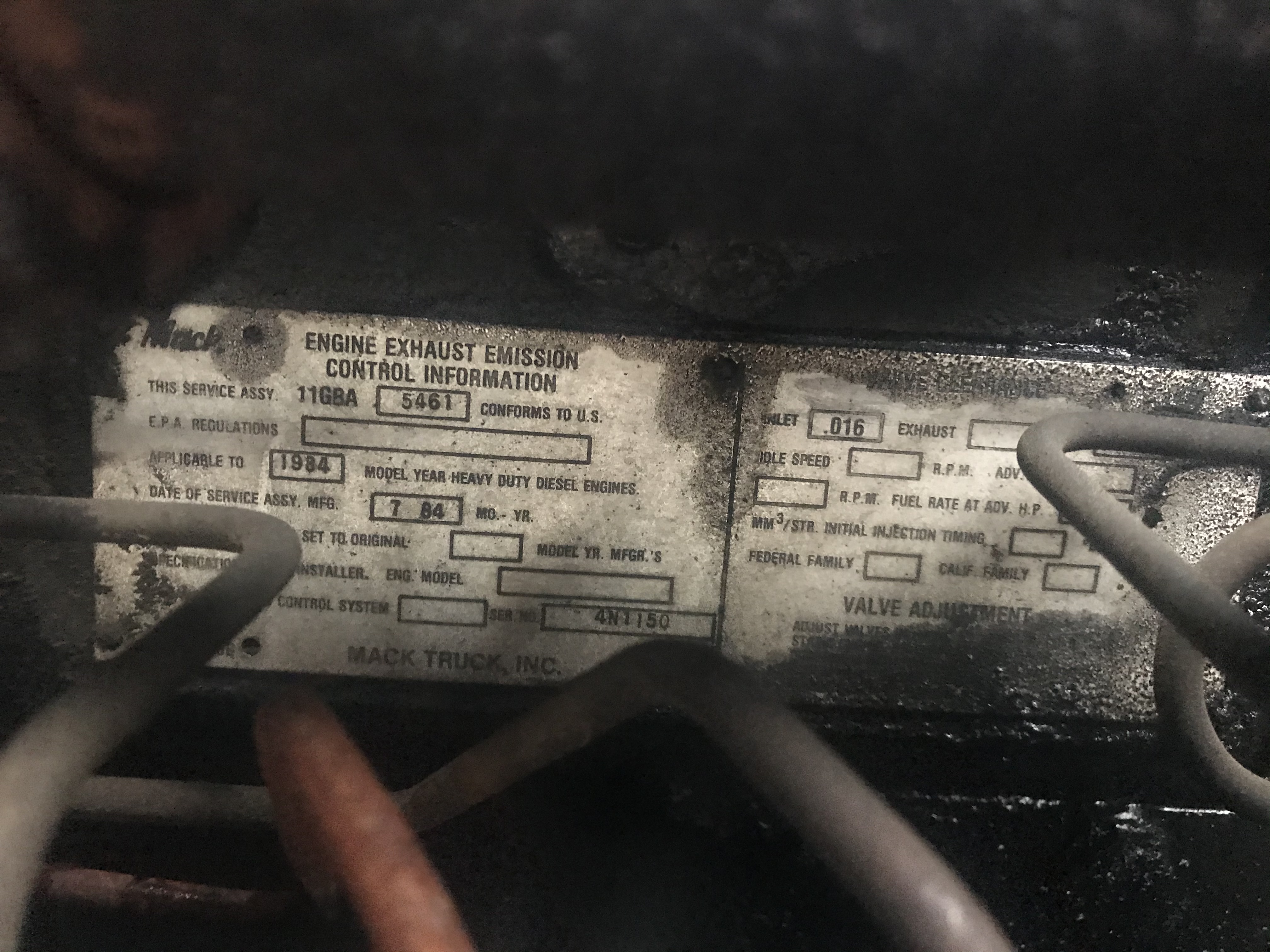

  1. Hello Forum, I recently acquired a 1980 U model single axle dump. it is in excellent shape. I plan to use it on our farm and property up in potter county Pa. my question is... can I get a hale brake kit offered by an aftermarket co. To fit this engine.? Here is a pic of engine tag.
  2. Hello Forum, I recently acquired a 1980 U model single axle dump. it is in excellent shape. I plan to use it on our farm and property up in potter county Pa. my question is... can I get a hale brake kit offered by an aftermarket co. To fit this engine.? Here is a pic of engine tag.
