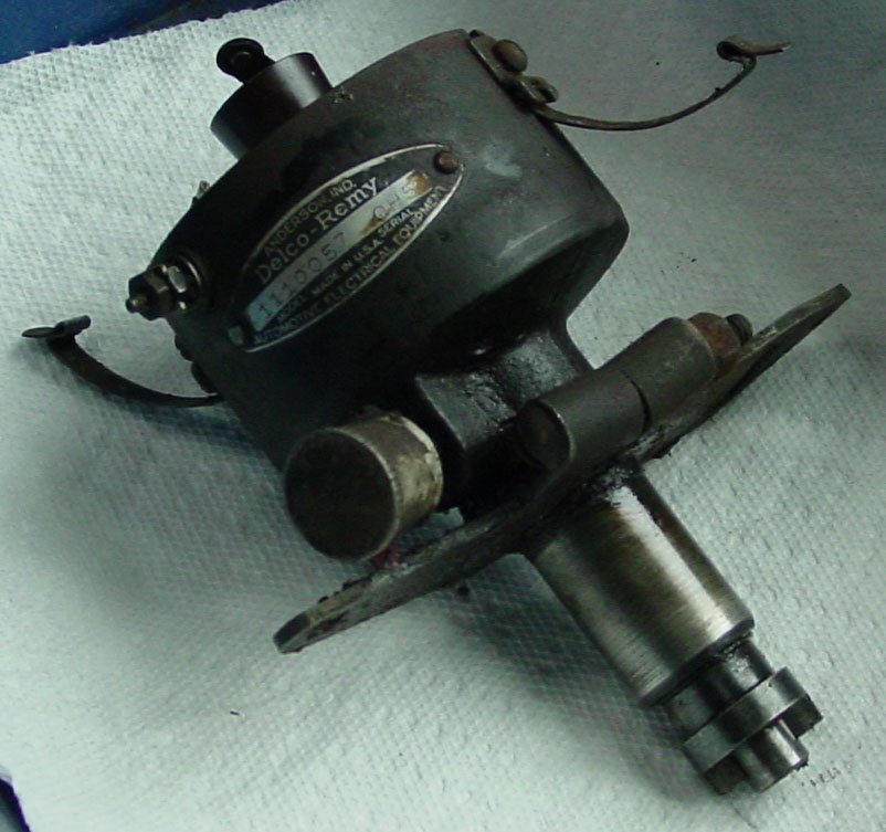

  3. Here is the pictures of the distributor, I took it out between rain drops. As you can see it is easy to put in the wrong one. The gears are in the lower pedestal which connects the tachometer and oil pump. The firing order is correct. When the rain stops I will do a compression test. The advance does advance clockwise opposite the counterclockwise rotation.
  4. When Im looked up my delco dist number in the motor book. my number 1110057 is listed as a clockwise rotation. The book from the Mack museum on my truck calls for a counter clockwise rotation. I pulled the cap off and cranked the motor and it spins counter clockwise.
  5. Upon researching my running problems I found out that thr distributor in my motor is one for a clockwise rotation not counter clockwise. Any one know the correct one for my 41 type 45 with a EN-330 motor Fred

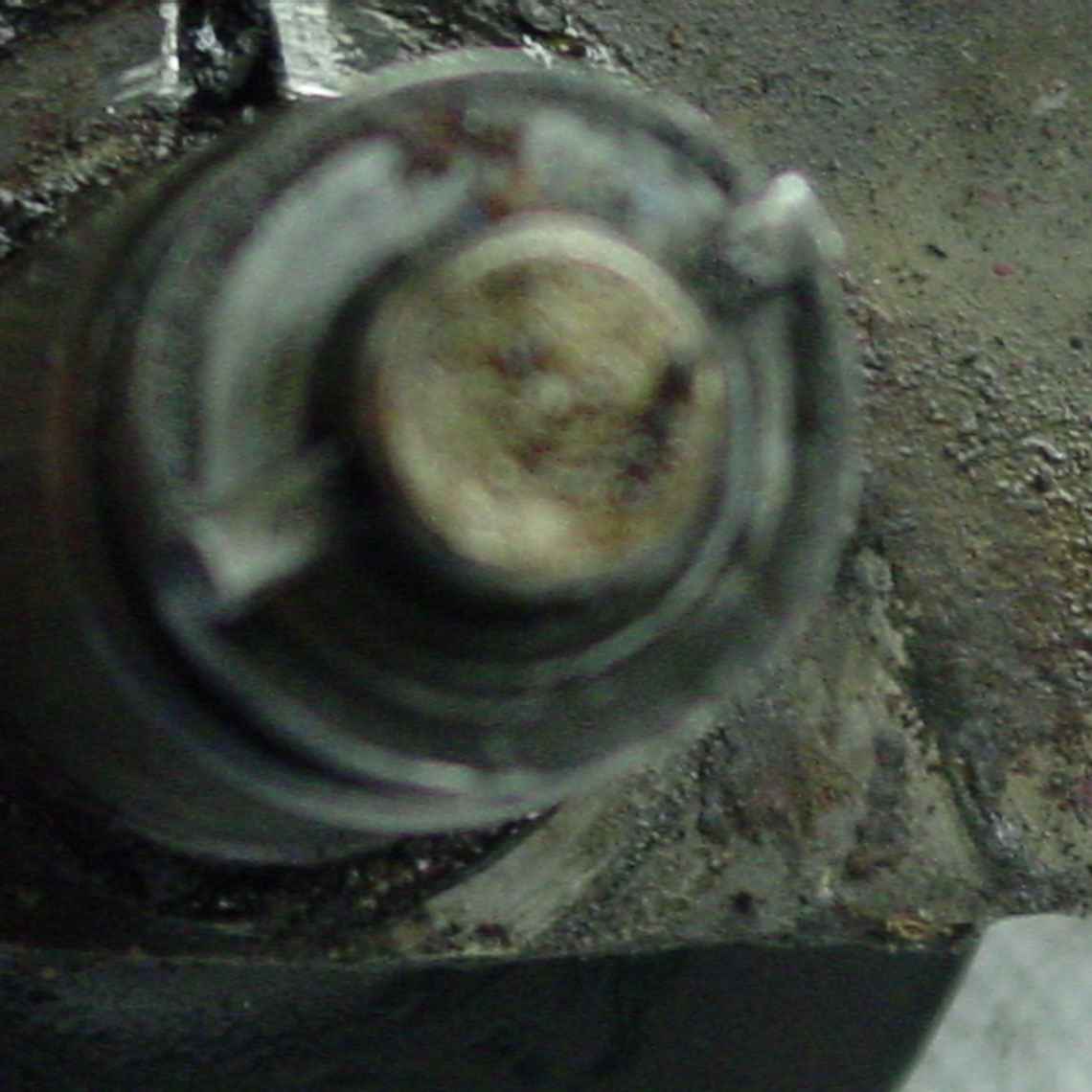

  18. It is the one down at the pump that says prime, neutral and pump. It snapped off 1" before the slider. This one looks like it is cast instead of steel. Looks as though the metal fractured, the metal looks porus instead of being clean. He rebuilt the motor from another oneand installed it. Sounded great, I just need to tune it up with new plugs, cap and rotor. Any help would be great. Fred
