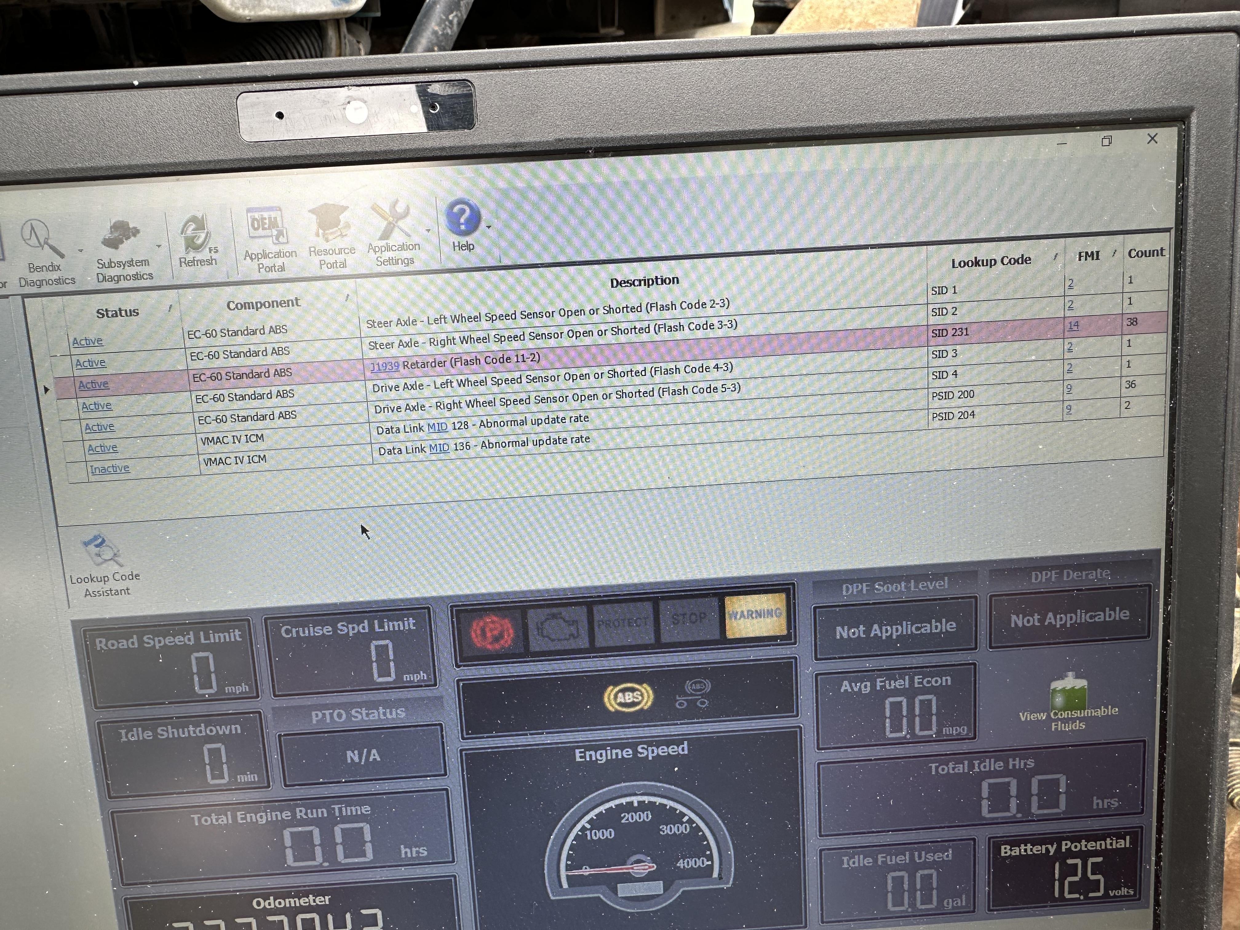

  11. Well guys I got it hooked up and it’s not looking good. No hours on the hour meter and it has communication codes. This is classic of yet another burned ecm. Does anyone know why this truck keeps burning out ECM’s? ill do some more diagnostic on it later today when I have time just to rule out other variables, but im pretty certain its got a bad module.

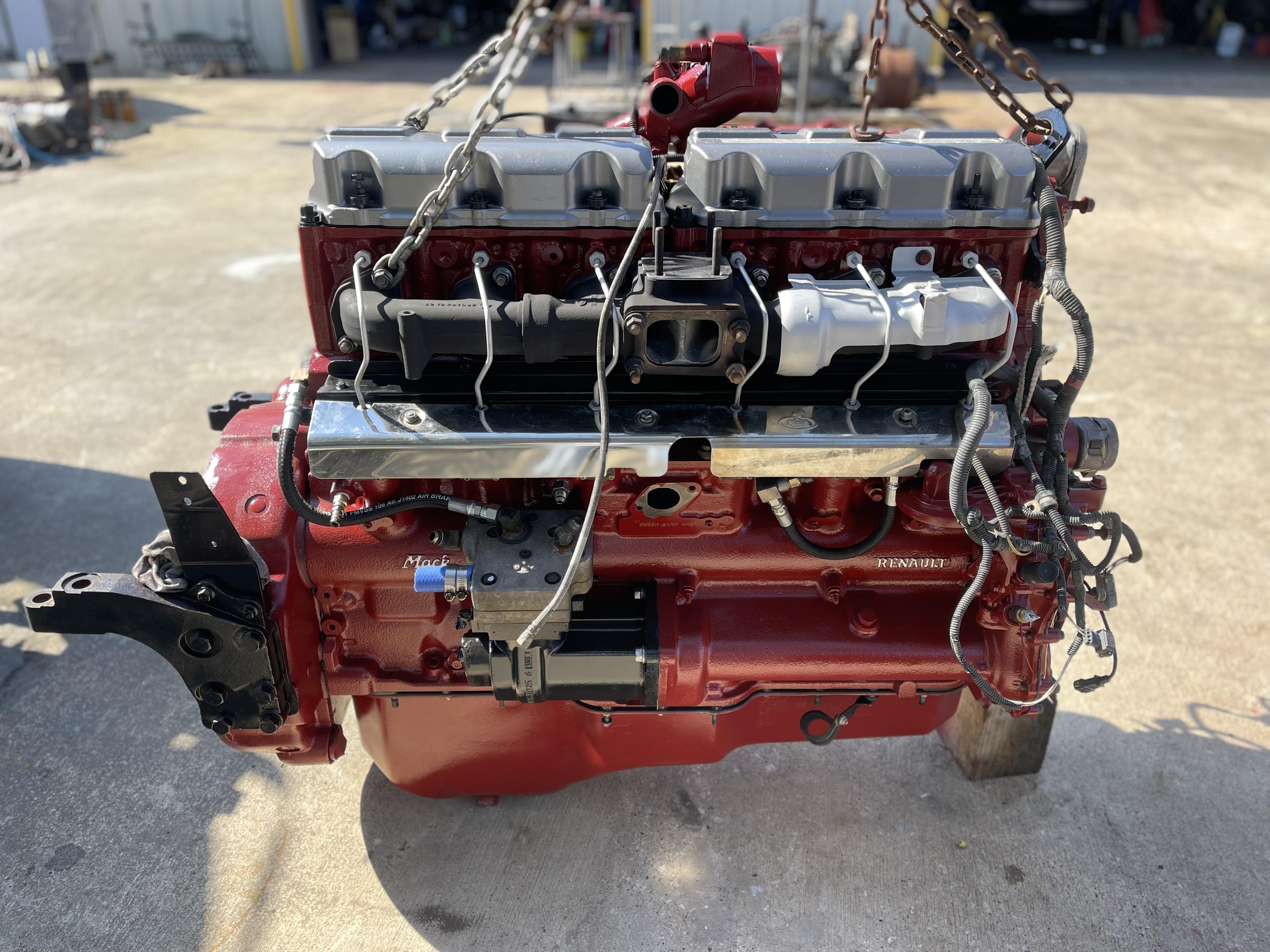

  13. Hi, this was our truck. It was such a problem child at first but then we got it worked out and fixed, this was some time ago.. Long story short the truck had a burned out fuse for the Allison trans behind the passenger side kick panel, the wiring harness bulkhead had damaged pins, the ECM was burned out, and it had bent push rod tubes. Once we found out it had bent pushrods, we then found out it also have cam damage and knocked out H-rings for the lifters. We ended up replacing the whole engine with a low mileage one we got lucky and found nearby to us.
