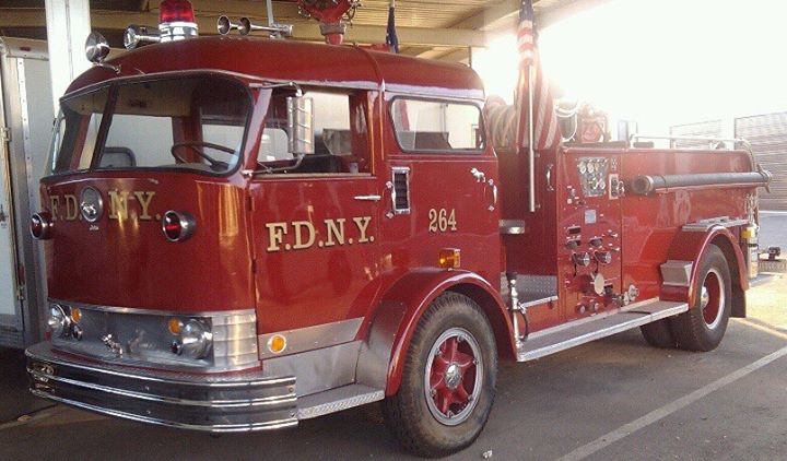

  4. I have a TR671 transmission in a 1958 C85F. For those not familiar, it's a cab forward fire engine. Need an in cab shifter boot for it. The shifter is not over or on the trans. and attaches to a long linkage.
  5. Looking for a thermostat for this engine. It's in a 1958 C model fire engine with a single distributor. I just plugged off the auxiliary cooler system from the pump that's inoperative anyway. I'm going to have the radiator removed and gone through as after about 10 minutes of driving ot climbs to the 210 degree range.
