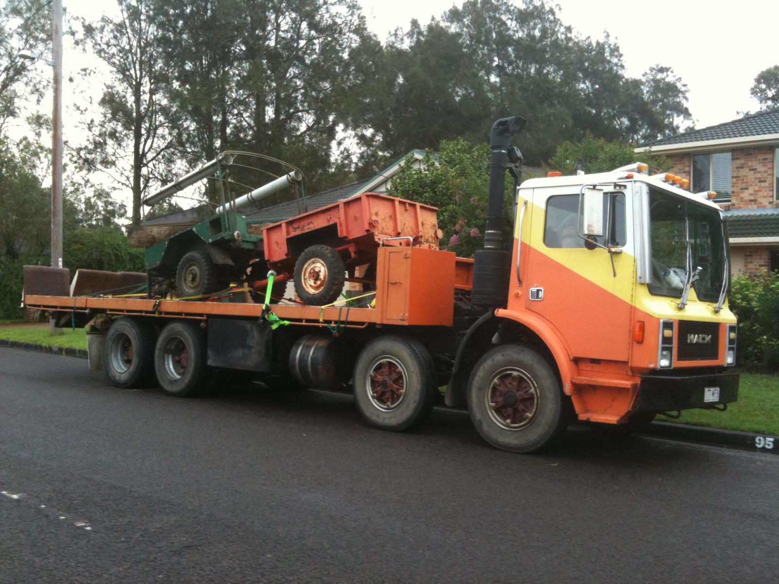

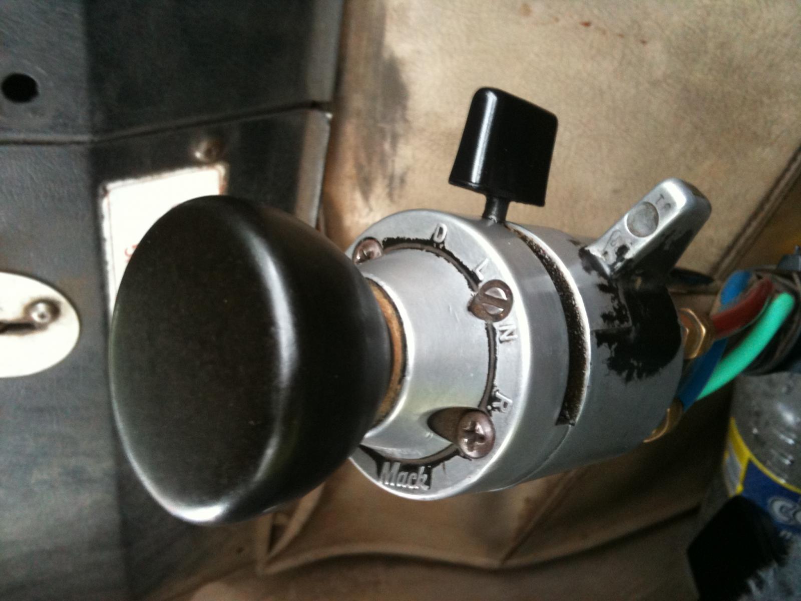

    3

  2. Thanks for the input everyone - Lmackattack, if by "passenger side" you mean the left hand side when viewed from the rear (here in Oz we are not just Down Under, but also Ass About), then yes I can definitely see what look like injector heads. I also read elsewhere in the forums that the greenish blue paint is a 2V giveaway. I reckon you're right about it being a 6 speed with a split only in 1st on the main - I can actually drive it like a splitter all the way to top (and back) without gnashing any teeth, but the timing is so critical to flick the split with revs and clutch all lined up I can't see the idea being sellable to any but the most enthusiastic knob jockey. Kudos to a newbie with only 15 hrs experience on a crash box I guess. The PTO also looks like it comes off the lower countershaft at the back of the box just like you said. Once again thanks for all your help.
