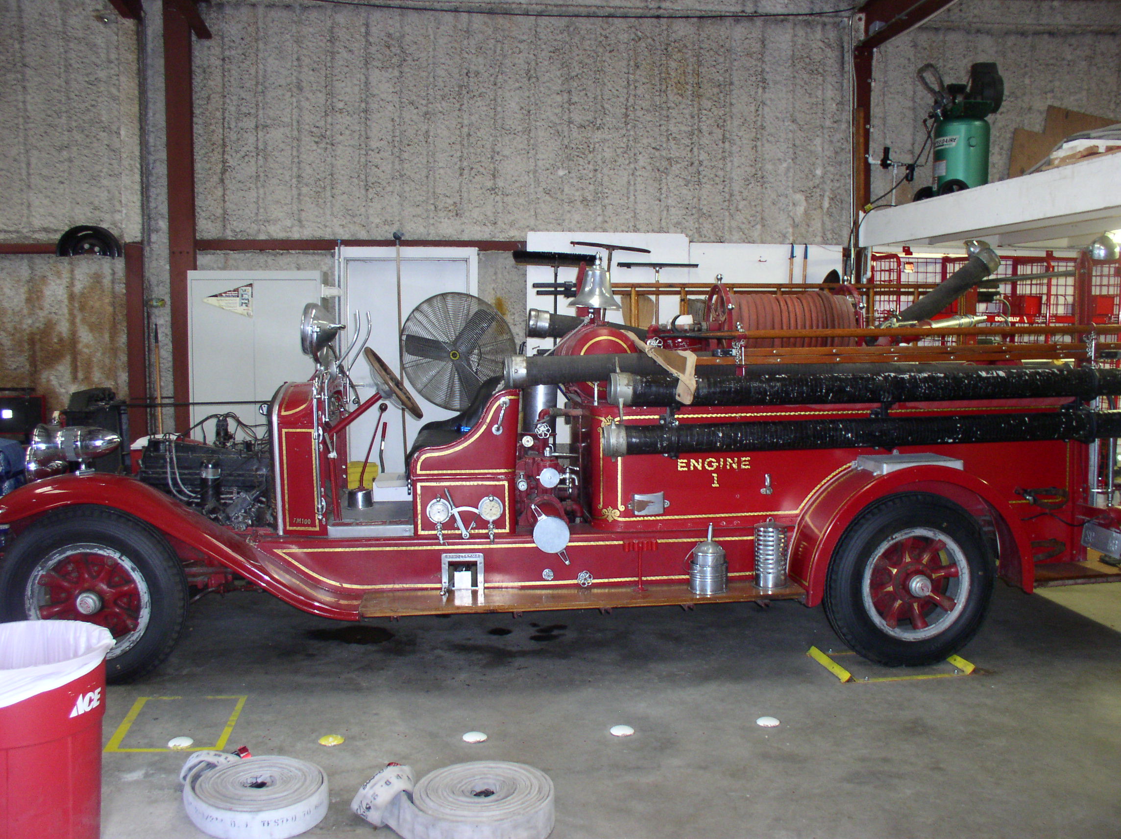

My local fire department has what they believe to be a 1929 modle year Mack Firetruck. Nobody seems to know much about it. They used it in the past for the local Christmas parade but it has not run for about three years. I won't bore you with the long story about why but I've committed to helping them get this thing lit off again.
Apparently, it had a leaking water pump and carb. They managed to get these components rebuilt and recored the radiator. Someone lost the gooseneck fitting for the thermostat housing and they need another one to get it running. Where do I go for this?
The truck appears to be a Type 90 fire truck (found a copy of the Mack Corp.'s 1929 annual report that ahd a pciture of the various trucks it sold at the time and the Type 90 seems to be what we have). The name plate located under the dash reads as follows:

I am not a member of the fire department here and in no way affiliated with it. The truck is in very nice shape for an 80 year old truck (sevicable paint, no corrosion that I could see, appears to have always been kept under cover, nicw seats, all of the pumping gear and the tank). Apparently the fire department is becoming frustrated with the lack of progress on getting it moving again and has sugested getting rid of it. I'd hate to see this happen so I offered to help out, My current restoration projects are a 1929 Farmall Regular tractor (my father suckered me into this one), a collection of 1948-50 Ford trucks, a 1979 BMW MC, and 1960's vintage Model T Shirners Mini Car. I need this Mack project like I need another hole in the head but lthis ooked like such an easy job to get it back on the road that I agreed to it. Any help would be very much appreciated. I will try to get some photos tomorrow.

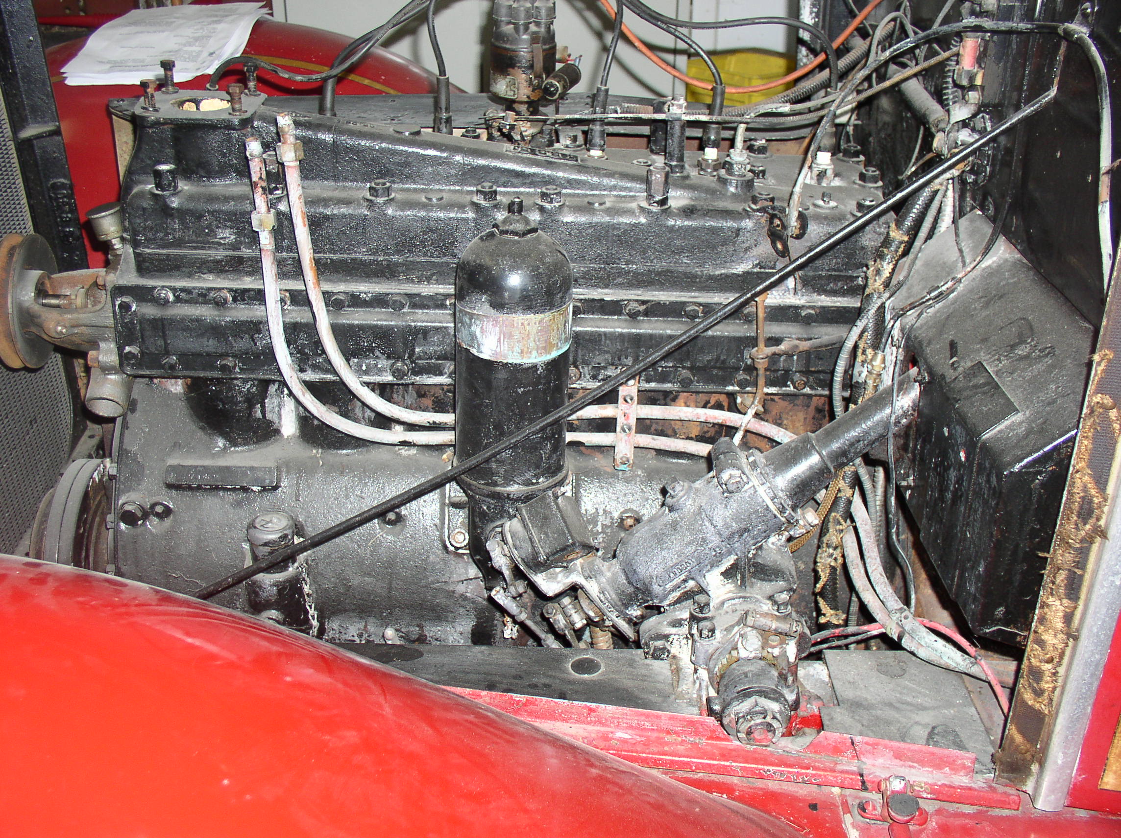

I found a number stamped into a flat boss on the engine. It reads : BG7-82 Not sure if that will mean anything.
I have photos but not yet certain how to post. The truck is in excellent condition for being almost 80 years old.

The engine number BG7-82 looks like original
The engine is a Mack 6 cylinder, L head design with dual iginition
You should have a type 50 with a Chassis BG was an 80Horsepower 500GPM Hale pump,
From the pictures the truck looks like it is in excellent condition.
