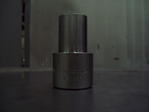

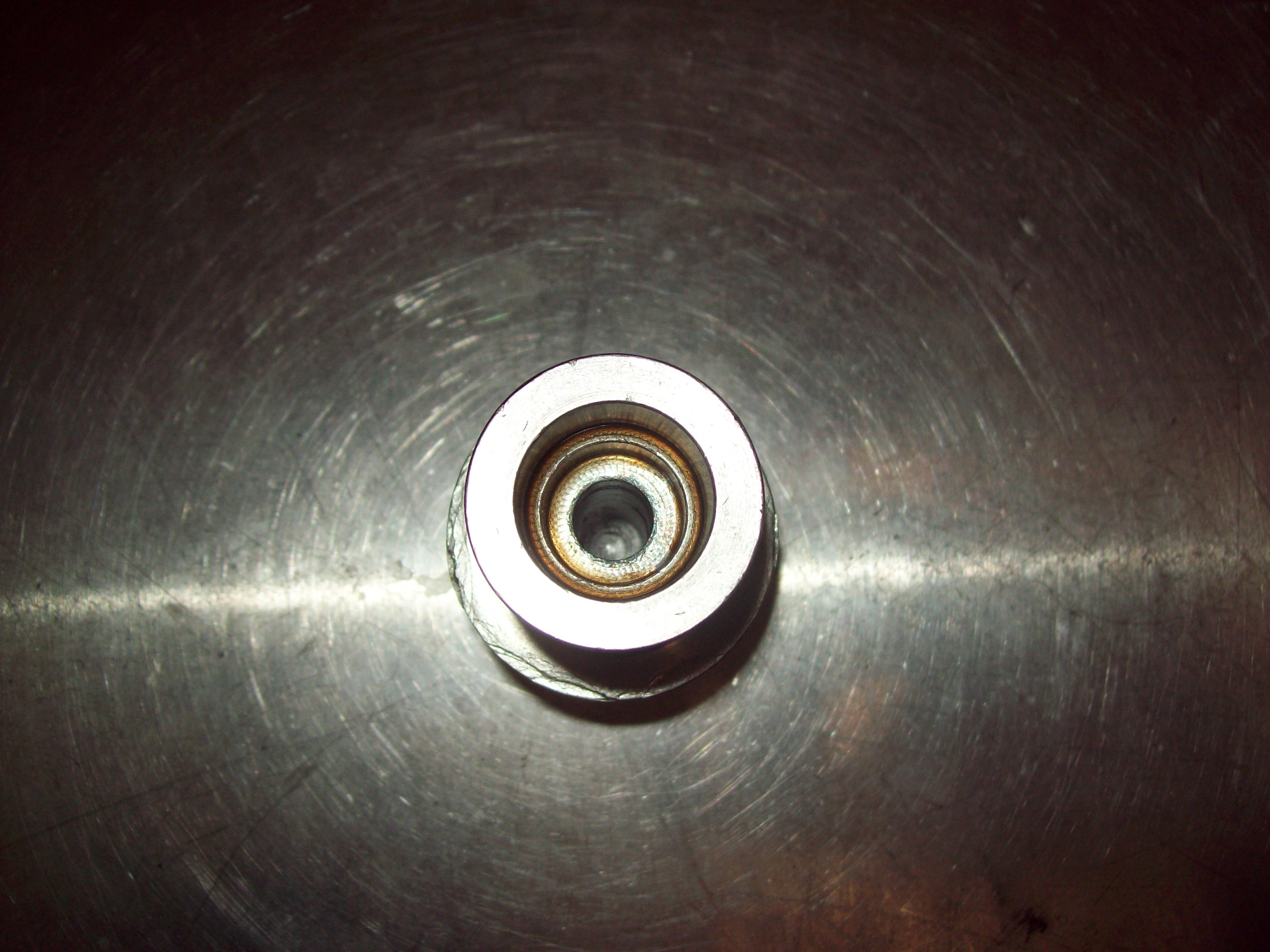

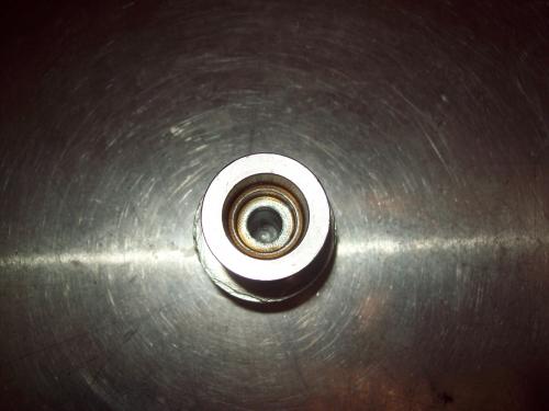

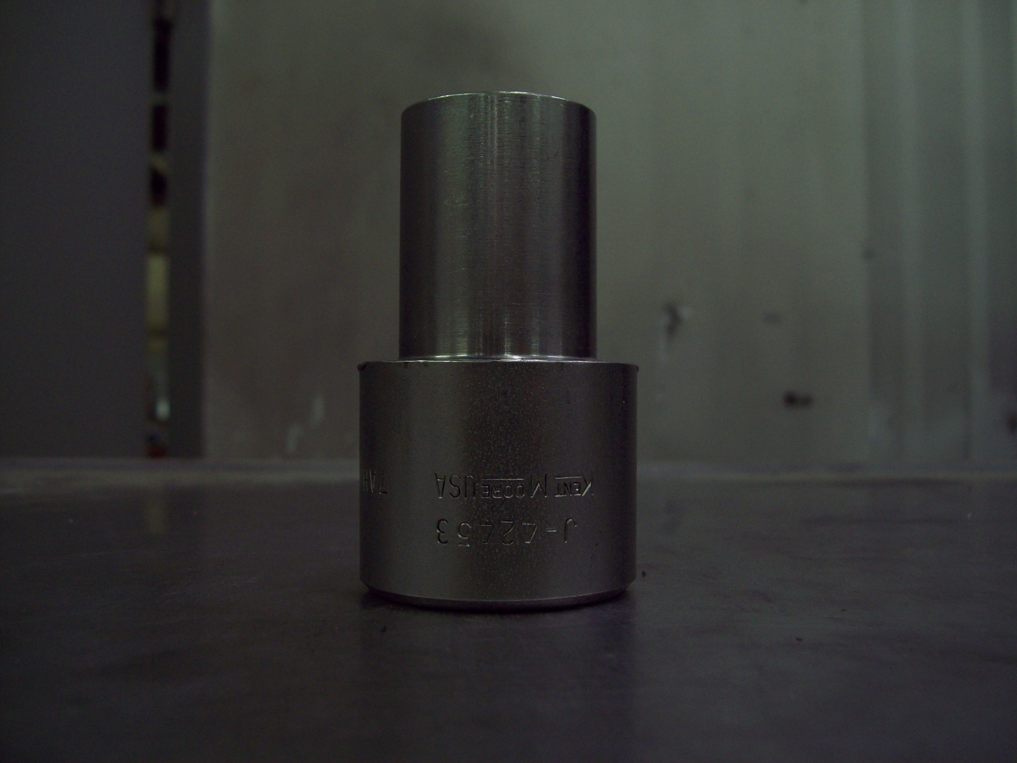

Here are a couple of pictures of tool J-45423, one from the side and one from the bottom side (where the seal fits into the tool)
post-6084-0-65107800-1297735982_thumb.jp
post-6084-0-75777500-1297736011_thumb.jp
dimensions are as follows:
Overall length-3.000"
Large OD length-1.425"
Small OD length-1.575"
Large OD-1.750"
Small OD-1.250"
ID #1 (opening)-.818"
ID #2 (middle opening)-.650"
ID #3 (lowest opening, valve stem pilots into this bore)- approx. .375"
Valve stem pilot hole depth (from end of tool opening to bottom of bore)- 2.512"
ID #1 length (length between ID #1 and ID #2) -.486"
ID #2 length (length between ID #1 and ID #3) -.786
