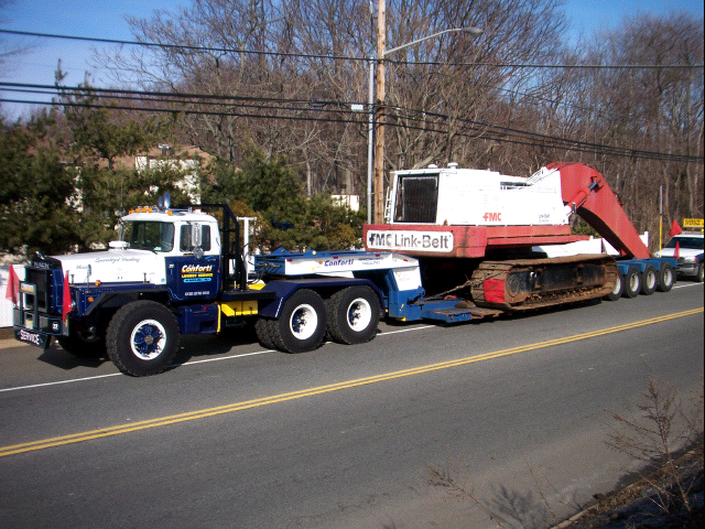

moving a 7400 Link-Belt excavator a few years back.

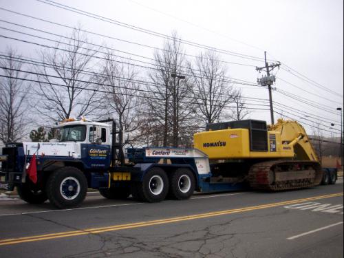

Moving a Cat 365BL excavator fully assembled when we could still do this sort of thing in NJ.

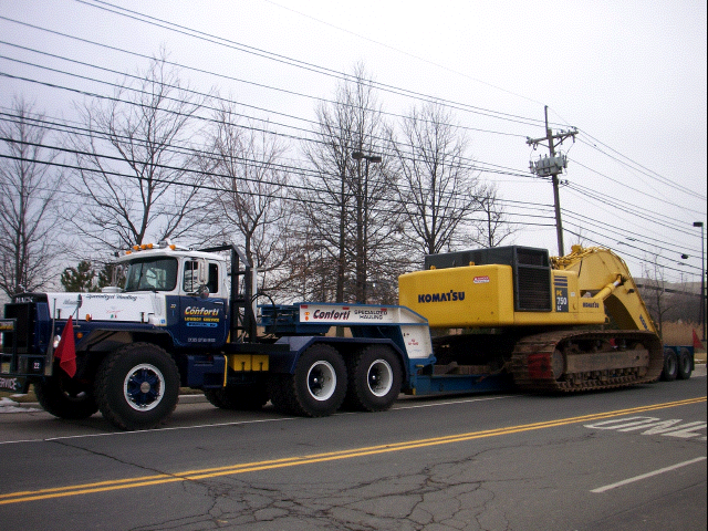

Komatsu PC750 on the 100 ton I-beam.

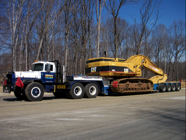

3900 Manitowoc crawler crane.
