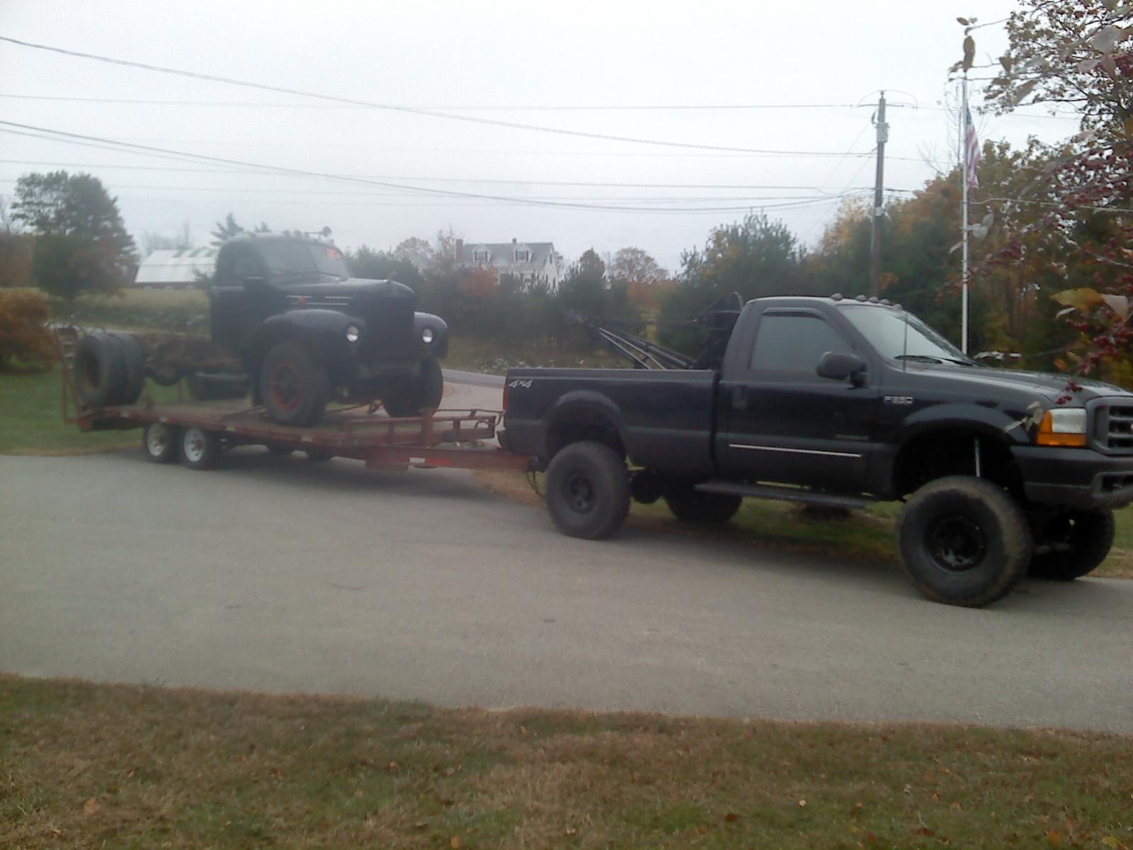

  2. Hello again drivers, looking for advice on what to do for a thermodyne Injection pump thats stuck at full throttle. I just brought the truck home, and the gentleman that I bought it from said it had sat for a number of years before he got it running, but it was stuck at full throttle. He got the linkage free and it still has the problem. Any help would be greatly appreciated, Alex

  8. I checked the APE number and you are correct on your number. The pump number reads 313G??110BB6
