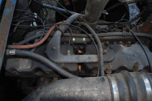

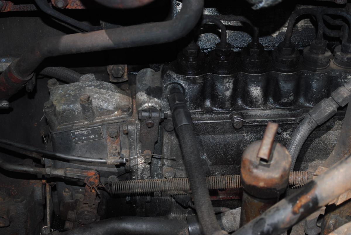

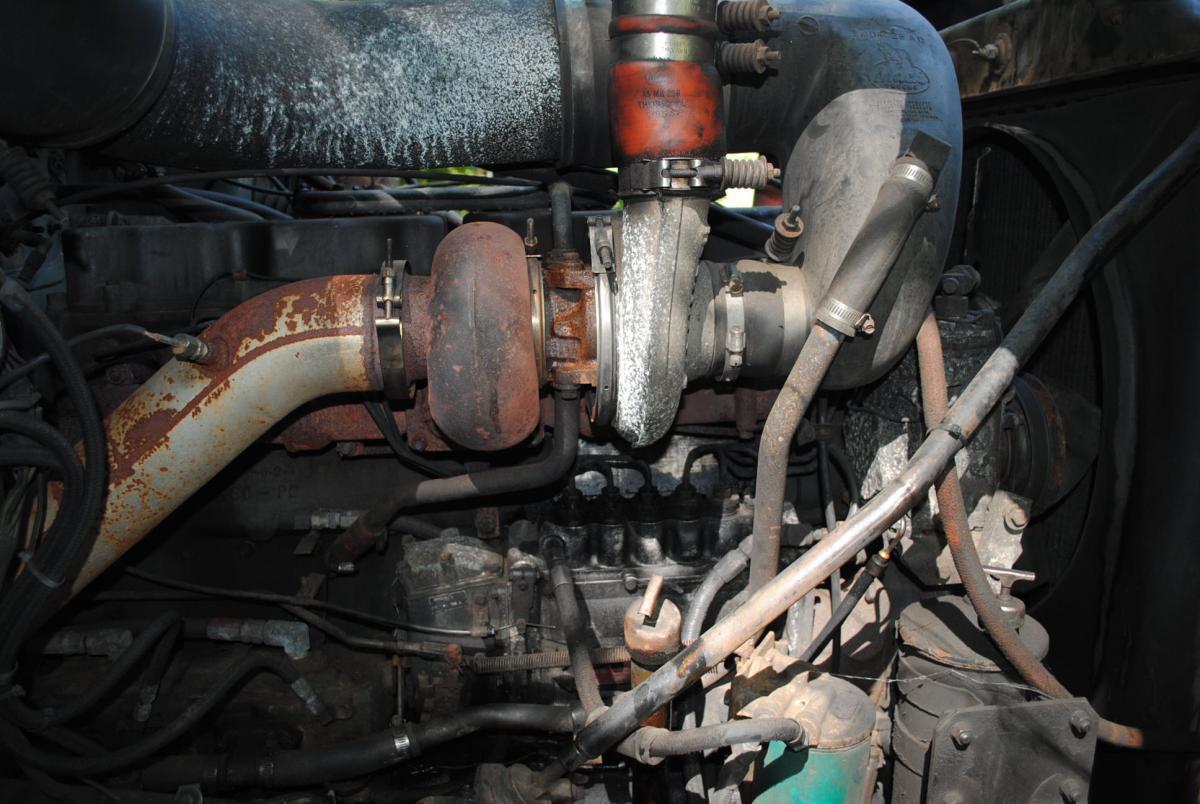

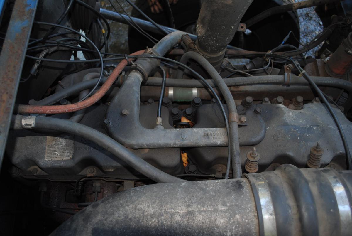

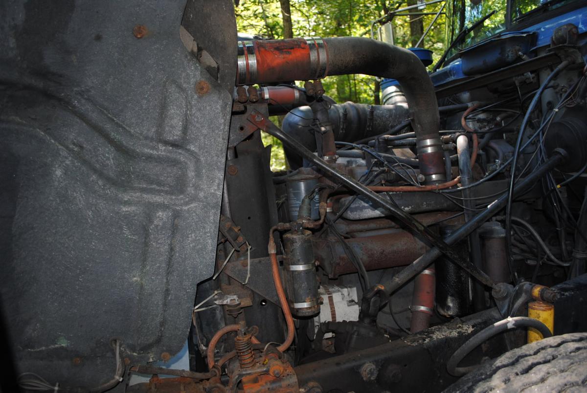

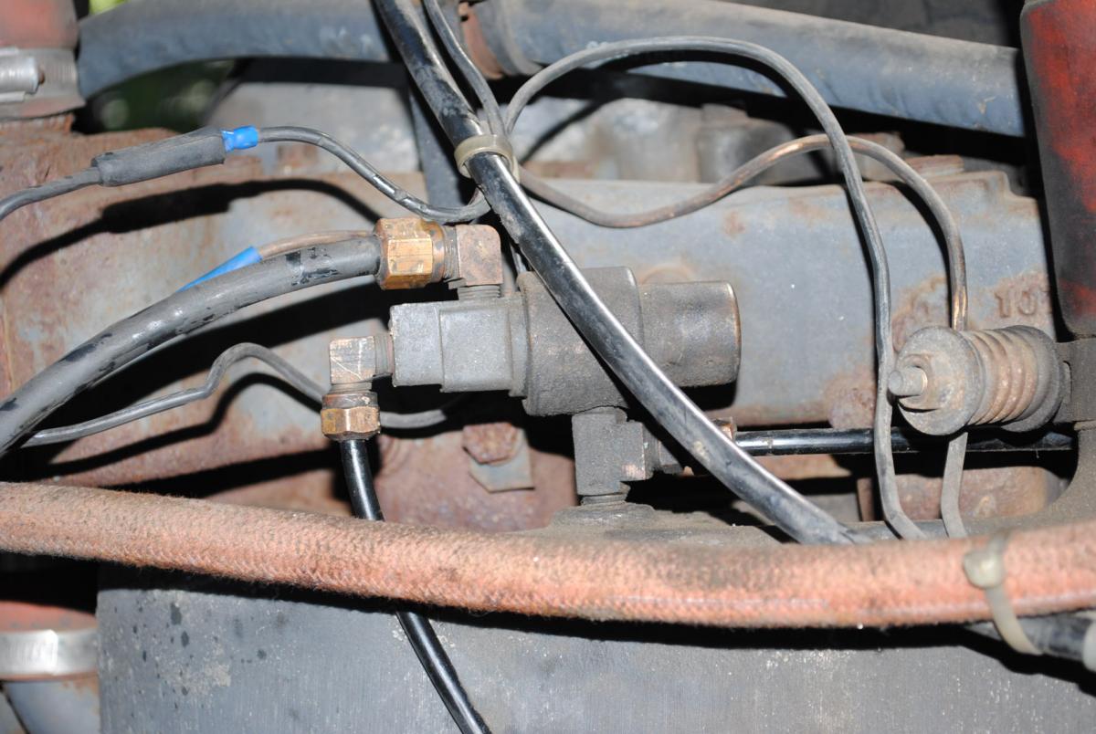

  6. Hi, I have a 1988 Mack R Tractor. I was recently cited for making excess smoke. The inspector had me hold the accelerator to the floor for several seconds repeatedly. The truck did appear to make undue black smoke. The man told me that it was probably the puff limiter. Looking the truck over I see that there is 3 lines on what I think is the puff limiter control valve. In testing them I find that one is energized with air upon releasing the brakes. The next line(going down to the injector pump) doesn't change upon starting truck, pressing the accelerator quick, letting off, or any other time. The third line looks to be going down to the transmission and simply hooked up to the intake along with the puff valve. My question is, when does the valve do what? I can only assume that when stepping on the accelerator I'm supposed to get air to the pump? can anyone explain or give me a schematic? Also can anyone tell me what the intake pressure should be on this truck. Thank you much Bill I'm attaching pics of the engine and of the valve itself
