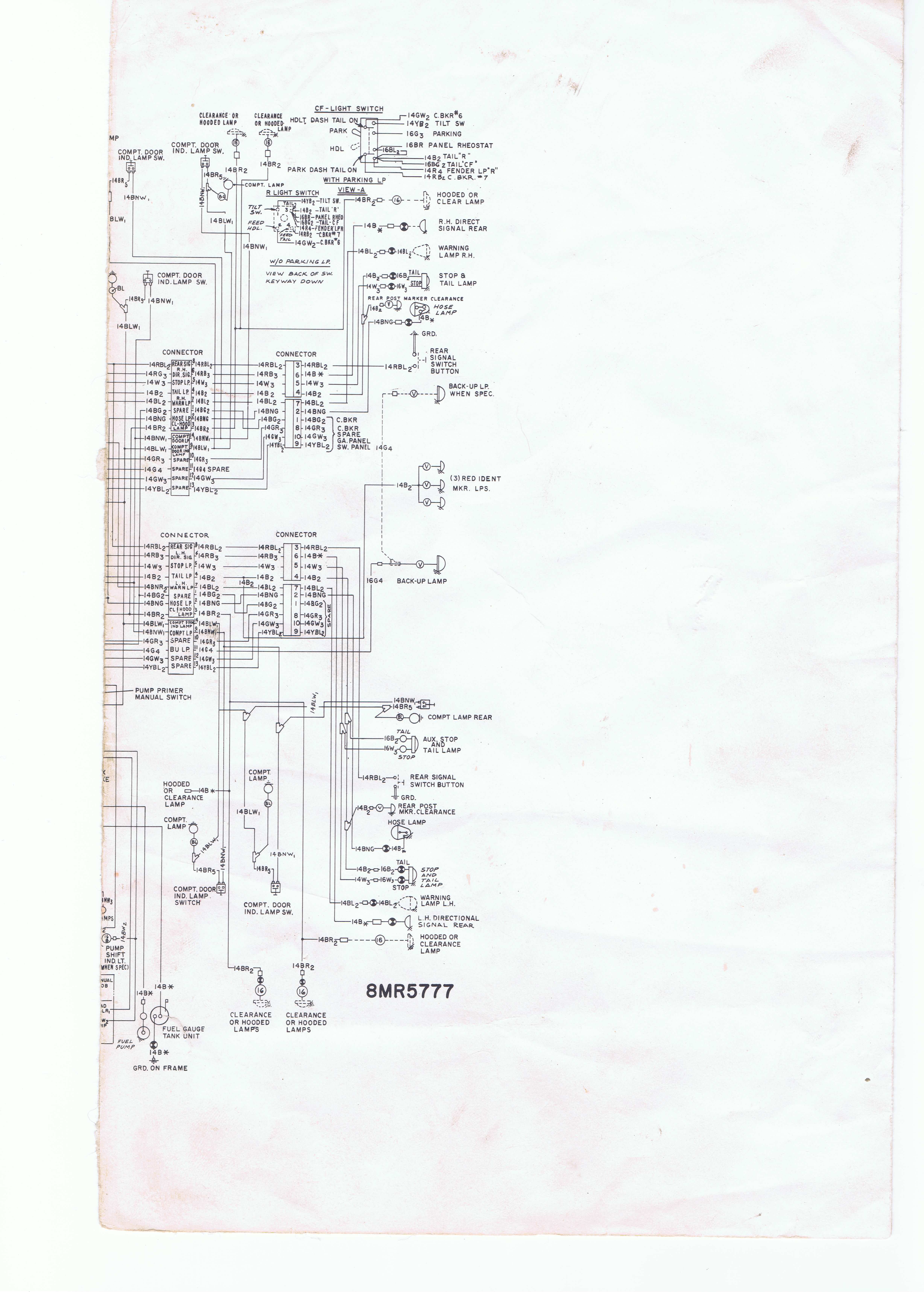

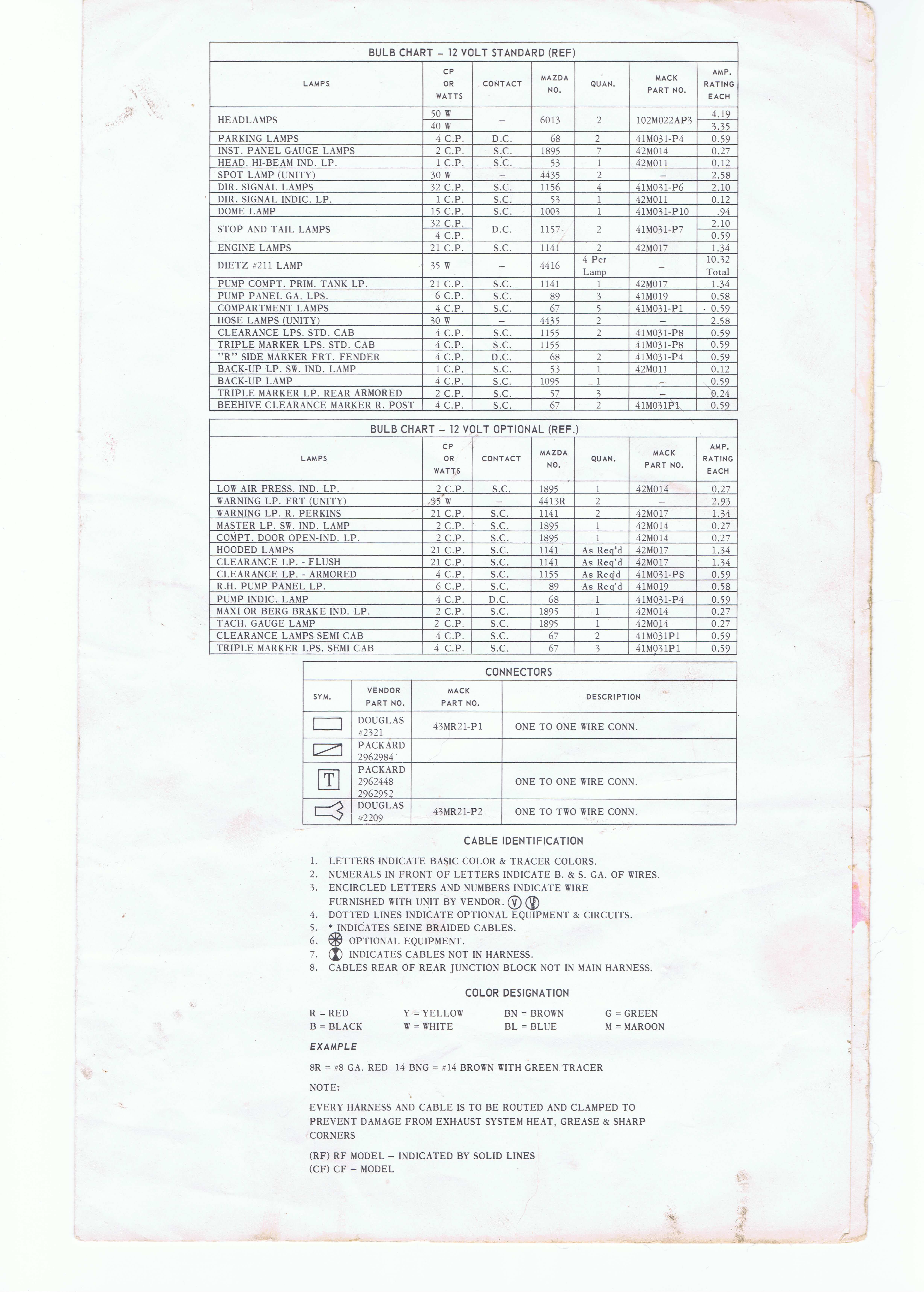

	I believe Mack switched from positive to negative ground in 1971 in fire trucks. (I had a 1970 CF that was delivered in December of 69 that was one of the last time come off the line as positive) I have also attached wiring diagrams from that truck from the original manual. Hopefully they help you out!
	  01010805szafram posted a gallery image in BMT Member's Gallery - Click here to view our member's albums! From the album: Wiring Diagrams
	  Wiring DiagramsImages added to a gallery album owned by szafram in BMT Member's Gallery - Click here to view our member's albums!
	  CCI03152010 00000szafram posted a gallery image in BMT Member's Gallery - Click here to view our member's albums! From the album: Wiring Diagrams
	  01010804szafram posted a gallery image in BMT Member's Gallery - Click here to view our member's albums! From the album: Wiring Diagrams
