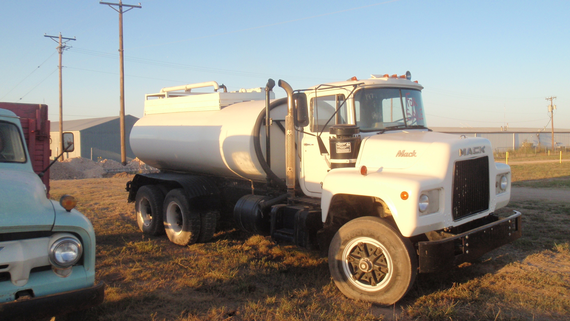

  3. I just bought my first Mack, a 77 DM686. Got it cheap, and it is an oil burner. I checked the dipstick, and it was dry. Added 2.5 gallons, and nothing. Fires right up, runs strong, and the last owner even drove it over for delivery. I know the engine probably holds more than a dozen gallons, so I might still be low. I would like to find the correct length of the dipstick should be, so I dont overfill. And, what are the specs for engine oil capacity? Last owner said this truck would burn 4 gallons in 8 hours, running the highway, working hard. I know gas engines fair, and blowby would pressurize the bottom end, etc. But, this truck seems to be strong still. As it warms up, it gets better, but never goes away. Is it just wore out? Engine Family 7. Model ENDT 676 Thanks for any help.
  4. Just bought a 1977 DM686, nothing special, but I needed a water truck. I want to thank Barry for the Posting Pic help post. I just need to know some basics about this truck, so I thought I would join. Looks like a great site. Thanks for putting it together.
