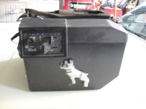

WANT TO BUY Wanted - Cover for Evan Tempcon Heater - Mack R series
kahall82 replied to kahall82's topic in Parts Wanted
Hi, It is an 1980 320 Coolpower. Any colour is fine. These are certainly hard to come by! -

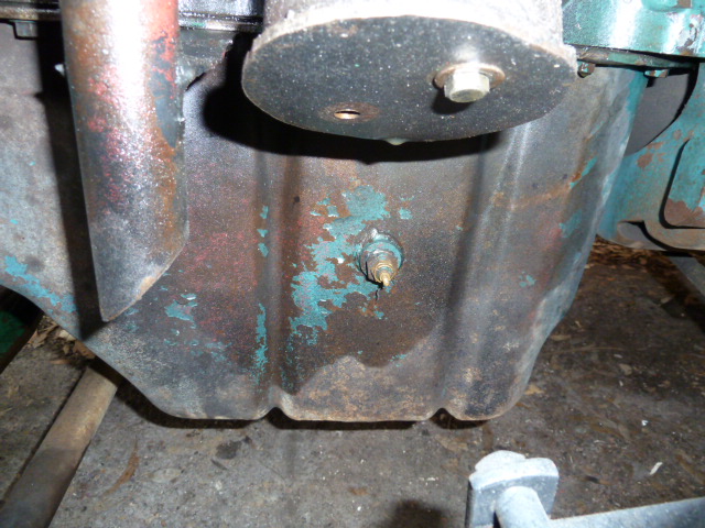

Hi all, My 1982 R688RST 350 Mack is running cold. About 55 degrees celcius (131 F) all day every day, unloaded or loaded. Same with Oil Temp. But the heater is fantastic. Have noticed that there is a coolant sensor on the top of the radiator and one on top of the engine in the water pipes near the heater taps. Maybe the gauge is hooked up the the coolant sensor in the radiator and not getting hot :S And the oil temp sender may be fouled I guess as we just found it in the sump and bought a gauge to hook it up to. Replaced the thermostat for a 170 just 3 months ago due to low temps. Should I be after a 180 thermostat or is there another problem? Causing a whole heap of wet stacking :S
