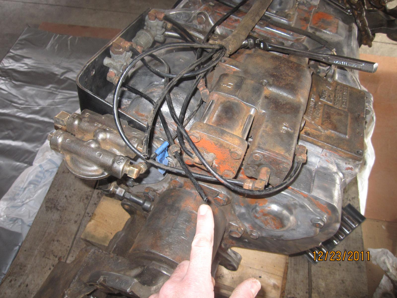

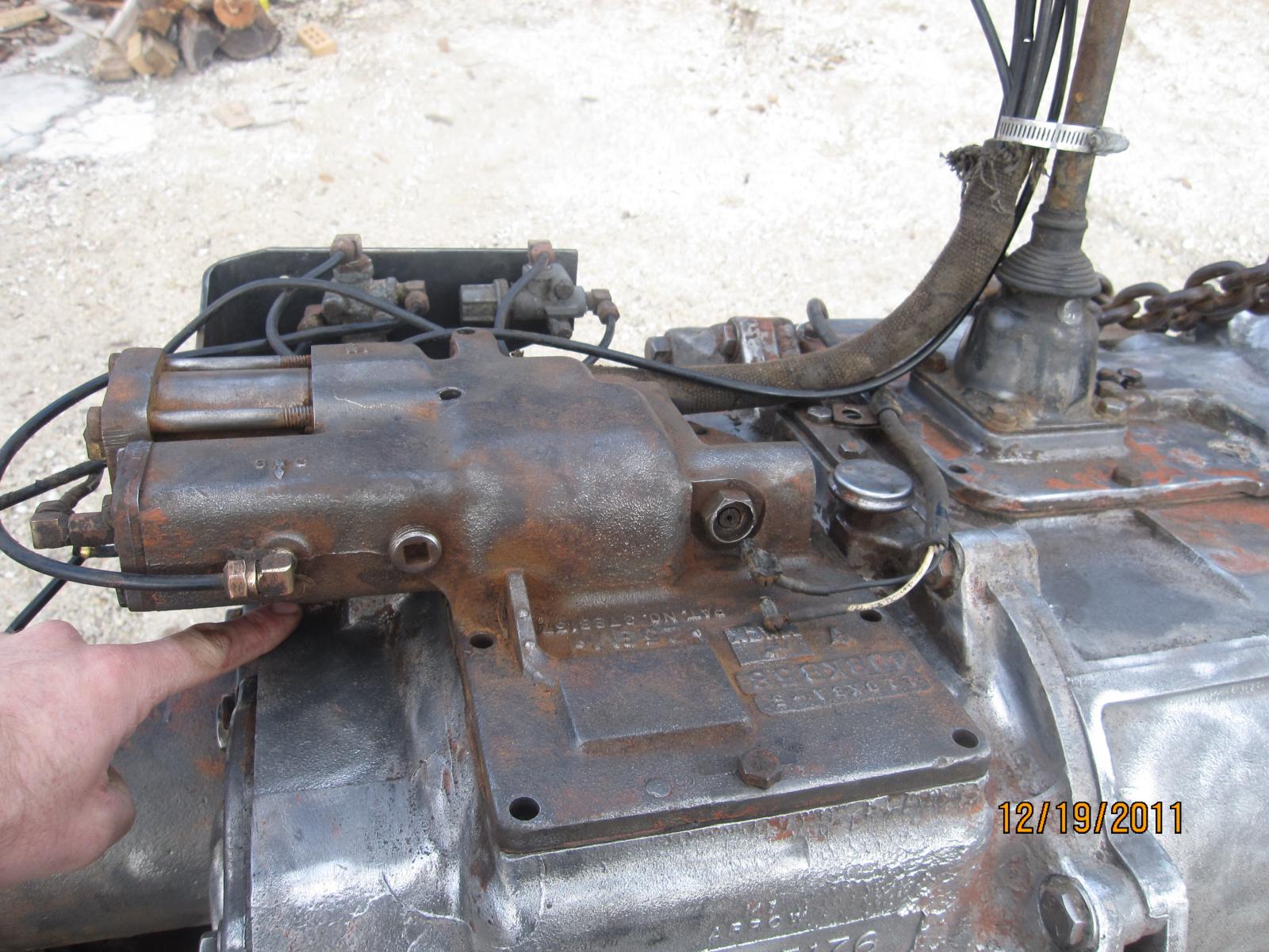

Rob,  thanks for the quick and helpful reply.  I ended up getting the transmission (X107)  I did like you said and removed the two top covers and inside looked very clean.  It still had a couple of inches of gear lube in the bottom.  Truck was said to have 500,000 miles on it but the inside of trans looked very good, no chipped teeth,  No shavings that I could find.  Don't know what to look for with the shift forks but as far as I could tell other than the outside being quite dirty the inside looked very clean and felt very smooth when turning spline. This trans has a longer rear piece that then hooks up to the drive shaft.  Also has a rear PTO ( with drive shaft) below on the rear.   I was thinking (hoping) that I could remove the rear extender piece from the back of trans and use the one from my current 1078 also was hoping to use my newer style right side PTO.  Without that rear longer piece the two trans measures the same from front to back so I would think drive shaft might not have to be modified.  There Is also Two broken wires on the top of trans a black and white one that the sending unit looks like it got damaged it looks like it was plugged into the top of the rear cover (by the air shifter area)  I am guessing they are to signal the backup lights.  I know this is a lot of info all at once, but  wanted to thank you for your help and see what you or anyone else thought.  Am a little nervous about doing the swap seeing how big this thing is in person and not knowing that once it is in I might have to take it back out.  Thanks again.	 -Jason
