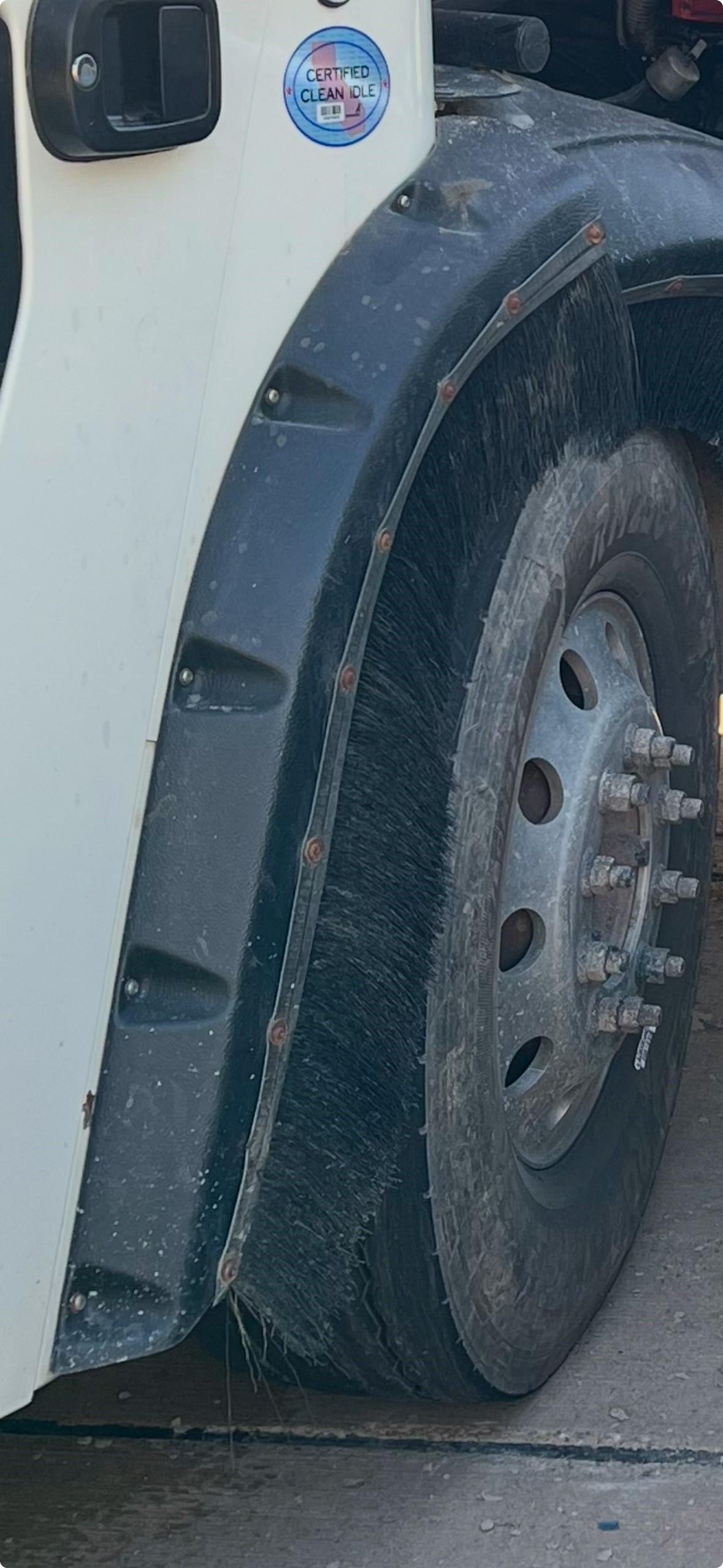

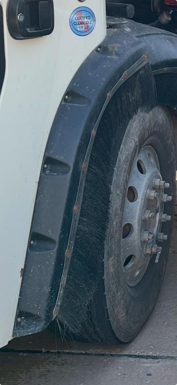

  2. I have a 2018 Mack LR64 the differental lock light comes on by itself and has now destroyed the rear rear end locker. Has any had this issue before? If so is it electrical or mechanical?
