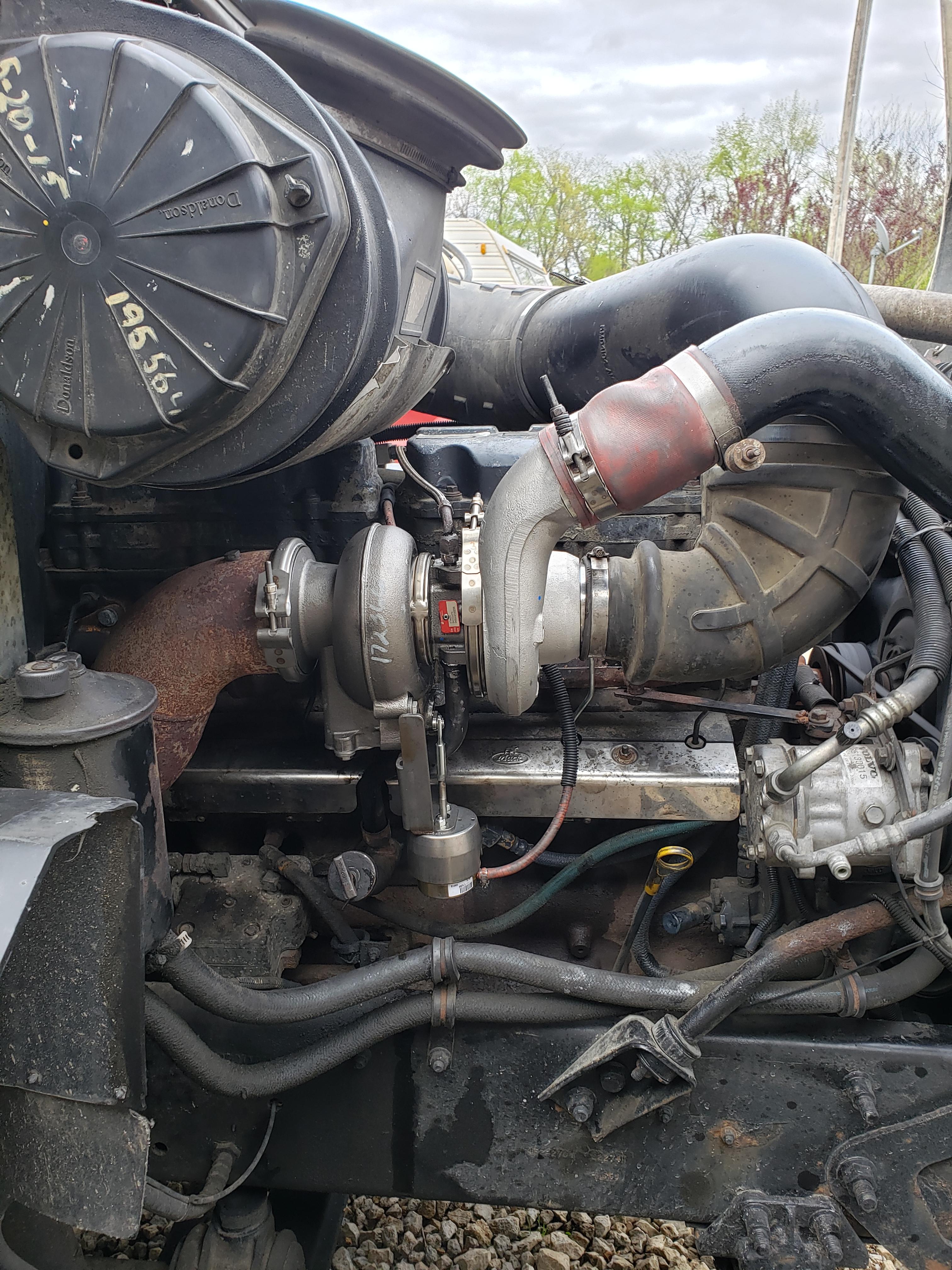

As far as I understand the Pressure from the manifold goes through the hose to the actuator which is basically the same principal as a mini brake can and the pushrod opens up the wastegate dumping excess boost. i guess the ECM verifies this by the Manifold Boost pressure gauge and comparing it with engine data if the boost is higher than the ECM likes it cuts the power to the engine to prevent damage, new turbo came with new actuator, already installed and the adjustment rod is spot welded from factory no leaks in the line from the manifold and the fitting and port on the manifold are clean with no obstruction boost gauge reads accurately just replaced the sensor, either the waste gate isn't opening enough or maybe its a computer issue? -

It's directly from the Intake manifold to the wastegate actuator. -

still the same, it derates as soon as it gets over 30 psi, my next attempt was going to see if maybe i can adjust and calibrate the wastegate out a little to compensate, I'm not too confidant in it as I've replaced the entire turbo assembly already trying to deal with this issue and I'm still having it. I've replaced the turbo, no air leaks, mechanically everything works, I replaced the sensor, if I can't calibrate the wastegate somehow the only thing left seems to be something wrong in the ECM and that brings on a whole new can of worms. it's supposed to be putting out 460hp but it feels like a prostar pulling down the road, its like trying to pull with a pickup. way too much time spent at WOT just trying to climb hills in Iowa and Illinois I don't know if its the engine just not putting out as much power as it should or if I need to upgrade it to a 13 speed from the 10 speed or a combination of both, but I Know that a Mack should perform better than this is currently -

replaced the sensor, and i was just told we're still getting the code. -

I appreciate your help, I just realized i gave the truck information and didn't say anything about the engine its an E7 460, to be honest I'm not sure about whether its an etech, ccrs or ASET, its just the simple mechanical turbo, not the Holset one that's on the newer MP8's if that helps, i was leaning towards maybe the boost sensor was off since i cant seem to find anything wrong elsewhere, also i wasn't able to pull up the service bulletin you posted -
been having this problem for quite some time now, I keep getting a 4-5 flash code and the engine seems to lose power (naturally right before the crest of a hill or right when you most need the boost) I replaced the turbo, so i know it's not a mechanical issue, and checked the airline going from the manifold to the wastegate and no apparent leaks and pushing air through the line actuates the wastegate. so at this point I'm not sure where else to go manifold pressure gauge reads boost pressure is it possible that the boost pressure sensor may be faulty reading a higher psi than is actually there?
