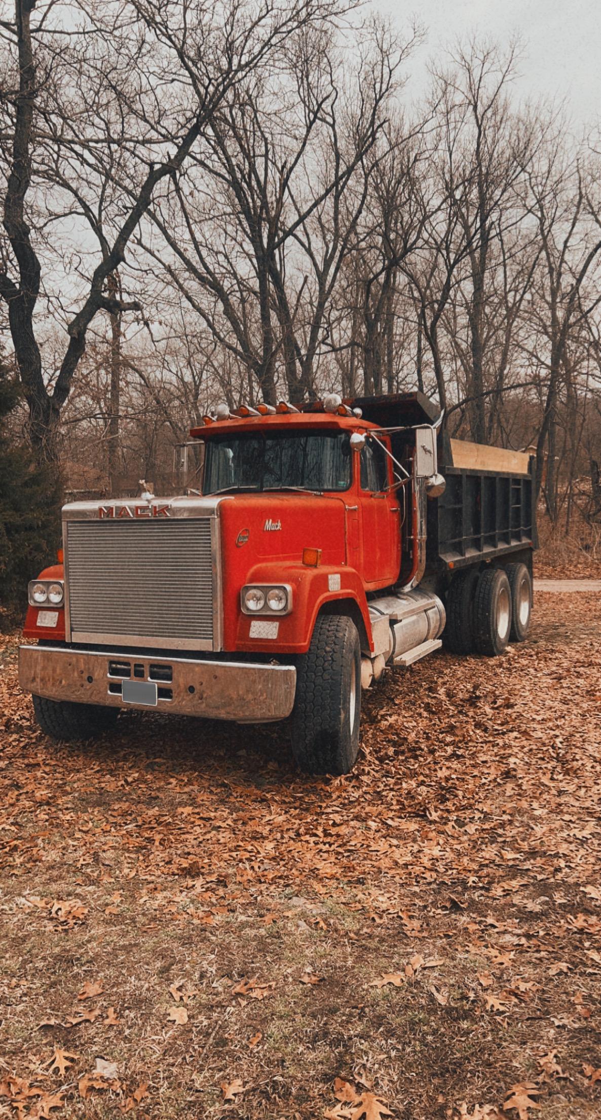

  2. I have a 2000 model CH613 with a E7 460 that is using 2-3 gallons of coolant a day. It doesn’t leak a drop and isn’t making oil. Looks like it is blowing straight steam out of the blow-by tube. Oil isn’t milky but if you pull the oil fill plug it has a greenish sludge and the valve cover has a green film. I’m thinking leaky liner but are there any other possibilities? Bad air compressor (tanks are dry) bad oil cooler? Bad head gasket (does not pressurize the coolant system or run hot) anything else to check?

  13. Yeah it’s the correct vin, vin on the truck matches the vin on the title. It’s a 1981 RW700L from what I’ve come up with, it’s a super liner truck with aluminum frame and top loader Rockwell axles and a Eaton 13speed. I believe it was built as a glider kit truck in the United States but I don’t have any real proof to back that up.
  14. Can someone help decode this VIN # ? 1M3U223K0BS001409 Every parts place I’ve talked to said this VIN doesn’t exist in their database. It’s making it really hard to find parts for it. I would appreciate any information I can get, thanks in advance!
