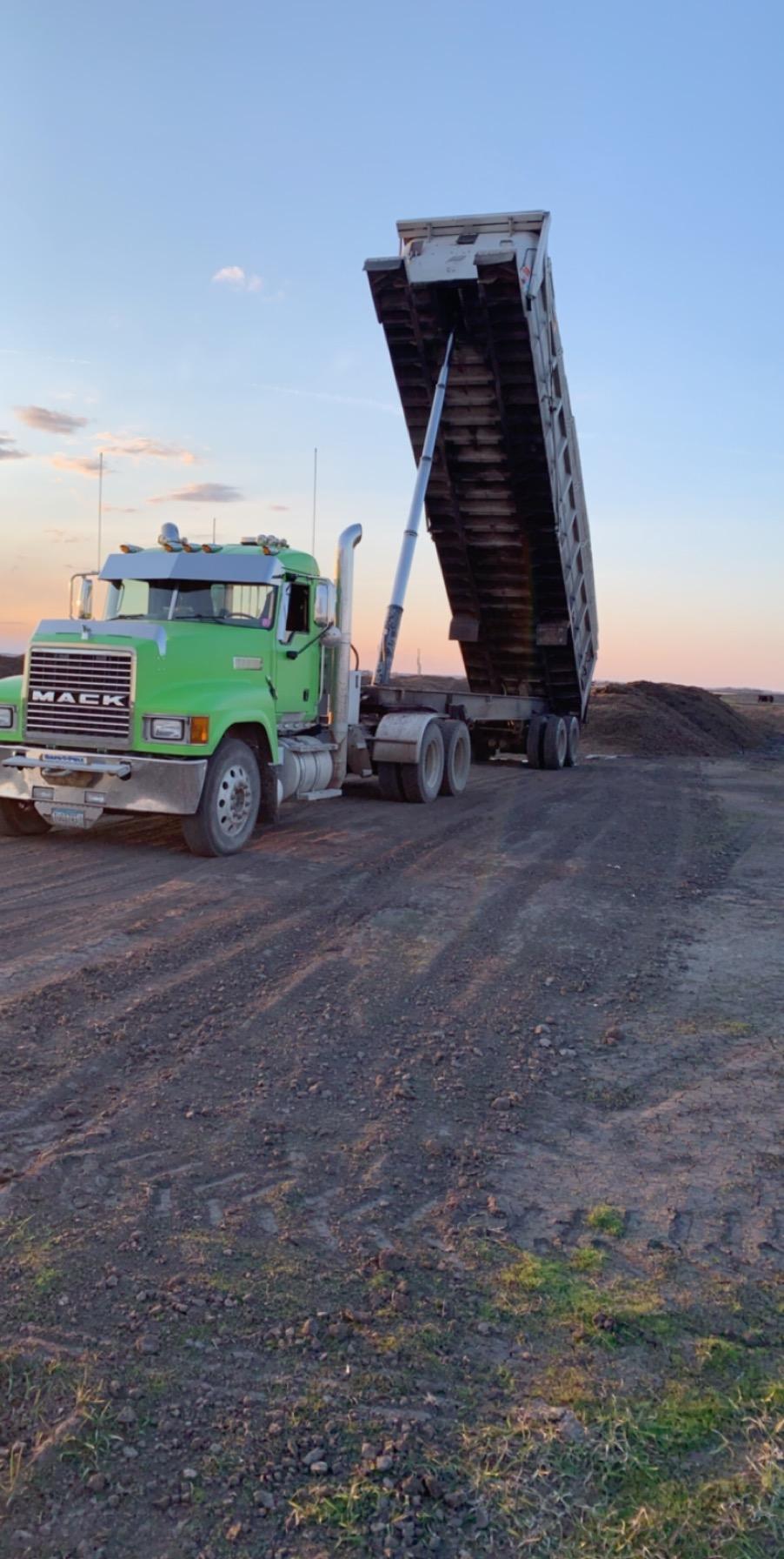

Everything posted by GreenGoblin06
  1. update: upon further investigation it was a bad connection at the sensor. one of the pins in the 3-pin harness had pushed out and it wasn't making a connection. thank you everyone for all of your help. ROLL ON!!!!
  2. its electric and this one has the sensor at the front left bag. doesn't matter if there's pressure to it, the gauge pegs out. ordered an new gauge and going to give it a try to see if that fixes it.
  3. it didnt matter if there was pressure or not.
  4. I have a 2008 chu613 and when the truck suspension airs up the "Air Suspension pressure" gauge in the dash reads 100psi. is this normal? thought it might act as a load pressure gauge but I'm assuming not. I've replaced the pressure sensor/switch on the front left air bag, and nothing changed. if it's just to read the air bag pressure and not for load pressure what are some good options and places to get one, i don't want anything cheap and chincy? thanks
