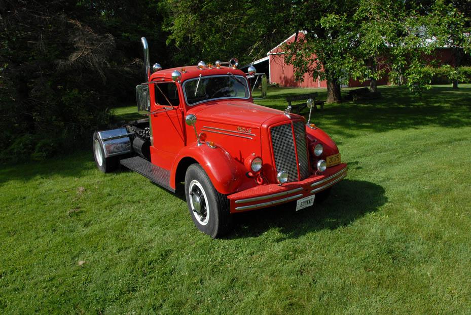

  3. Appreciate that! I have permission to share the serial number and it's 75S 2386. You know what the "S" is for? Also, it was reported to me the truck was built as a "tanker" with a mid mounted pump. What is a "tanker?" Lowell purchased it in about 1979 from a seller in PA with only 22K miles on it but it had been derelict for a long time. The presumption was that it served in some PA FD. The engine was seized solid. Lowell didn't get around to the resto-mod until about 1995. He shortened the wheelbase and added a modern axle, removed the rear body and tank. He installed the 4-71 in front of a 13-speed Road Ranger. Both Lowell and the current owner use(d) the truck regularly to haul trucks, engines and collectable tractor at combined weights of up to 40 tons.
  4. Doing a story on a Mack truck for Diesel World magazine. The owner told me it was a "1948 A75" but the serial number tags didn't back that upI have put that erroneous info to bed now thanks to a couple of helpful folks on the general discussion forum here. Now I know it's a 1948 75 fire truck that was been converted into a 5th wheel tractor. It also has a '77 Detroit 4-71 in it now. As you can see from the pic below it still looks like a Mack... and it's still fire truck red... but it's no longer as-built. I would like to honor the truck's origins by talking a little bit about the Model 75 and Mack's line of fire trucks. Can someone point me to an easily accessed source of info? The kind of stuff I'd be interested to know would be some basic technical specs for the '48 Model 75, some idea how many were built that year, what would be the most similar E-Model mach to compare it with, and how long Mack built fire appliances in-house. Also, was the '48 75 available with a diesel? I know most department back then didn't want diesels (cold starting is the impression I get) but I'd like to be able to say yea or nay on that. The guy that originally built the truck removed a seized flathead from it. He was the late Lowell Baker, by the way, a well known fixture in the 2-stroke Jimmy world, so the 4-71 was par for his course. If I gave you a serial number, could anyone verify the production year. I'll be talking to the owner again tonite ( 2/7/22) and will ask permission to share that number. Thanks in advance for any help you can offer. Jim
  5. Thanks, gents, for getting me on track. I had come to the conclusion that 75 was base on the E and now I see it actually could be a '48 model year truck. I will now start haunting Mack fire truck posts!
  6. Yeah, looks like the one I'm looking at is not a A-Series. I am beginning to see it's more an E-Series. The 75 fire engine was an offshoot of that, seems like.
  7. Need some help, guys. Doing a story on a Mack for Diesel World magazine. I'm trying to properly ID the truck and don't find any material on it. The owner only knows what he was told by the PO (the late Lowell Baker, who was a well known expert on the Jimmy 2-Strokes). I was told it's a "1948 Mack A75". The serial plate calls it a "Model 75" and the serial reads 75S-2XXX (full # not disclosed as I don't have permission from owner to reveal- I may be able to do that later). In looking here at the A-Series Registry, this truck has a similar look but the model number doesn't match. The A-Series info I can reference lists models A-20 thru 50. The serial plates in the registry all have the "A" in the model designation. I was told it was a converted from a fire truck and this may be the part that's throwing me off but I can't find a "Model 75" either. The engine has been swapped out and replace by a 4-71 (what other engine would Lowell put in ( : < ). I just want to accurately represent the truck as best I can but I am not an expert on Mack and what research I have done so far isn't turning up definitive answers. I have attached a pic of the truck as it exists today. Things I would like to know: -True ID? Model and year? -Related to A-Series? If so details on the variation? -If a special model, production dates and numbers if possible -Original basic specs, (dimensions, engine, trans etc.) Finally, I used to be (in the '90s and early 2000s) in contact with John Montville (on truck topics). Tried contacting him to no avail. Is he still around? He won't be a spring chicken. He was very helpful to me on a research project back then and this project has gotten me to thinking about him. We had some great talks about vintage trucks. Many thanks Jim
